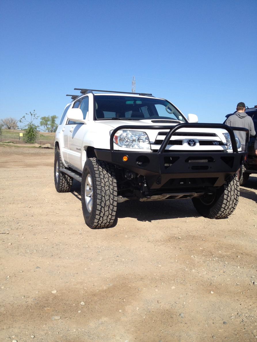

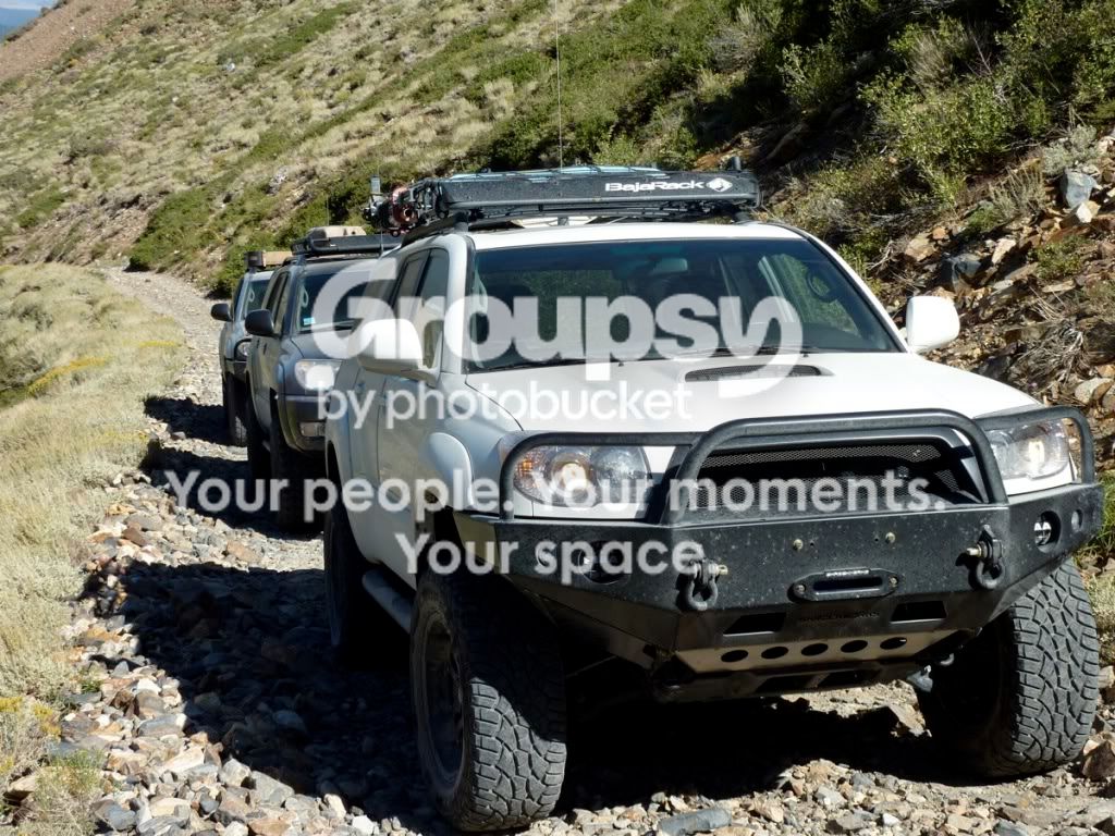

If you don't need it for tire clearance then go with the standard height brackets. The issue I ran into with standard height and no body lift was that I couldn't get enough clearance between the bumper and the body panels. The most I could get was around 1/4-3/8". You'll need a minimum of 1/2" clearance for body flex or you'll pop a fender flare. I installed a 1/2" body lift to put more space between the bumper and the body. No noticeable extra lean or creaking from the BL. I'm running Toyo Open Country MT 295/70/17's.
Standard height bumper, no BL.

Standard height bumper with 1/2" BL.
