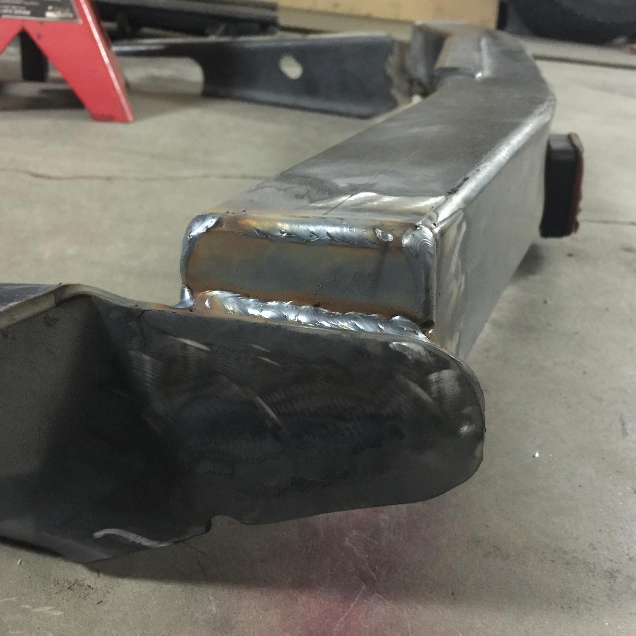

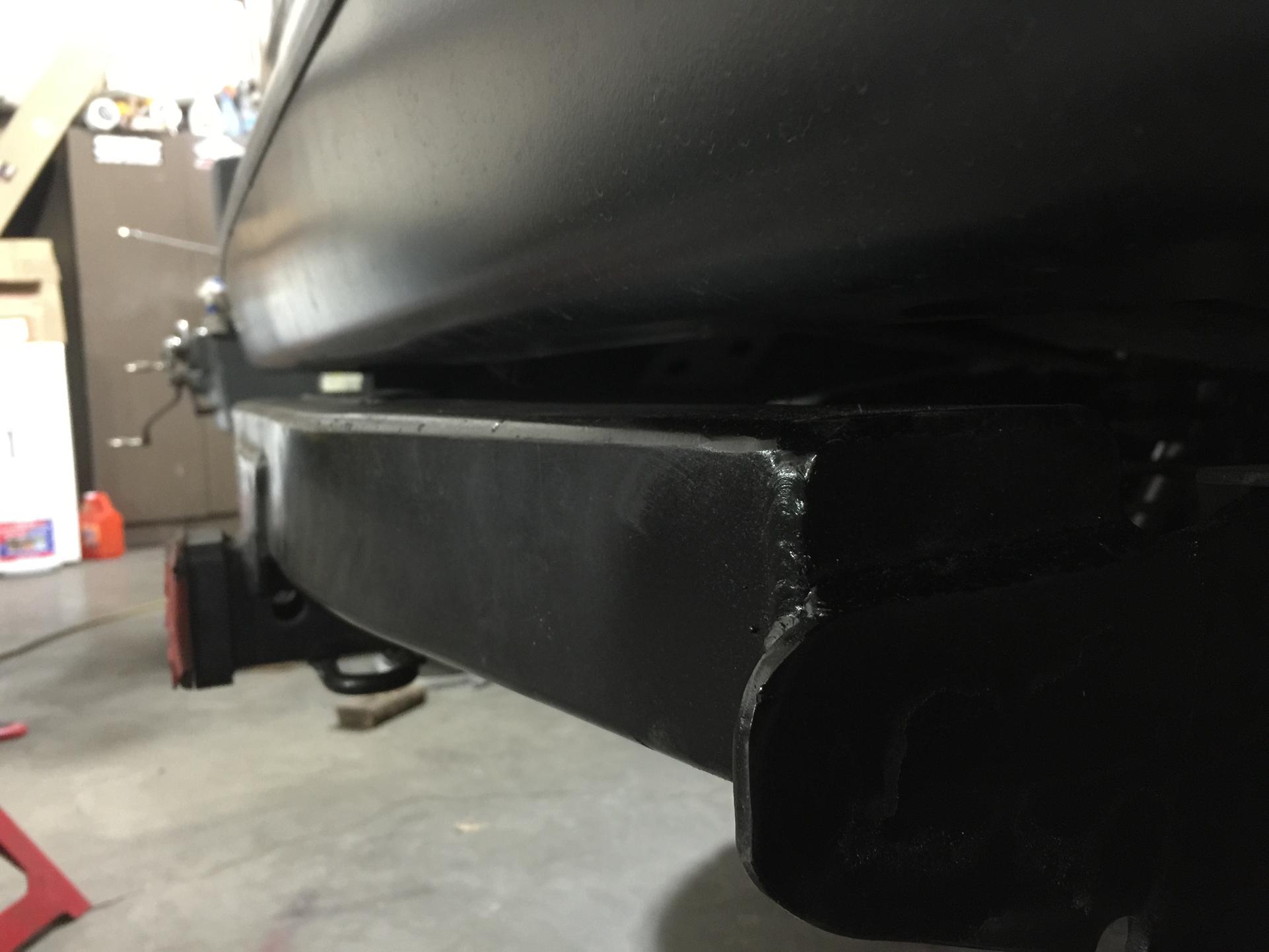

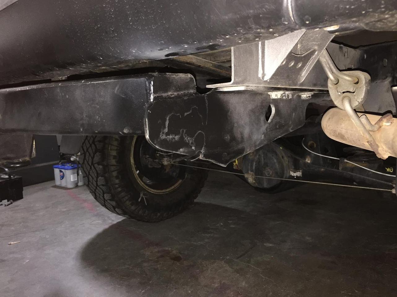

Do what I did on my thread (http://www.toyota-4runner.org/3rd-gen-t4rs/163299-infamousrnrs-2002-limited-bu-ld-thread-8.html)
I cut it & welded it 1.5” higher....
I don’t plan on towing anything... just a bike rack, but this resolved the gap that occurs after a body lift.
