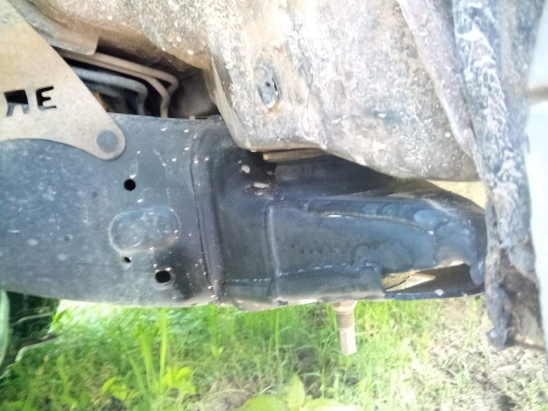

It took me about twenty minutes per side. Cost free. I don't know how much a shop would charge. Shops that install lifts usually are capable of this and well informed. I made a short video how I did it pro style.
登录 Facebook | Facebook
Here's the link. It's short and sweet and exactly what you need to know. I have two inch wheel spacers on 33s so I needed quite a bit of clearance. Attached photo of finished product.
