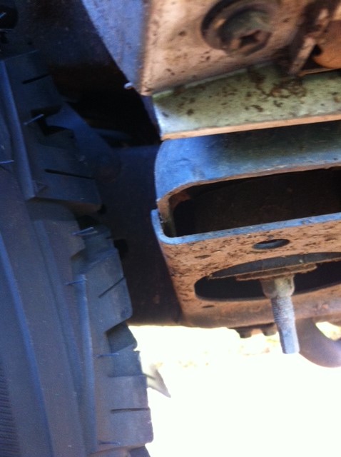

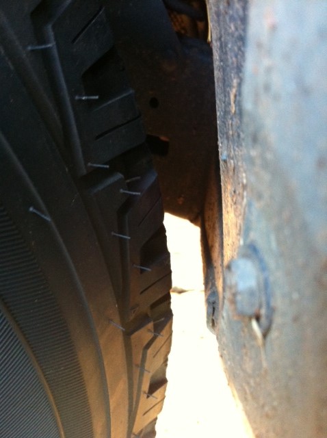

I have a Day Star 2.5 / 1.5 lift and I currently have stock 17 wheels (7.5 wide) and LT 255/75/17 tires (32.1 x 10 wide). I also have Spidertrax 1.25 spacers.
I am considering Method NV wheels and 285/70/17 tires. The wheels are 8.5 wide (0 offset) and, as you all know, the 285's are 11.5 wide.
I know that I'll have to chop the body mount if I install the new wheels and 285s (sans Spidertrax). My question is, if I keep the spacers on, pushing the wheels and tires out even further, will choping the body mount even be a solution? Or would this help my situation? From the pics below, I don't have too much room in general... Any advice would be great.
And yes, I used the search bar.. Thanks!

Yes, Yes and Yes.
I run 285-75 MT's and I did everything you mentioned, because you will rub lock-to-lock on the frame mounts. I actually did away with the spacers when I installed the my new rims - I opted for a 0 deg offset and 4.5" of backspacing and no longer needed the spacers.

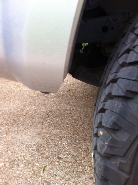

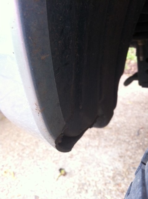

You'll also find the 285's rubbing on the front fenders, too. I cut roughly 3" off the front fender, 45'ed the bottom and moved the liner forward about 4". I re-used all the factory hardware and you would never know the fender was chopped and moved, unless you're really looking for the modification.
This is the finished product... I have almost 3" of space between the tire and the fender-lining. I have zero rubbing up front now!
The NV's have a 0 offset and 4.79 backspacing. Do you get the same aggressive stance with the bigger wheels but no spacers? I had to push the liner forward and trim the fender when I put on the 255's. What did you use to chop the mount, a dremel? Run into any problems? Thanks again!

Then you already have a head start on getting those 285's to fit (with the fender/lining mod). As far as the chop, I used a pneumatic grinder with a sweet little pack of metal grinding disks - these things could probably cut the entire truck in 1/2! I got 5/pack at a local Tractor Supply for like 15 bucks. I cut back as far I could, while leaving a 1/4" in front of actual mount - so I would still have a little room to weld on an end plate. I don't have any pics uploaded on the web (to post on here), but you can search the forum and find a numbers of nice shots from other members who performed the same mod.

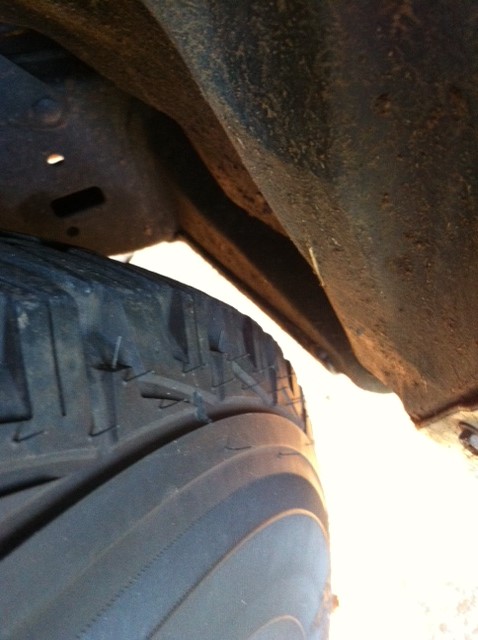

And I need to qualify my "no spacer" comment, too. I had the 1.5" All Pro spacers (pictured below), but I removed them when I installed my Pro Comp Series 52 Xtreme rims - the rims are 16" / 0 offset / 4.5" / 8" wide. A little of topic... but to accomodate the 16" rims I also had to install a 2009 FJ front brake kit (due to the Sport rotors and calipers being so large). And to get the rims to clear the shorter FJ calipers and rotors, I then installed some "generic" 1/4" wheel spacers to clear everything nicely. I also used some gorilla glue to securely adhere them to the hub assemblies and painted everything all black... :thumb:! The PA laws are really strict on spacers and you would never know I even had spacers at a glance! I can always pry them off, if needed. Sorry for rambling-on about the rim and brake information, but I always get hit-up with some questions when I mention a 16" rim on a 4th gen. And, yes, the offset and backspacing I chose still provides me with a nice aggressive stance - the 1/4" spacer only pushed out the sidewall a little past my fenders and my tread is perfectly flush with the fender. It looks proper now!

You may be okay without any spacers - or a very small one like mine - since you're running a nearly identical offset/backspacing on the NV's and you don't have any clearance issues with brakes cause you're running a factory size rim. I'm not an expert on the subject by any means, but I went through 3 sets of various rims before I got it down to a science. I bought the first 2 sets used and finally learned a nice little lesson on doing my math homework first, and then I bought the Pro Comps new from Summit Racing. Luckily I sold the first 2 sets on Craigslist for the same monies, so it was just a bunch of wasted time learning that I was an idiot for not researching the entire project. That's my closing argument to you.. research the entire project before you pull the trigger, you know - like you're doing in this thread!
This is the best side shot I have access to showing the stance with the 1/4" spacers. I can live with it...
