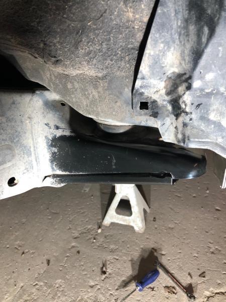

I went over this in my head like it was a huge ordeal. Forgot we used to chop up our drift cars in worse ways.

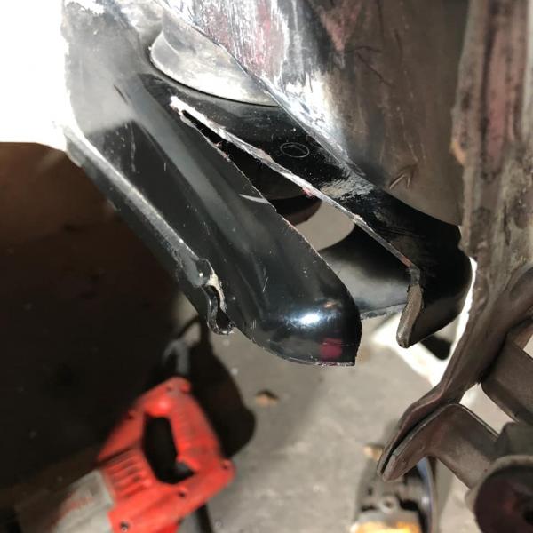

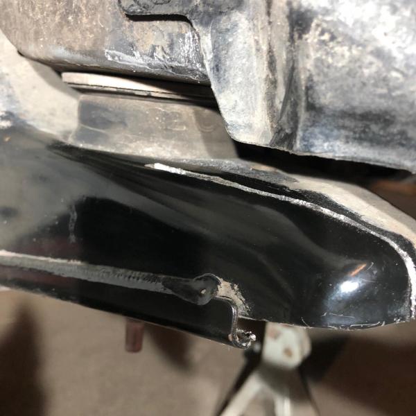

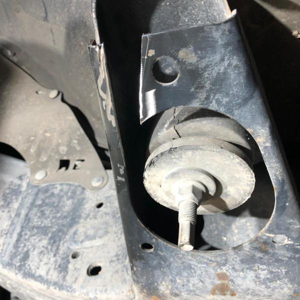

Anyway I know its been covered in every way but I ran across a post and vid that I liked better than simply hacking off the mount and welding in a plate or not plate if you're into that.
Basically pie cuts a piece out and hammers it back. Feel like this is a much cleaner look. So here's my attempt and I'm fine with it.

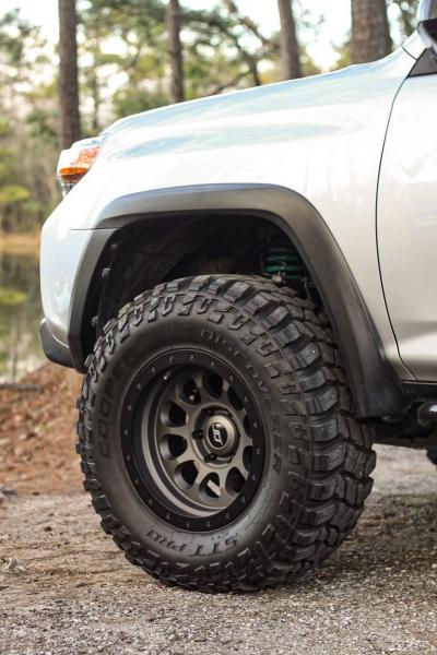

Great for 285's and even clears my 295's
Of course thats the chop I really want. I was going to ask if you're on 35s then I looked at your sig :laugh:

thats how my shop did my BMC's but welds the cut after hammering it back. Looks clean and looks stock and I didn't have to buy a filler plate.... win / win for me.
