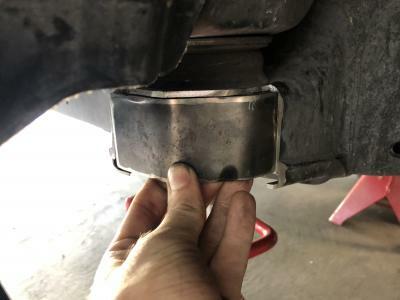

Is there much of a difference between the flat plate body mount plates and the curved ones as far as clearance goes? I see plenty of both and am not sure which is best.
I had been wondering the same thing. I just yesterday ordered the rounded plates from SRQ Fabrication. After watching a few videos and looking at pictures all over, it appears that the rounded style encourages more trimming than the flat or even bent plates do.
It is probably actually more than is really needed to be cut, but from the looks, the curved plates appear to have a clean look when complete.
