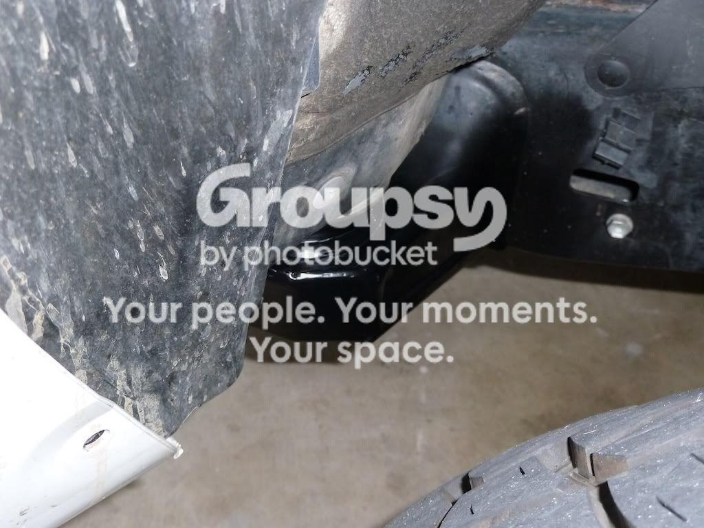

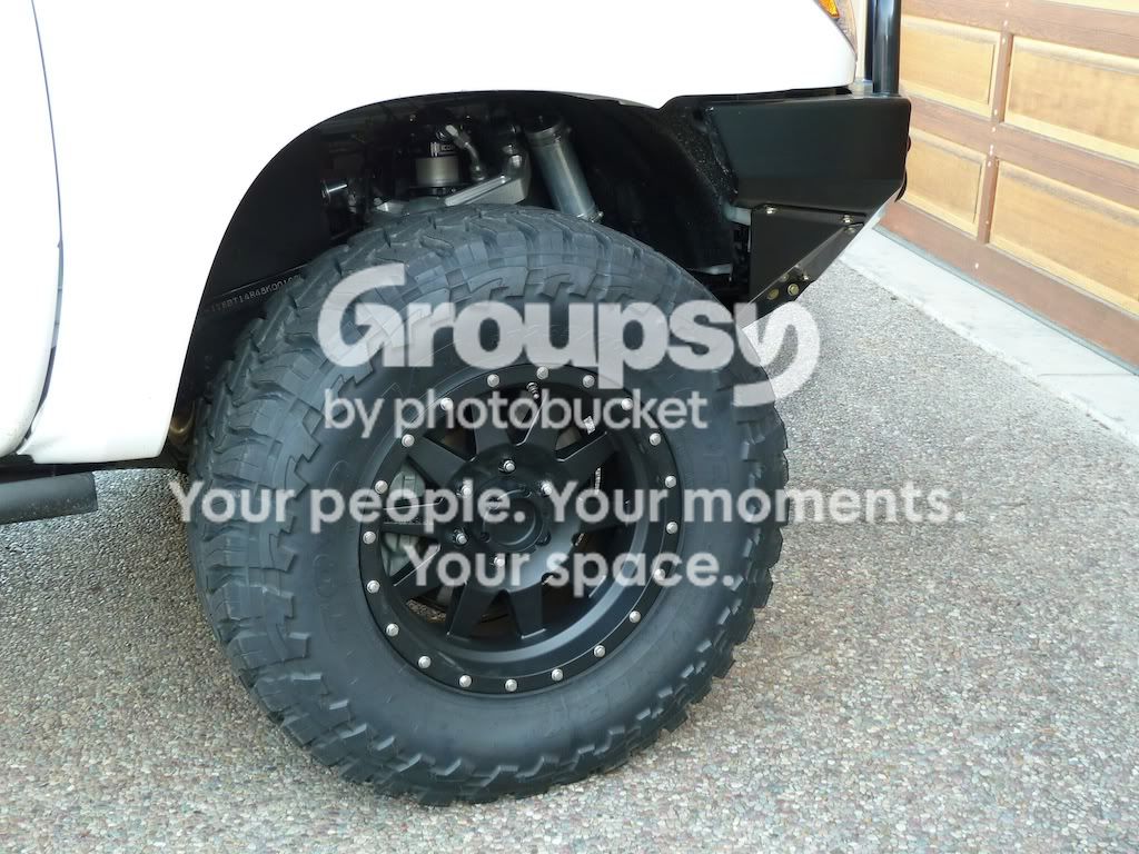

I'm running Toyo Open Country M/T's, 295/70/17 on Method Wheels, 17x8.5, 4.75 BS, 0 offset. Yes, you'll have to chop the body mount, ditch the mud flaps and either cut or move the front fender liner. BTW, that's a great deal on those tires! :thumb:
