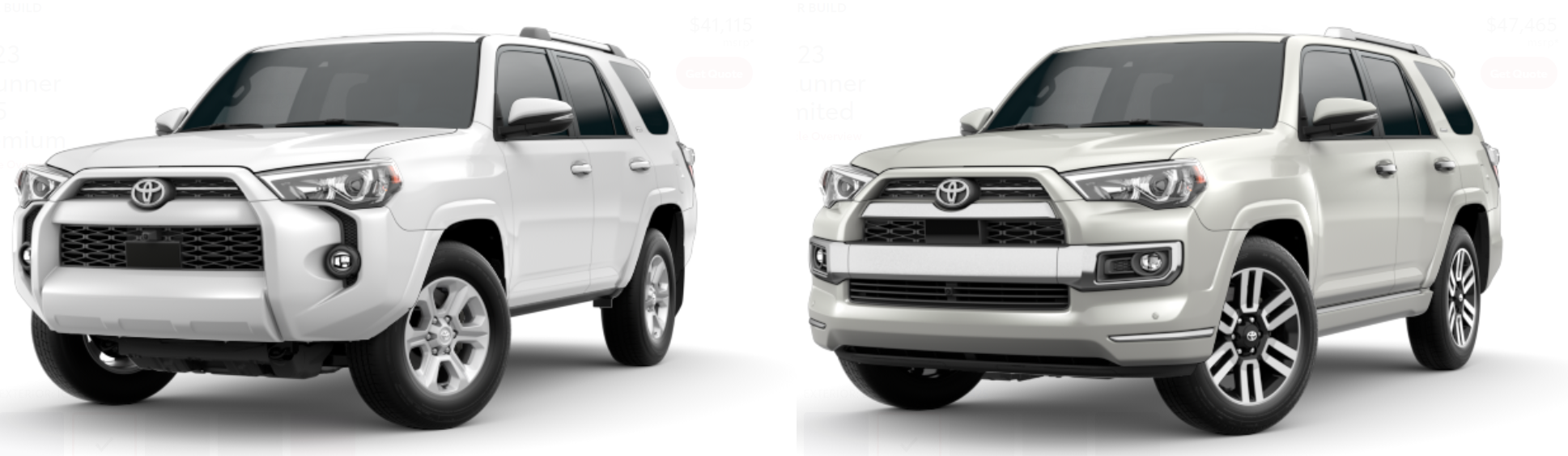

Does anyone know if the body panels (front fascia, rockers, rear bumper) create more or less drag between SR5 versus the Limited/Sport styles? The latter hangs a bit lower. Disregard mudflaps.
Also, are different running boards used for the Limited/Sport trims due to the lower rocker panels?

The taller front fascia of the limited/Sports styles probably does have more drag, but there are many more factors that come into play.
It has more area of Stagnant air. With that said, there are other things such as undertray covers, and even wheels shapes that make changes to aerodynamics.
Though the overall shape, weight, engine is already so... unaerodynamic that a front fascia difference will not make a substantial difference. Not to mention that Toyota probably already tested and modified their design that the difference in front fascia would not make a significant difference.

I don't believe there is much difference in underbody clearance, so even if the Sr5 "looks cleaner" as an aerodynamic profile, all of the dark stuff underneath is also creating drag.
But as you point out, it's chasing very small numbers here to determine a difference. Tire width and load bars on top also make some difference, probably more so than body style.
Yea I have no idea if there is much of a difference to underbody clearance, but the actual underbody coverage does change the drag coefficient drastically. If you look at the underbody of a Prius, its all pretty much covered up. Our 4runners got a whole bunch of bits hanging about without coverage...
With that said. I agree with all the other stuff.. not to mention uh.. it's probably moot to figure out the difference between the two tall riding bricks.

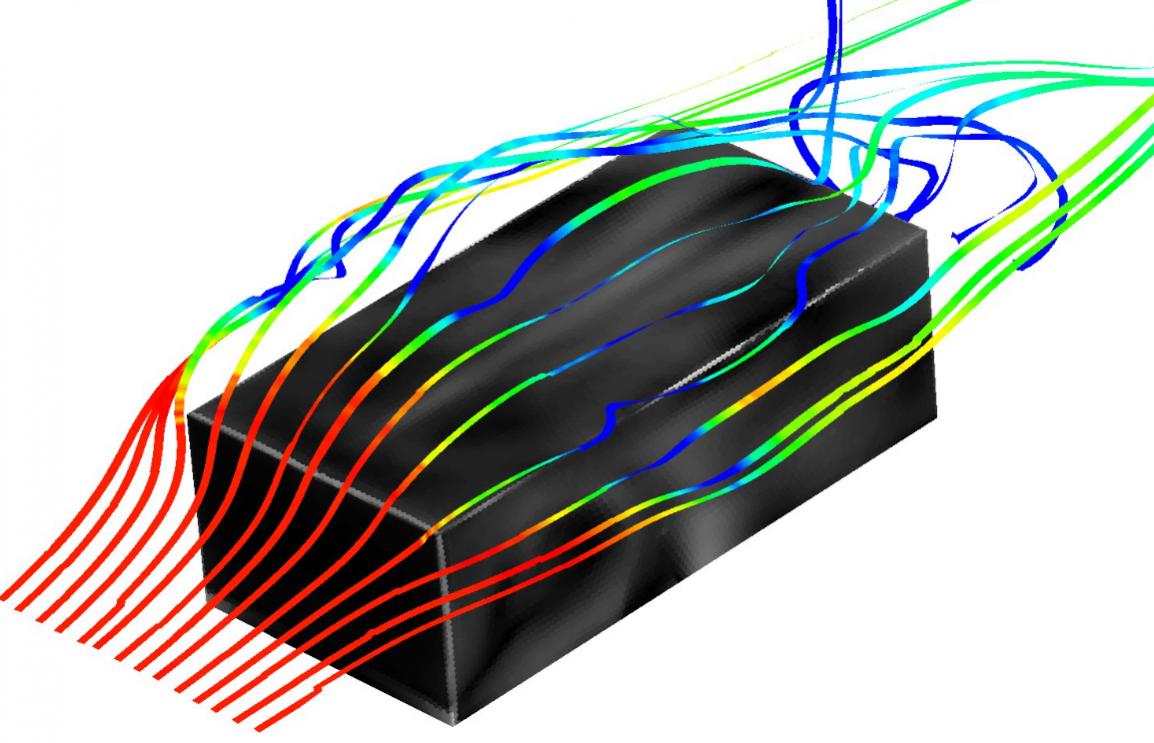

The overwhelming majority of drag on vehicles comes from frontal area. The aerodynamic differences between the SR5 and the Limited will be insignificant.

I doubt there is much difference, but I would say the Limited is probably better. There is a reason that the less off road oriented Tacos (and most pickups) have a front air dam. Having something smooth for air to interface with is better than the irregular surface of the skid plate and whatever else is down there. Having a rock interface with that smooth bumper is not ideal which is why the off roadish models trade aerodynamics in favor of approach angle.
