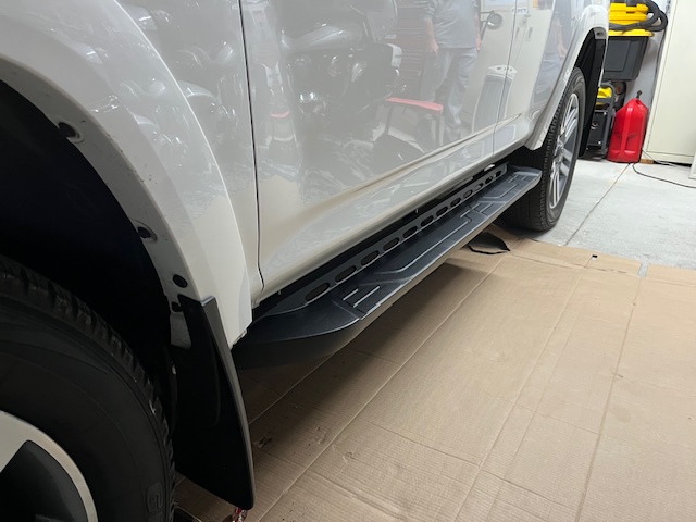

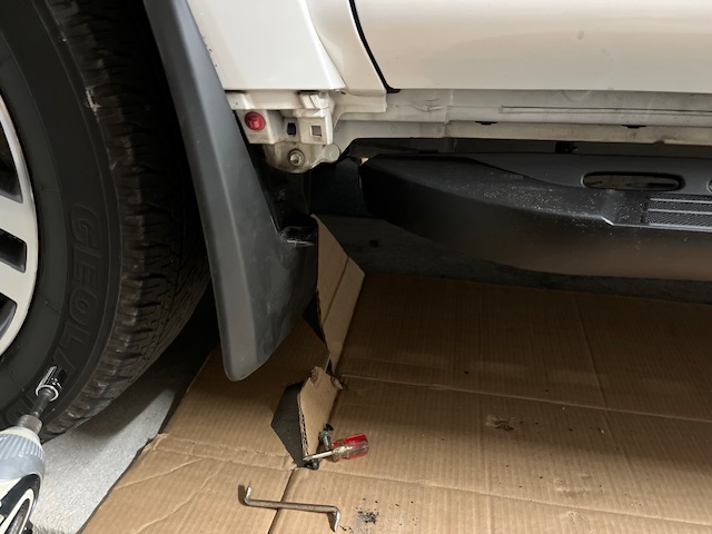

So the deal is, I removed the side skirt on my TRD Sport as it is bolted on using the same holes as a running board would use. I bought the running boards to make it a bit easier for my wife to get into the cab.
Does anyone know the part number, or is there a lower piece that will replace/cover what is obviously a naked looking area between the bottom of the rocker panels and the boards?
I've since reinstalled the side skirt until I can find a better solution. I've tried the toyota site searching body panels, etc, to no avail.
Thanks in advance.

yes - there is a piece. it looks like you have the limited/style trim on the sides with the long side skirts. you should be able to swap the limited trim side skirts for the SR5 / TRD etc. side skirts that sit much higher. I have a 2012 and did the exact same thing because I wanted to remove my mud flaps and have higher clearance on the sides.
you will need a series of parts though. for me these were the parts I needed (I ordered a couple extra parts here and there for clips etc) but again I have a 2012 so check parts catalogues for your model year. youtube and this forum also have some threads on it:
molding retainer x 16 76924-13020
molding grommet x 2 90189A0002
molding front right x 1 75857-35010 (I had to do a slight dremel on the inside of the molding to make it fit perfectly. not noticeable from the outside. I think this relates only to the early 5th gens though)
molding front left x 1 75858-35010 (I had to do a slight dremel on the inside of the molding to make it fit perfectly. not noticeable from the outside. I think this relates only to the early 5th gens though)
molding right x 1 75805-35130
molding left x 1 75806-35100
other parts I noted in my log but did not end up buying:
molding grommet 90189-06006
molding fastener left 75395-04010
molding fastener right 75395-04010 (same number as above)
I did this mod a couple years ago. really like it. one comment is that the rear fender flare will not line up perfectly smooth with the rocker trim. it's a non issue for most people unless you are quite particular. no one has ever commented that it does not look like it was meant to be that way from factory. unfortunately you will have to remove the running boards to put the new rocker panels in though
