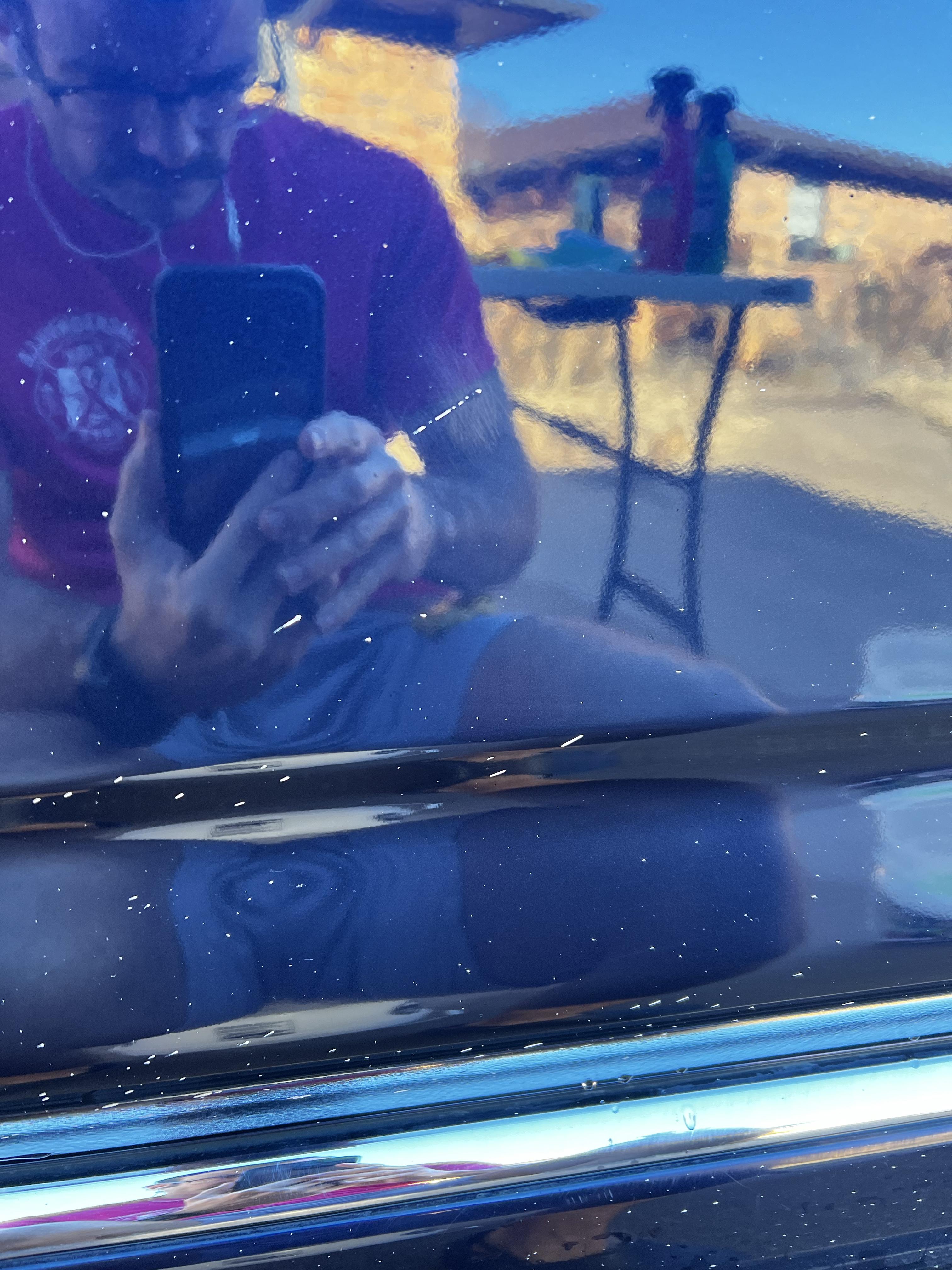

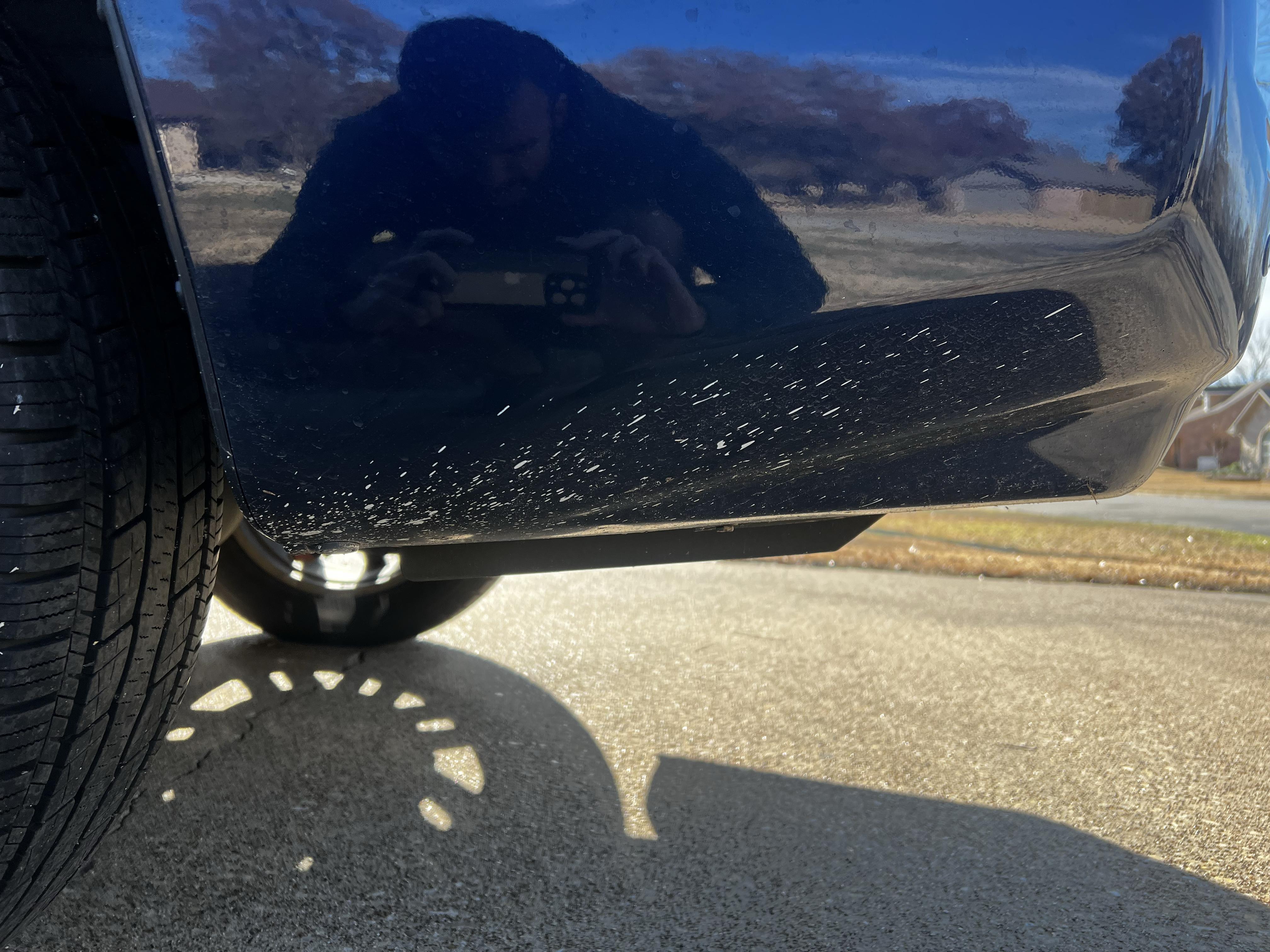

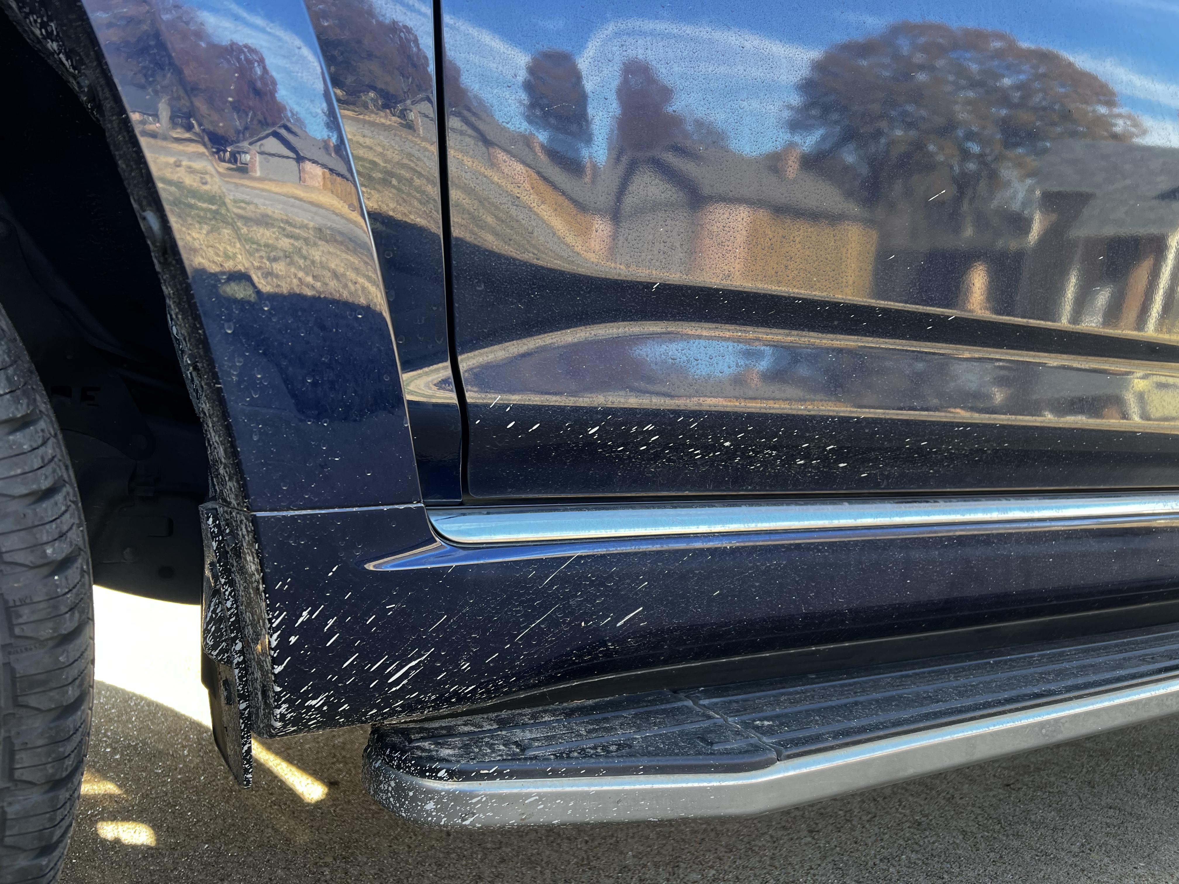

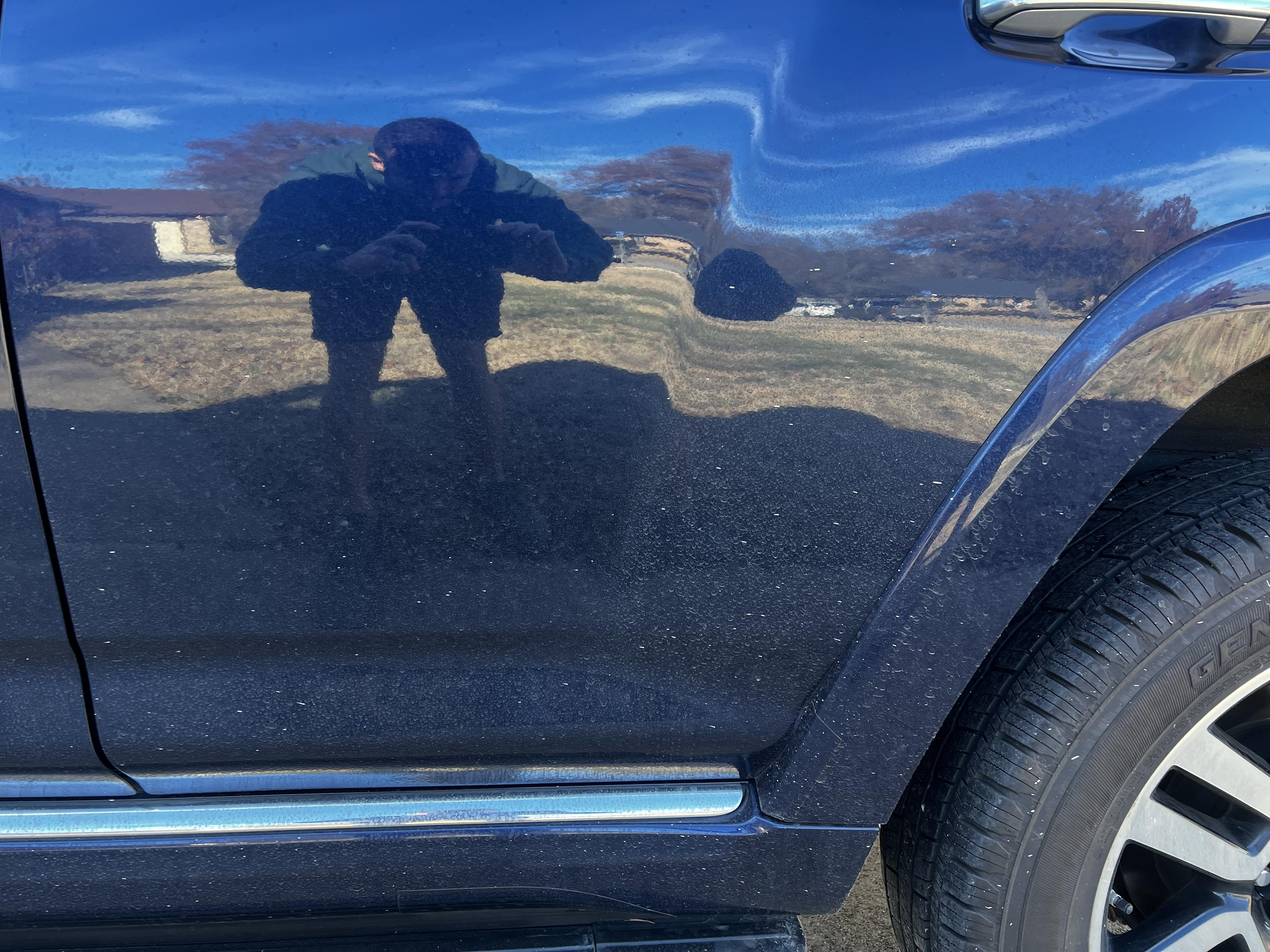

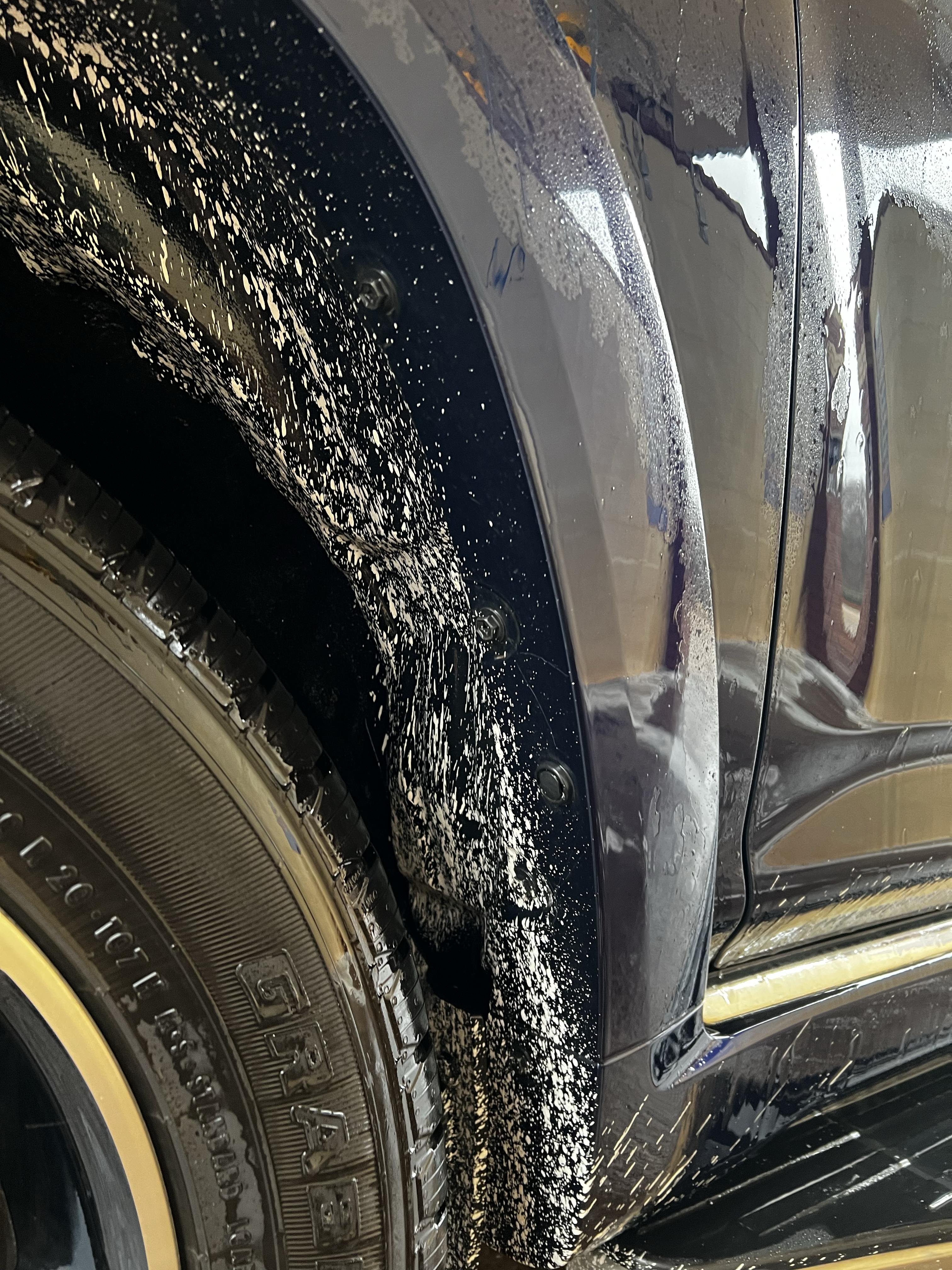

My wife ran through some white household paint on the road in her new-to-us 2017 Limited.
It’s all over the fender liners, on the paint, and wheels and rear tire. I can use my fingernail and it will come off with a little elbow grease.
I’m looking for some insight from some paint and body experts. Is this a body shop repair or could an auto detail shop handle something like this? I’m fixing to start grabbing quotes and wasn’t sure where to begin. Thanks for any help!!

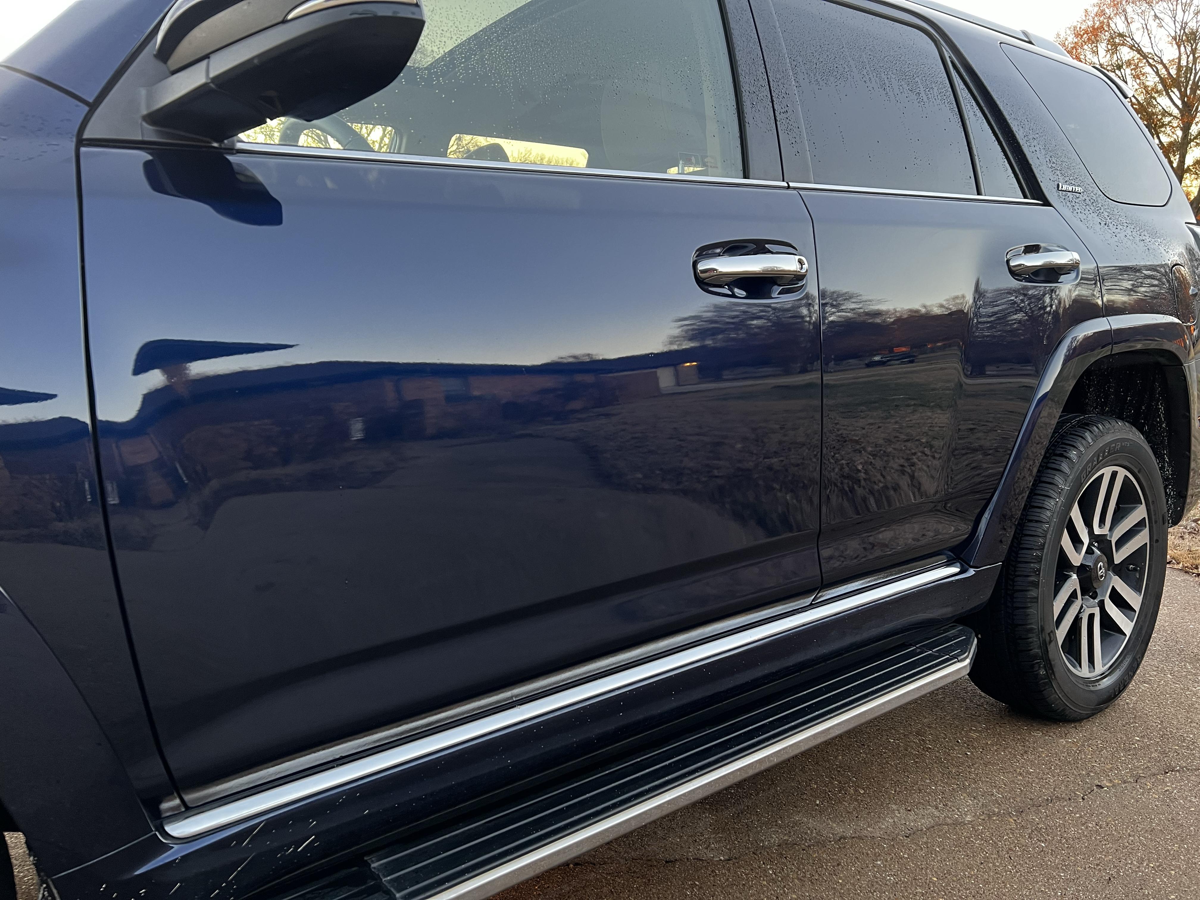

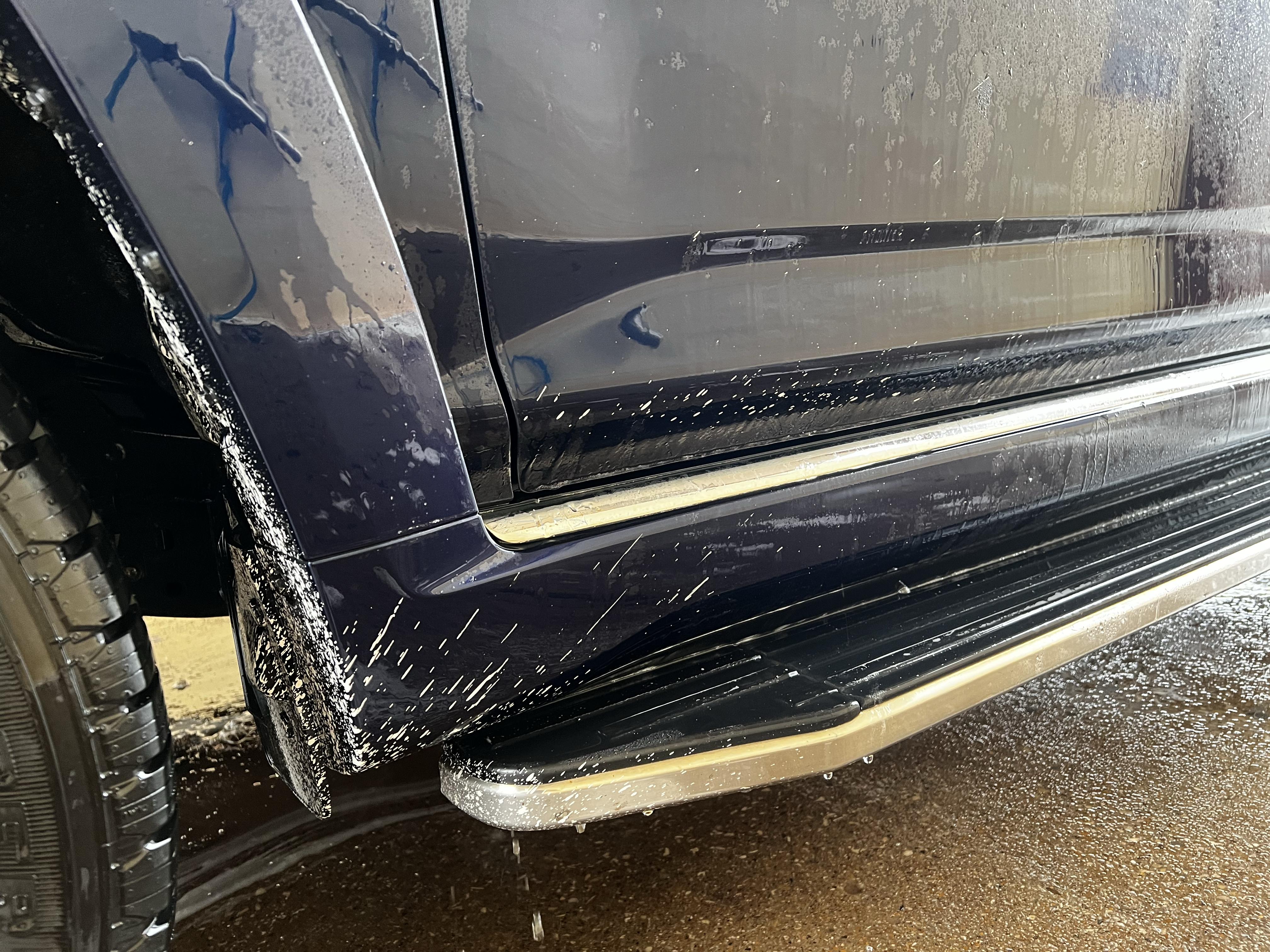

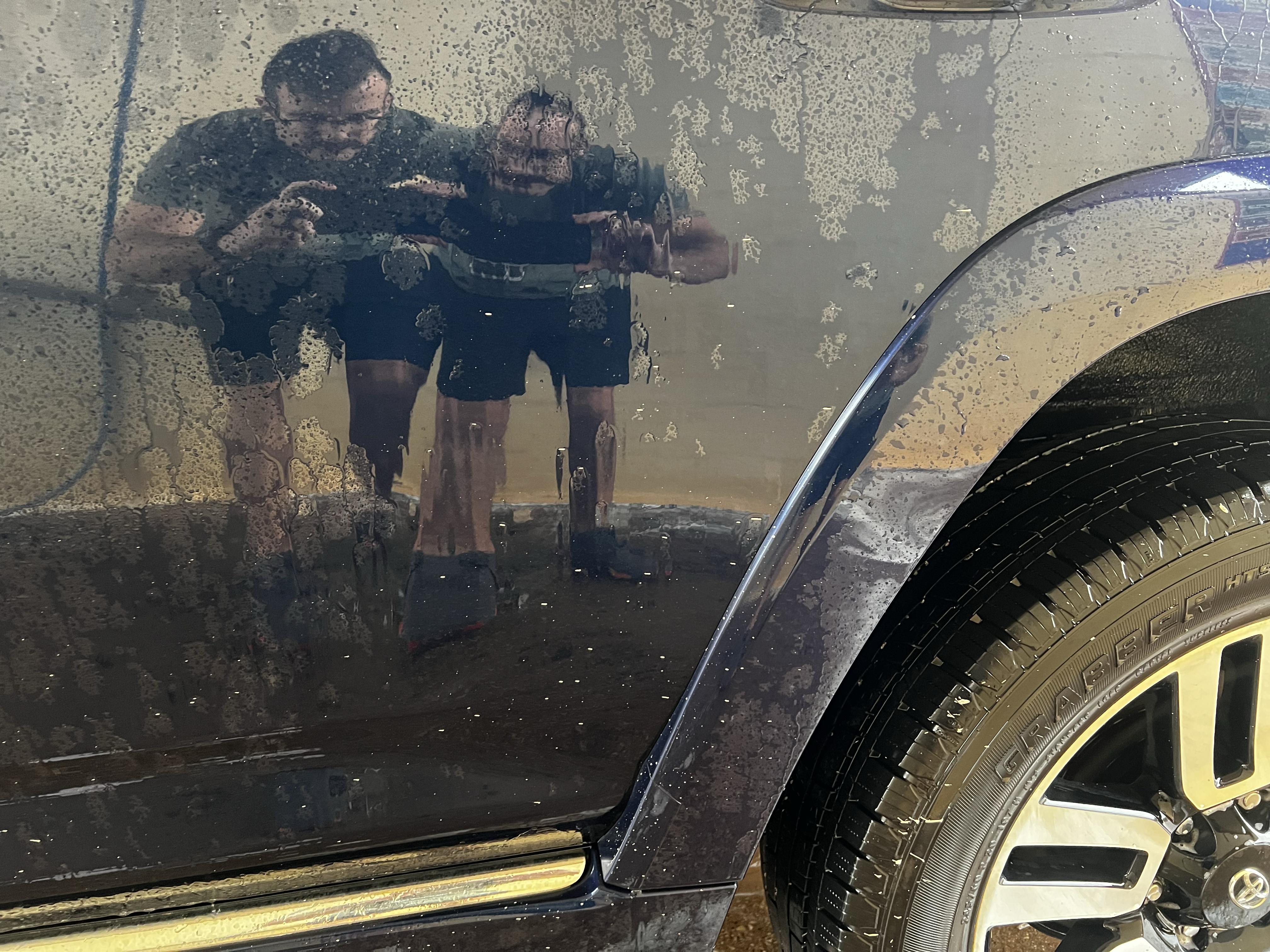

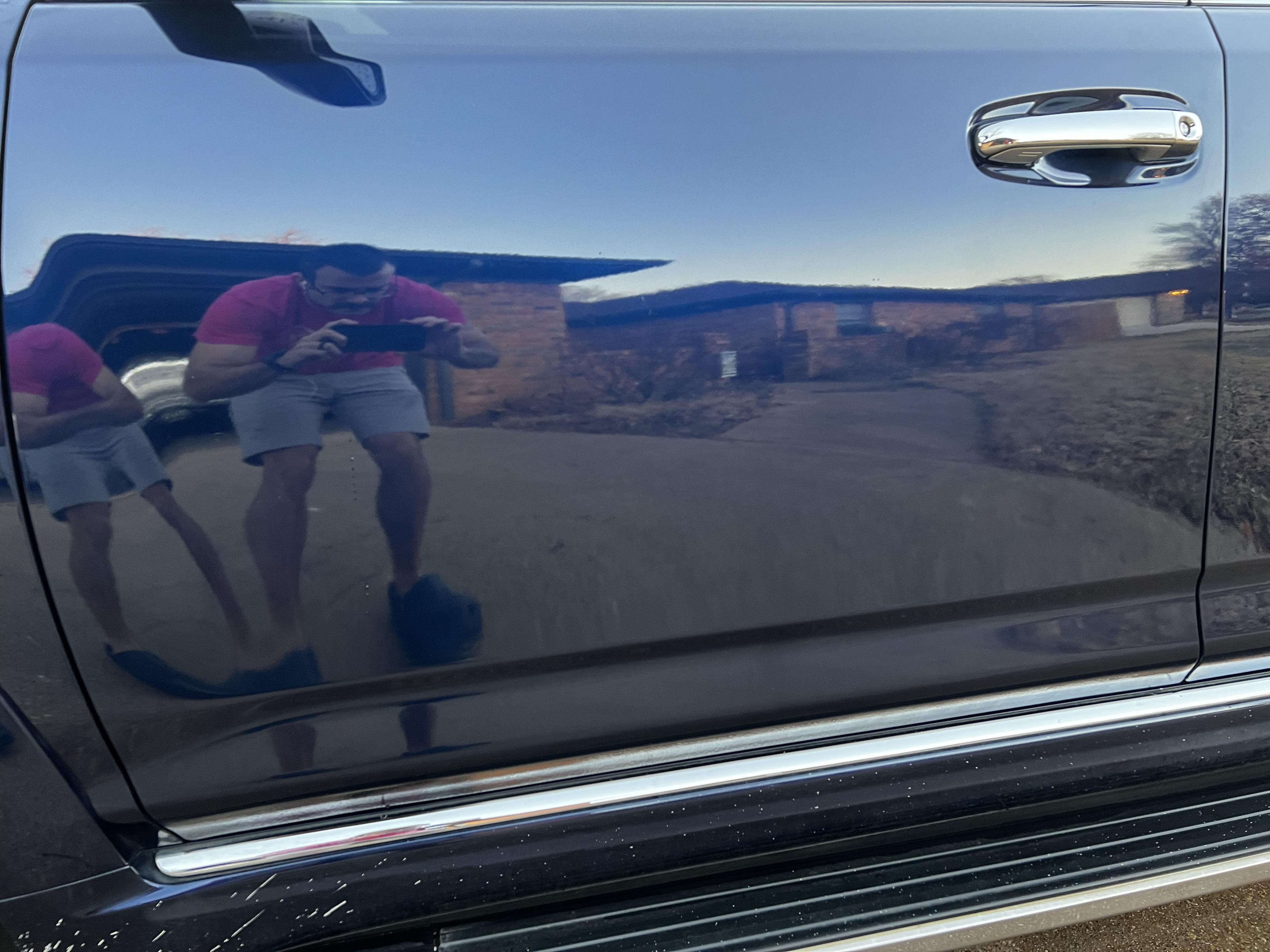

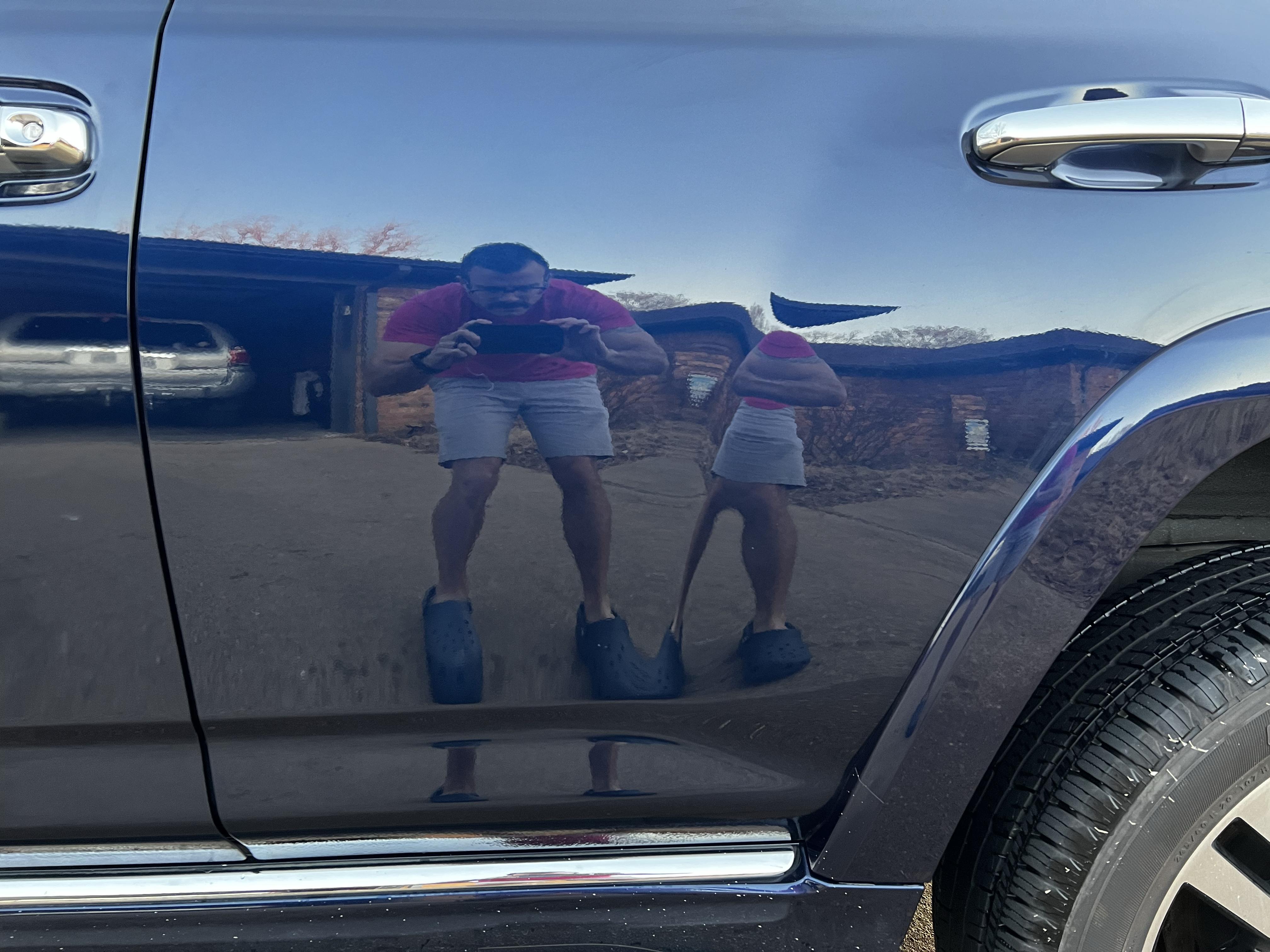

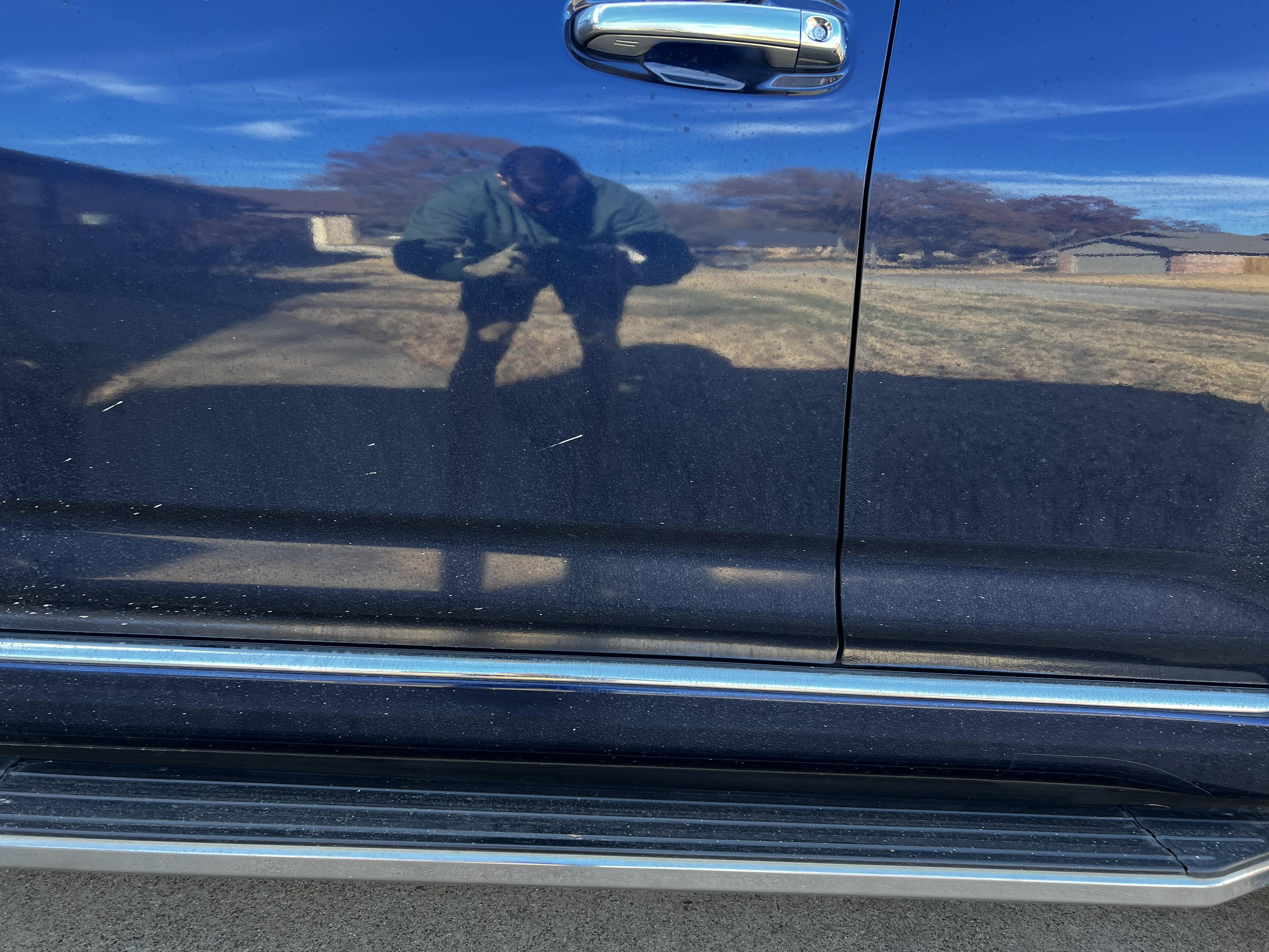

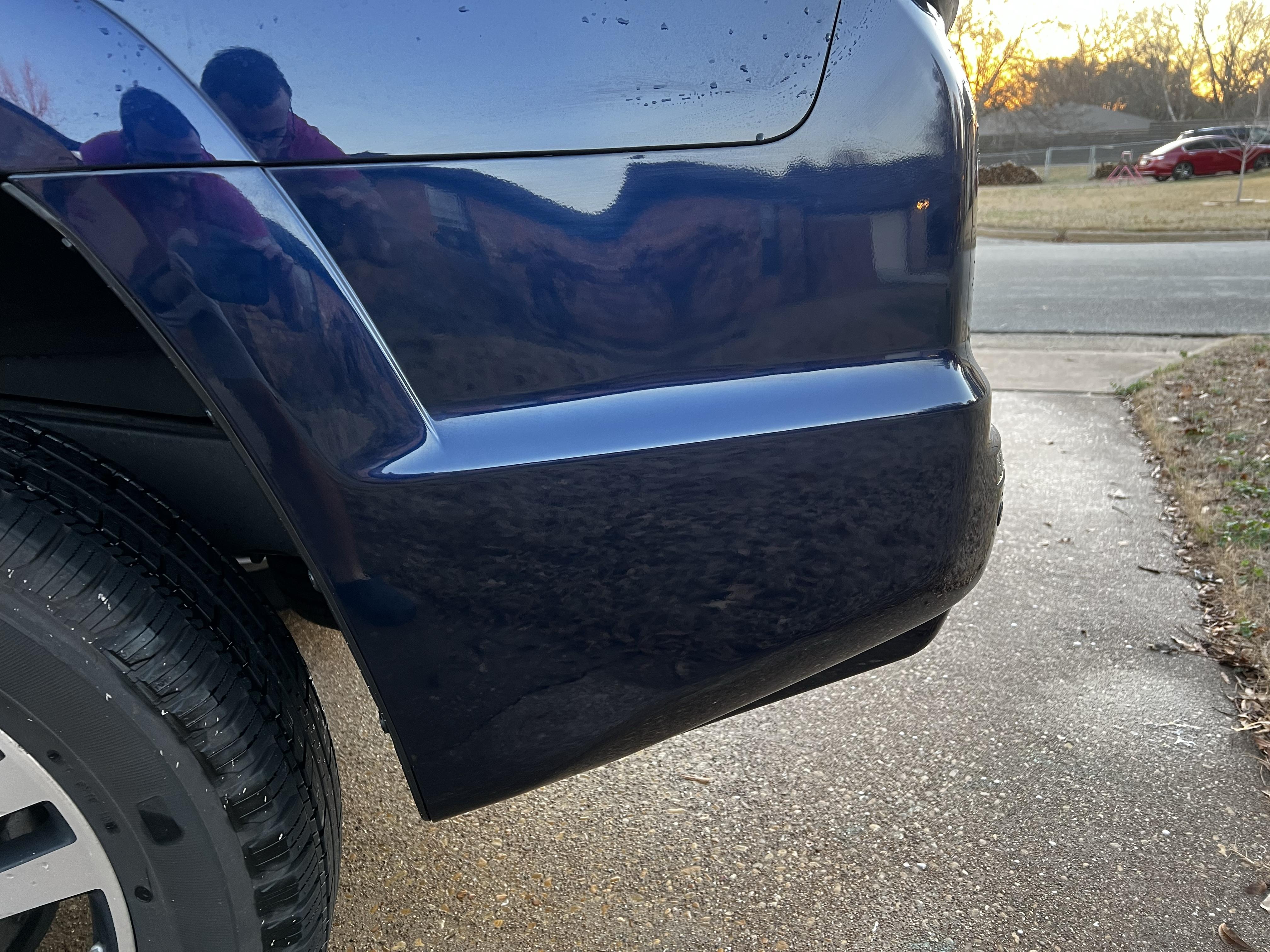

DIY was the way to go. Clay bar kit, bug and tar remover, two coats of Wax and some serious elbow grease.

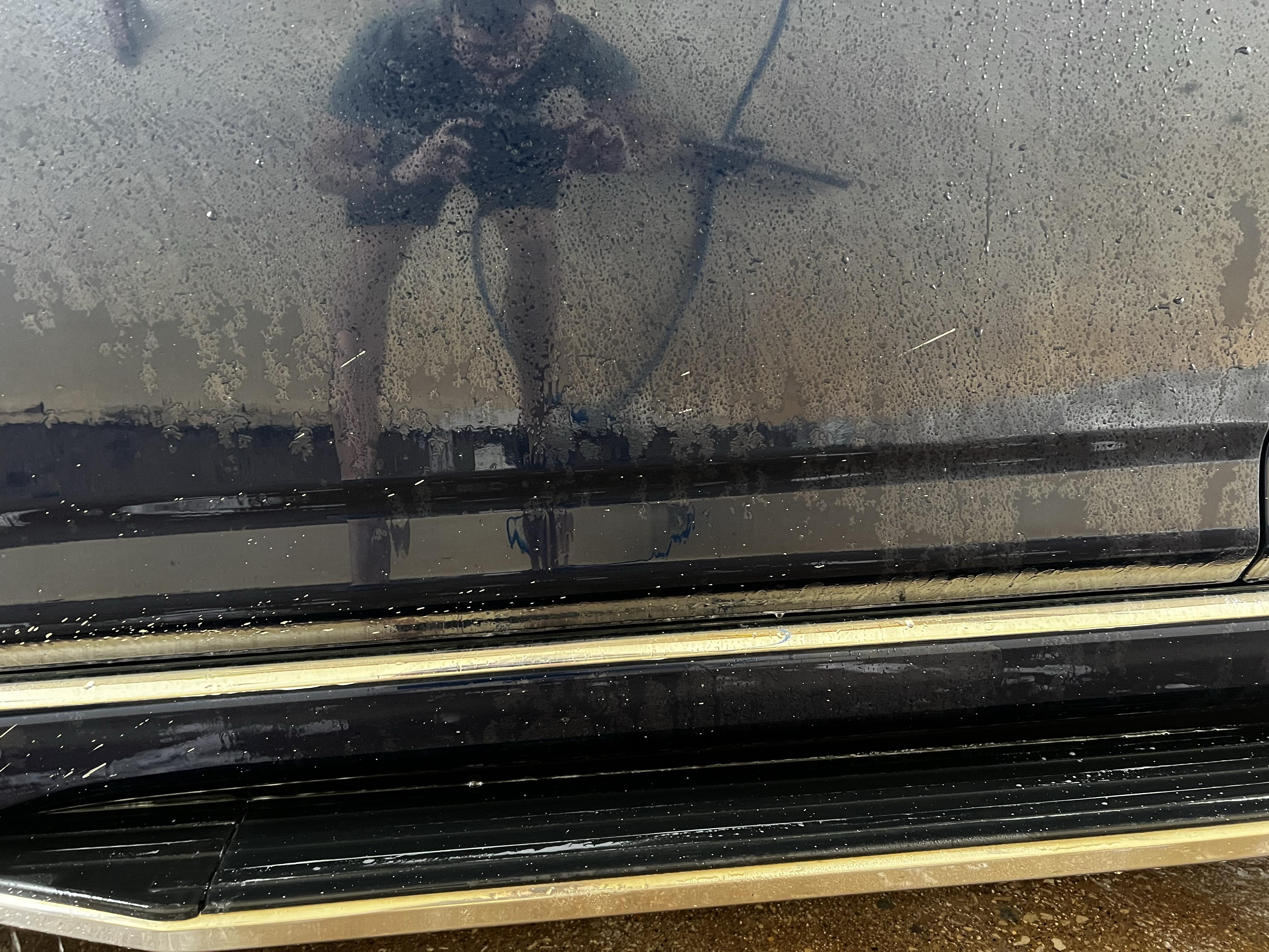

Before
And after - 5 hours later

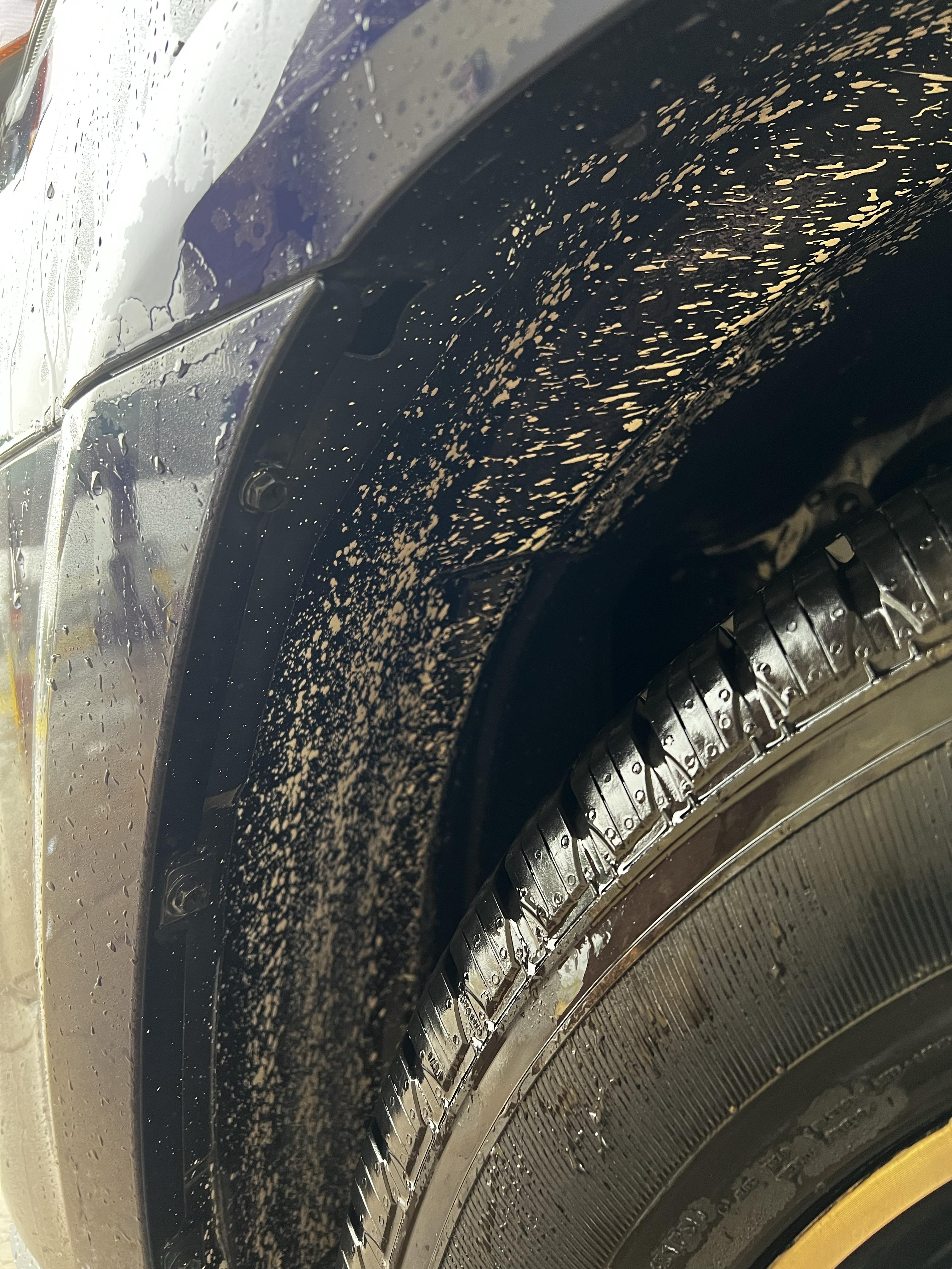

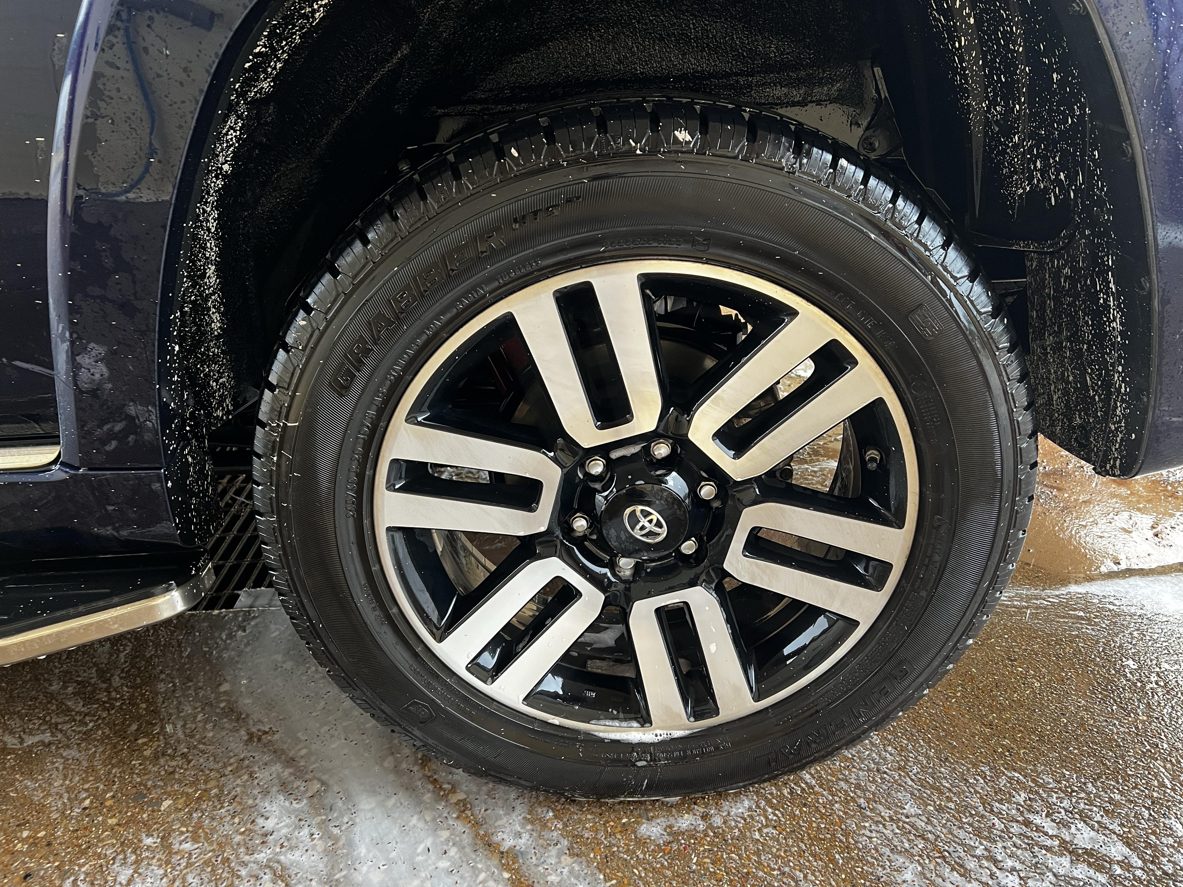

Can’t get it off the inner fenders, most likely gonna replace them. I’m also replacing the limited rocker panels/steps with an SR5/trail swap and some different steps!
The fender liners will also come out. Let the tar remover soak. Heat also helps if you have a steamer
I’ll give that a try! It’s definitely a multi day repair process, my main goal for today was getting it off the actual paint!

Since it's the inner fender liner, and since there's no (auto) paint there, see if you can dab some mineral spirits in there to get it off.
Up close and personal with a power washer might work too
If neither of those work, maybe some bedliner spray might stick.
That’s the plan, try some harder chems on the fender liners. If it doesn’t work, then move to paint/plasti dip/bedliner
