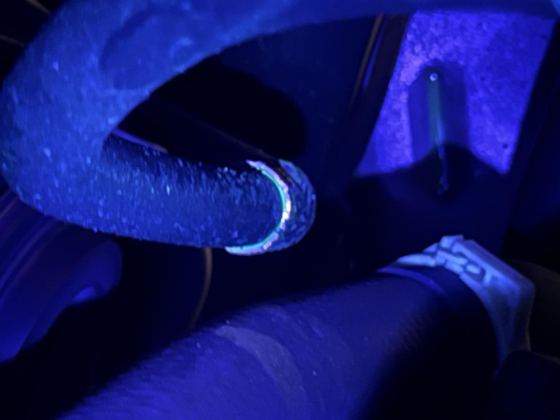

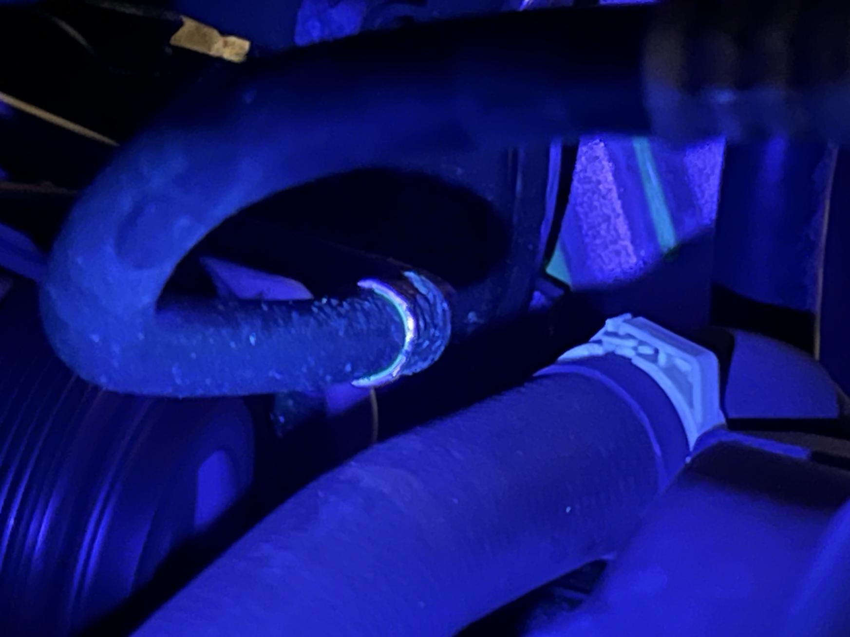

I have an AC leak. I am not sure of what the line is called, but staring down into the engine compartment, driver side, the hard-line that turns to hose and back to hard-line starting at the condenser (?) and reaching down to the bottom of the compressor…is leaking where bottom rubber hose meets metal. I had to add R134a every few weeks, but now I have to add a 12 oz can for one hour trip. I am running out of Freon and $$$! SO, I added leak detection and with a UV light can see oil/bubbles seeping out of the hose/fitting. SO, I need to replace that hose (whatever the heck it’s called!).

Thanks in advance for any help. If there are any videos out there, I’d love to see them. **Pics of the leaking oil under UV light.**

Changing the hose is not too bad. I would imagine a shop would charge $800 for the part+refill. The hose itself is like $130. You can reach the compressor by going in the wheel well and removing that rubber flap near the UCA, and its a single 10mm bolt holding it on the compressor. for the other side you remove the top plastic shield over the radiator and another 10mm bolt holding the condenser side. You can just weave it out and weave the new one back in. Then do the refill process.

The line you describe is the discharge line.
