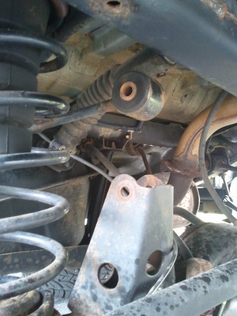

Hey all,
Underneath the truck today and found this disconnected in the rear. Can someone tell me what size bolt is supposed to be there?
Thanks!

is that not the control arm??
Someone correct me if wrong.. but definitely dont drive until you have that back together, you can pull your driveshaft right out.. trust me :)
90105‑12287 - Bolt
94622‑31200 - Washer
90170‑12039 - Nut
Get them from a dealer. Don't use a home depot bolt on this. They'll cost about $5 total, but you won't have to replace these ever (at least you shouldn't), and you know you have the proper bolt for a very important application.
BTW, use loc-tite on the nut when you install it. You don't want this falling apart again. Removable should be good enough I think.

Oh, and you are correct. That's an upper control arm. Very important.
Thanks Nelson!
Yea upper control arm. Crazy thing is I have no idea how long it has been missing, by the looks of it it's been a minute..

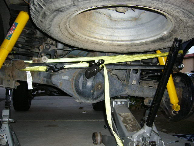

Can't for the life of me get the holes to line up to get the bolt through. It's just slightly off. Slightly forward if that makes sense. Any suggestion?
Have you ever reconnect your panhard bar.. probably not but if you have you have youll probably have seen the ratchet method. f you have a ratchet (one used to hold cargo down etc) then you can wrap it around your axle and then frame and crank it until the hole lines up. Ill work on finding you a pic of what i mean
I have disconnected and reconnected a couple of these. I found that getting on your knees, lining the bolt up, and then shaking the vehicle up and down with your back while forcing the bolt in works pretty well.
Are you trying to line up the UCA bolt, or the panhard bolt? This method should work for both, but it might be easier to line up the UCA bolt if you disconnect the panhard. It gives more wiggle room.
The UCA bolt. Thanks for the tip I'll give it a try and disconnect the panhard after the "wiggle" technique
