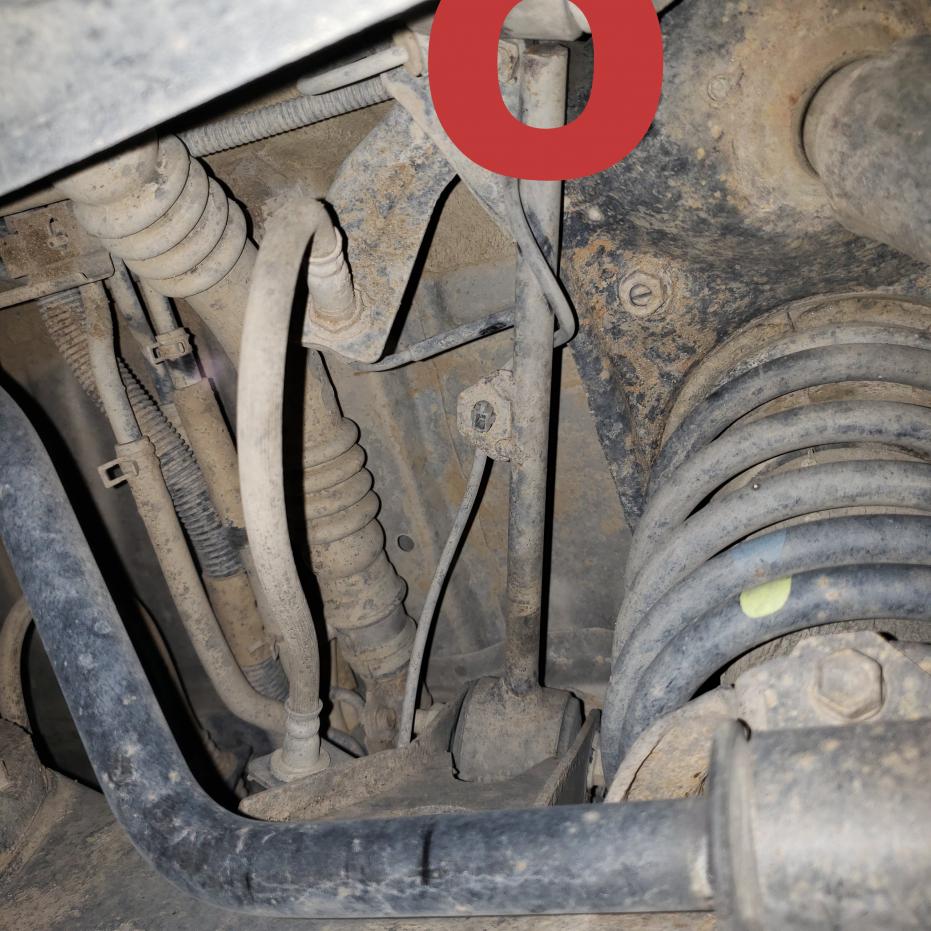

I just discovered a broken upper control arm. Driver side rear.
Rear Spring & Shock Absorber - 2001 Toyota 4Runner
Model number needed is on sticker on driver side pillar.
$116. Mounting hardware part numbers from earlier post much appreciated-

Your link doesn't specify which upper control arm you are going to get so just wanted to make sure you get 48710-35040 since your signature says you are 4wd.

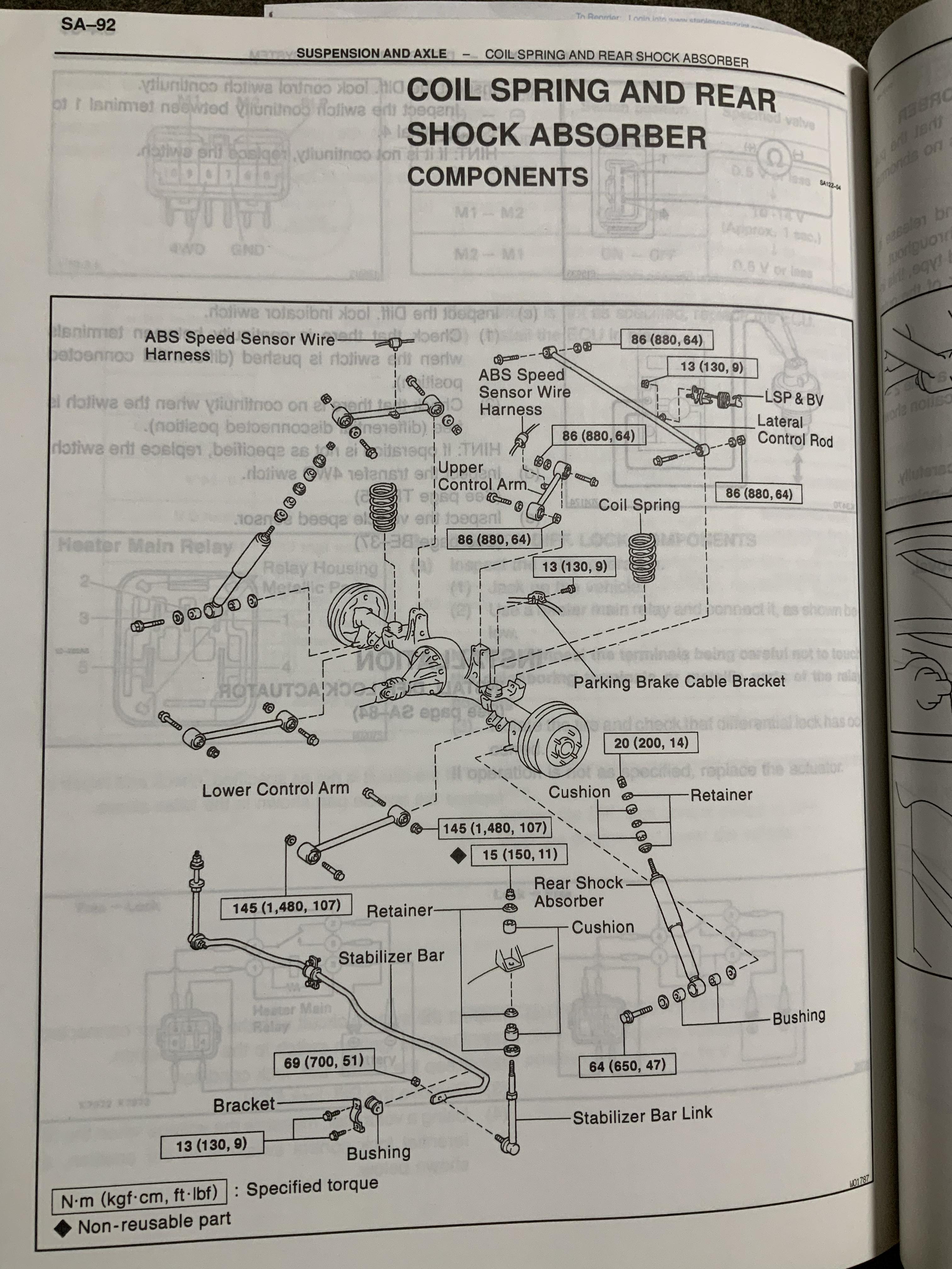

Everybody who who is replacing bolts, remember to torque the nut and bolts to spec. 64ft lbs is what it’s saying on my FSM.
