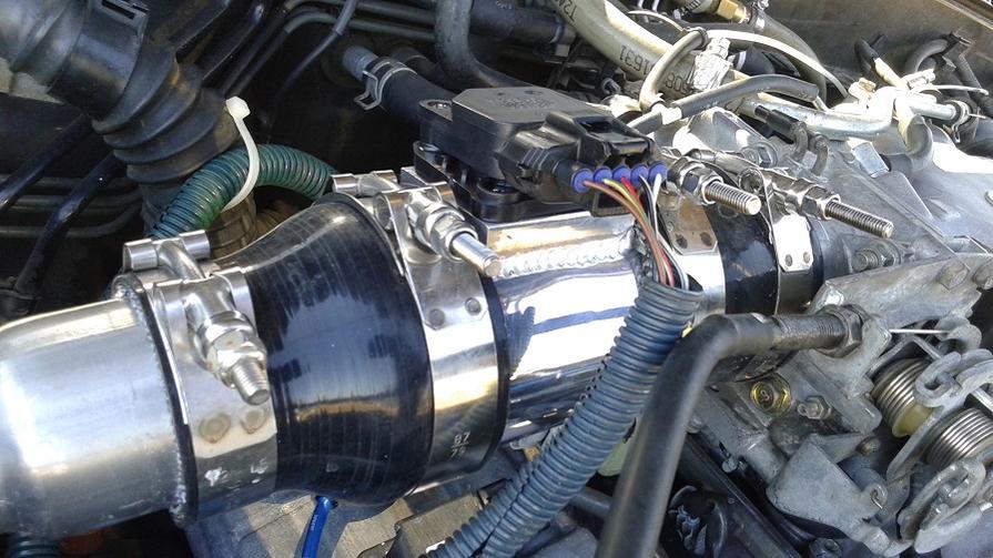

Put a new IAC gasket on, black FIPG on the solenoid part of the IAC. Found a used TB at the junkyard. Also, replaced the old style MAF with new style. It is running good for now.
