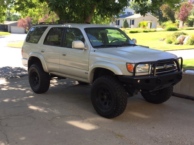

Bootboy's 2000 SR5 build thread.
Running strong after finding a massive vacuum leak.
Need to mess with the steering and get an alignment, it's pulling pretty bad right now and the wheel is about 25° to the right when going straight. Just fine tuning. Adjustable panhard on its way
As a note, the rear upper shock mounts on the third gens is probably Toyota's single worst piece of engineering. Bilstein also screwed up when they designed the 5100 for the 3rd gen. If you've installed them yourself you know what I mean.
Got it aligned (finally, after being turned away twice when the shop had rusted vehicles with broken parts on their alignment rack)
Drives straight and smooth. Pretty smooth on bumpy stuff with minimal rattling incident to the age of the vehicle.
Next up: sound deadening.
I have a flow master which I'm not sure I'm going to keep. We'll see how the sound deadening goes before I decide to ditch the muffler.

What is your exact lift? Perch, coils, tundra 5100s??

Tundra yy/yb and tundra 5100. 3rd perch.
Toytec superflex rear and 3rd gen 5100's
New sway bar bushings from and rear.
Poly power steering bushings.
SS adjustable panhard inbound
SPC upper control arms.
Diff drop also coming
I knew as soon as I lifted it, I was libel to tear a cv boot. Sure enough, grease everywhere today... It's always something

How's the ride on the 3rd perch
Sent from my SM-G935V using Tapatalk
Nice looking rig man! What size are those Cooper ST Maxx tires? I think those will be my next shoes after my BFG KO2s.
What did you do about the torn boot? is just getting new boots enough to insure they wont tear again or do you need different ones? i just put adjustable fox 2.0s on my 3rd gen a week ago and they are only set at around 1.5 inch lift, i want them higher but the guy at ORW said the higher we go the more we risk throwing cv boots.
Yeah, the boots will wear out more quickly with geater driveline angles.
Bear in mind though that mine are 16 years old. New boots should last a while.
I've not driven much on my torn boot so I'll pull it and check the wear on the axles themselves. If they are nice and tight then I'll just replace the boots. If their is any sign that hey are less than perfect. I'll replace the whole thing.
