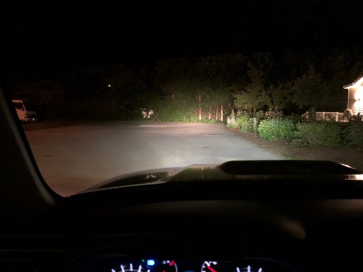

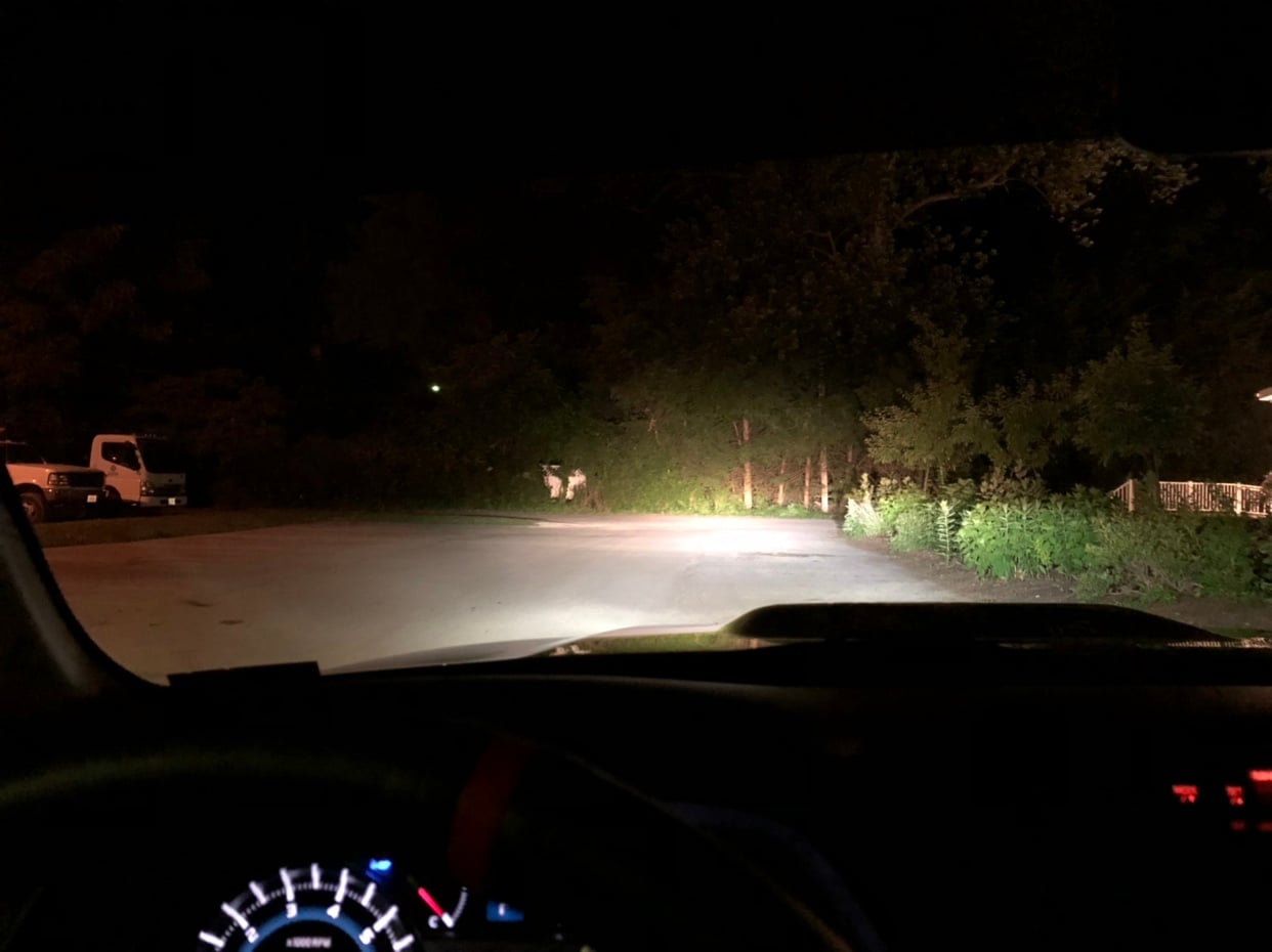

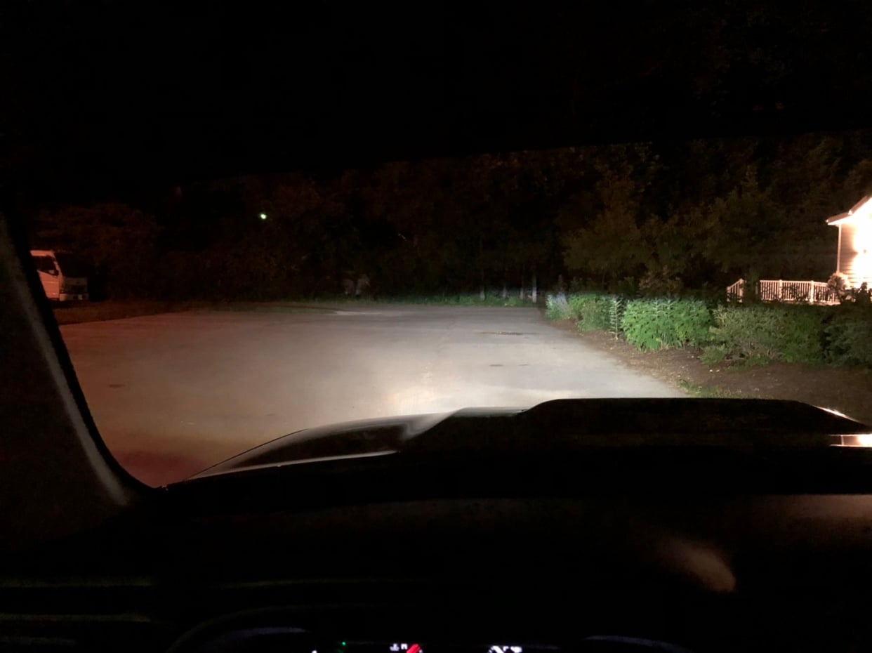

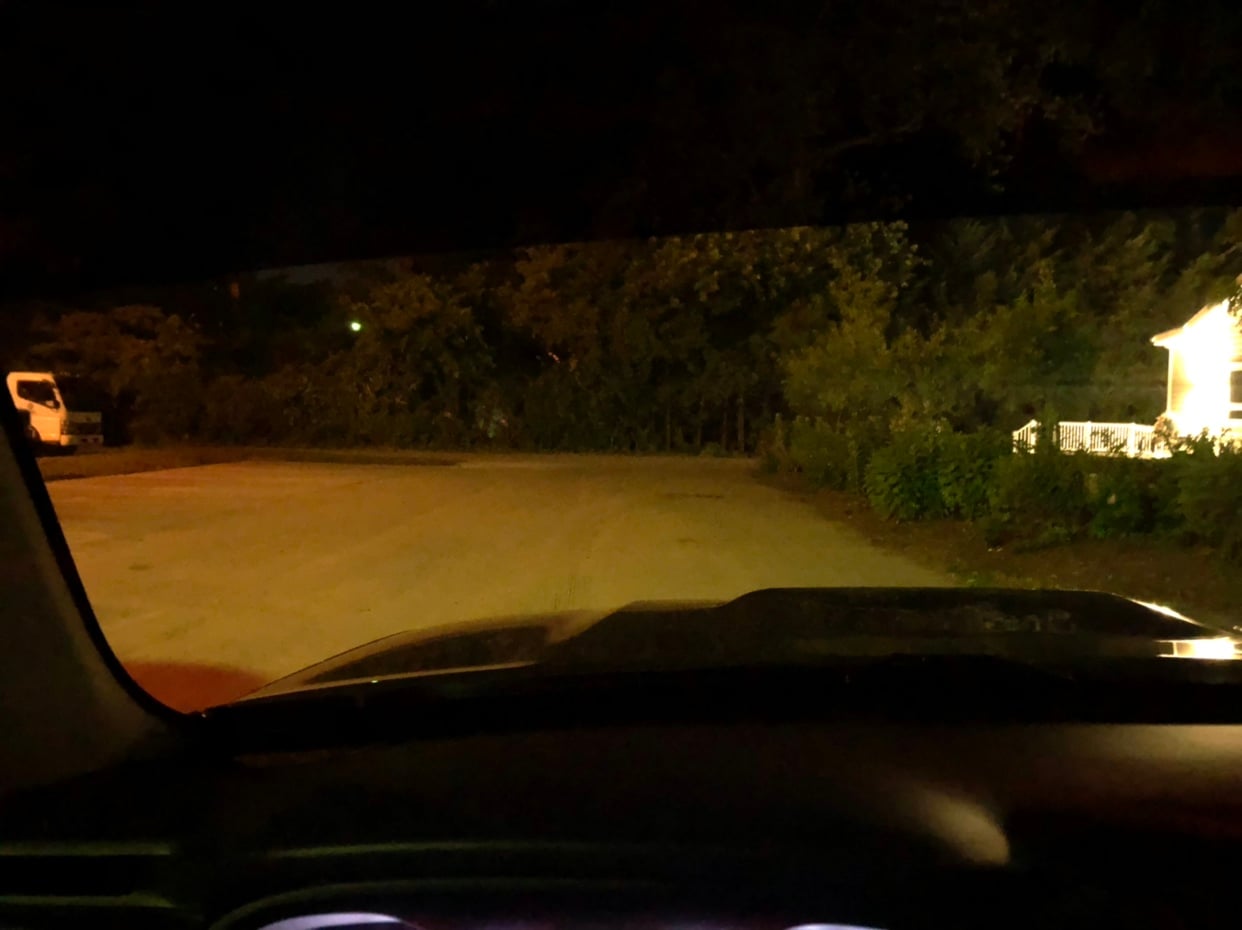

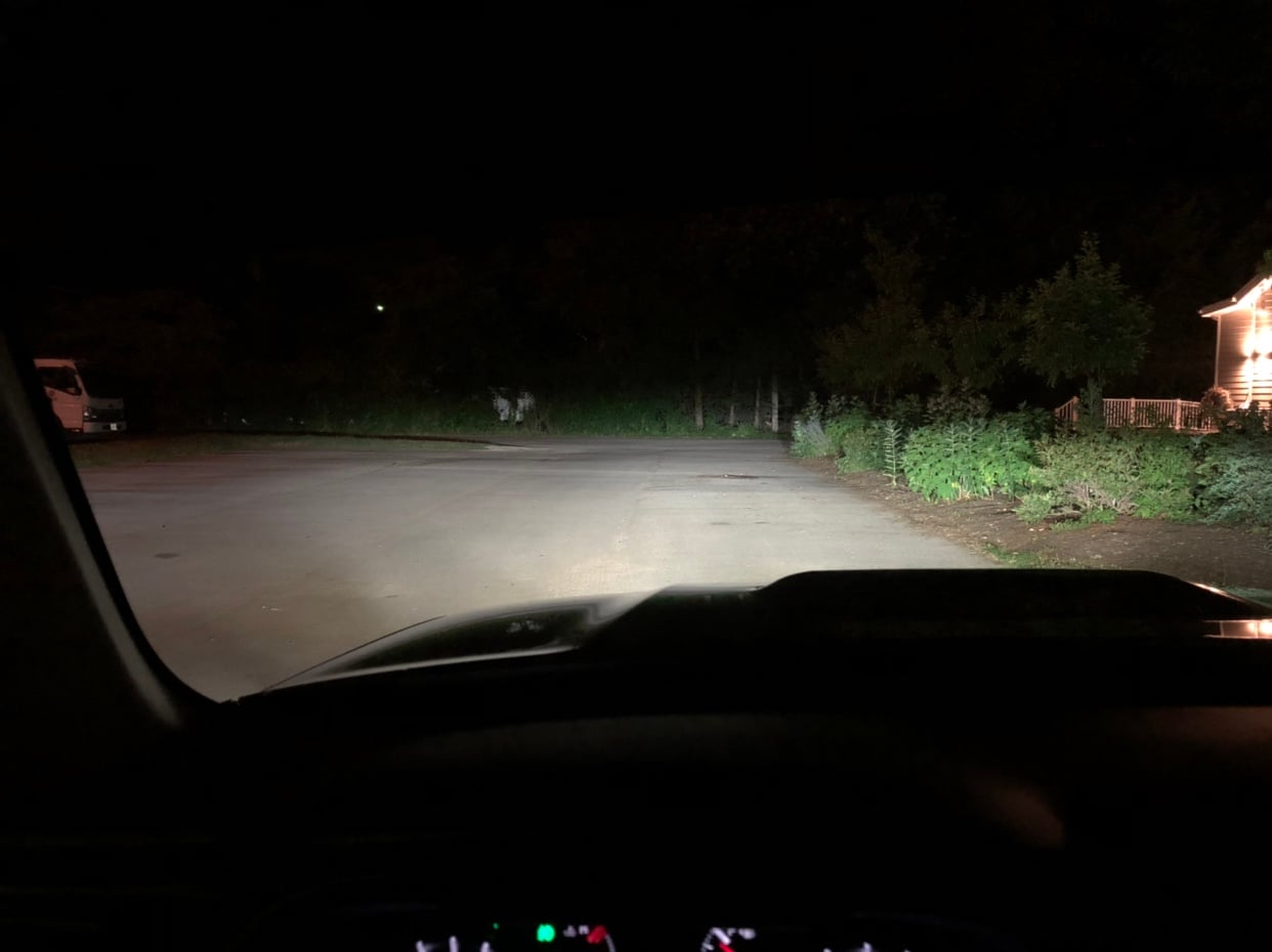

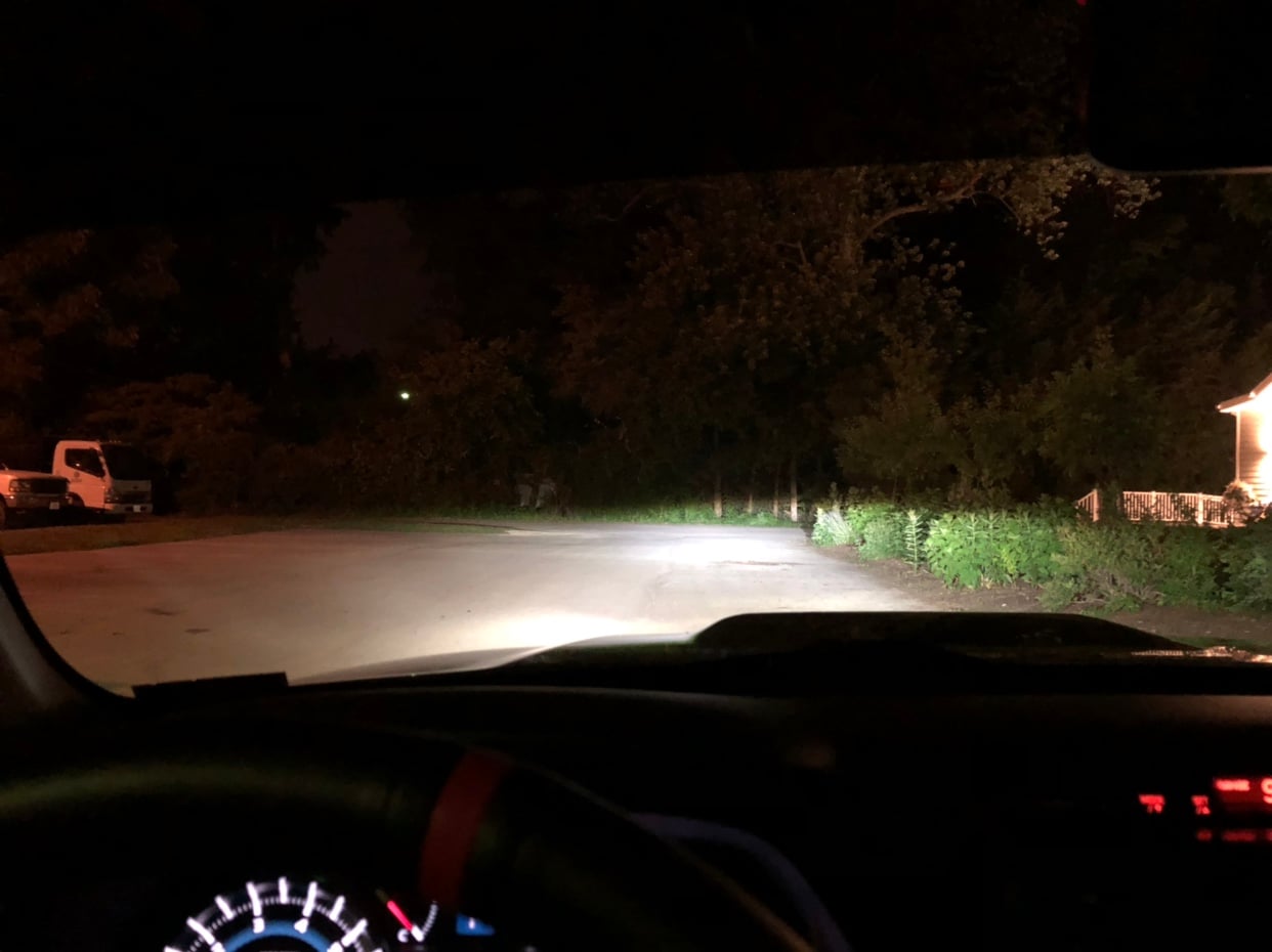

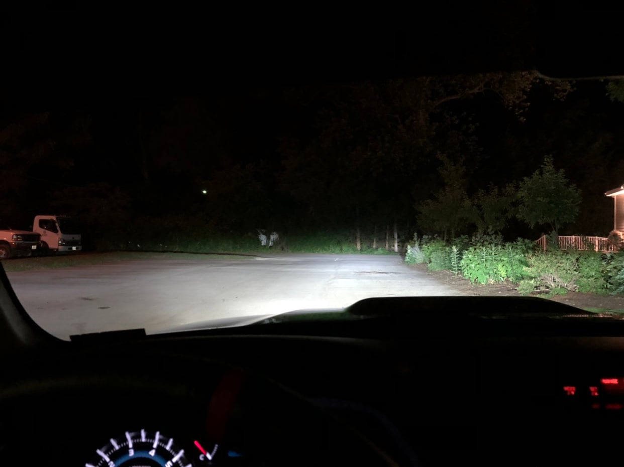

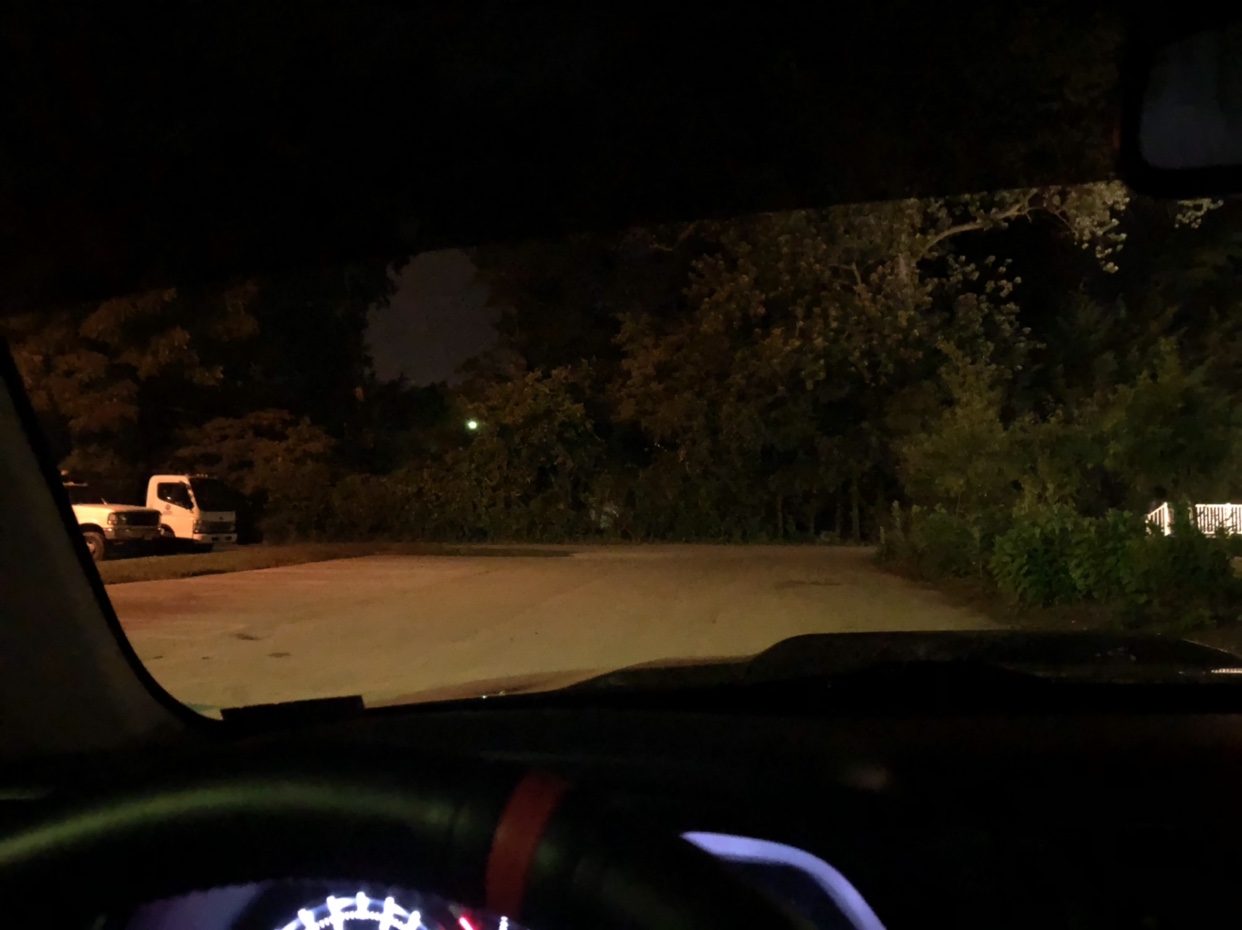

Here are the photos sequence.
Lights off, low beam, low beam and fogs, high beam, box
H11(H8,H9) LED Headlight Bulbs,... https://www.amazon.com/dp/B07SGQ8TCZ?ref=ppx_pop_mob_ap_share
After some night time driving on roads with street lighting I’ve discovered that the LED throw is not very far. This isn’t new news. LEDs are notorious for not having the push power as HIDs, especially in a projector housing.
These BOSLLA B1’s can be rotated to adjust the beam pattern and after fiddling with that a bit with no illustrious results I decided to test them against some of the “best” LED bulbs on the market. The Diode Dynamics SL1 H11’s.

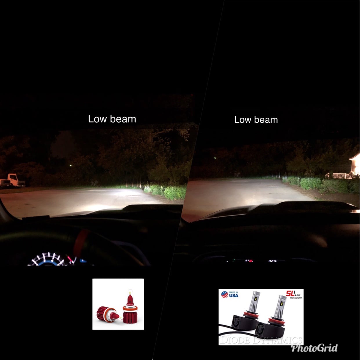

Photos with the Diode Dynamics SL1 H11s.
Off:
Low beams:
Low and fog:
High beam:
It’s hard to tell from the photos if the DD are any “better”. I’ll update.
Side by side:
UPDATE:
I had some install issues with the Diode Dynamics that I inquired about with their customer service. Turns out the "old" SL1 worked with the T4R's but the "new" SL1's are not designed for our housings.

This post just proves why these are illegal. The beam pattern is awful and the hotspots just produce a ridiculous amount of glare.
Do you have the same picture with the stock bulbs?

That said, these things are absolutely horrible. I knew that before I even saw the pictures when the OP "I rotated them to get the best output".
Manufacturers spend millions on R&D - these guys spend 10 cents on a cheap base and superglue it to an even cheaper bulb. then they put it in a 75 cent box and call it a day.
Can you show me what you see when you look at the pictures? I get the hotspot, but I’m not seeing the glare. The cutoff line is pretty good isn’t it?
Be happy to.
The brain (and the eye) is drawn to the brightest area. That is the reason that headlights are designed with an unlit area directly in front of the car so that the eyes will look down the road.
Here, we have several hotspots. One directly in front of the car (about mid picture, right above the dash) and another down the road.
Those hotspots wash out all detail - and that is glare.
Headlights are designed with an unlit area directly in front of the car so that the eyes will look down the road.
