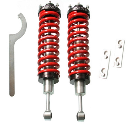

Just an FYI... My set-up came with two (2) rings.
Most of the photos in Google for spring installs show (2) rings. Perhaps they made some changes in seeing that perhaps 2 rings were redundant. But I will say again - my Boss Toytec set-up came with 2 rings.
Good luck.
Picture of (2) ring adjustment.

Mine also came with two. I did get them when they first came out so they may have changed it up since.
The new 2.5's come with just a single ring, and I've seen pictures of the 2.0's with just a single ring. I didn't realize they had two before since it's not really necessary, but I'm sure they've changed it to a single ring. Even if they haven't changed for the 4runner, I know they use it on other platforms and there is no reason it wouldn't work on ours.
Between bad weather and kids soccer games, I'm not going to have time to do the install today. I emailed, and I'm going to call Toytec on Monday to get it straight from them. I'll post whatever they say.
I just got off the phone with Toytec. They recently changed the set-up from two to one adjustment ring. They said that they extensively tested the one ring set-up and found that there was no adjustment ring movement. They said that the change was partially due to occasional issues with the two rings binding together and becoming immovable over time.

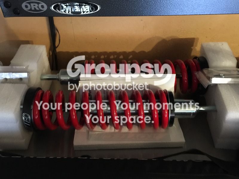

Happy to oblige, but I just can't help myself ...
...and they'll prolly go in this weekend. Called Shrock and my bumper is still a couple months out.
