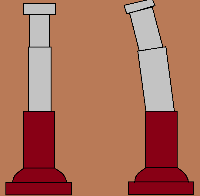

the big thing with the hilift is its so tall and it can slip easily. I have certain spots on my bumper where the jack can sit and not slip off. at the same time the length of the hilift does give you some control when the truck starts to move, and when it does you better be holding on to it so you can control whats going on. the hilift is really a two person tool, you need one to keep their hands on it at all times, the other should place the jack stand or tire. with the bottle jack you want to lift from the lowest possible point, for our trucks on the front its the rivets under the control arms. this gives the jack the most stability because it hasn't extended very far. on the back, id say its probably the shock mount. I rarely jack off the diff housing or rack cross member in the front. the small floor jacks from autozone dont even reach my ucas since im running 35s.
Btw landcruiser guys running 37s still use the stock bottle jack, its a good jack but you need to understand how jacking works, never assume the load is stable unless you have chalked the wheels and are using jack stands. the best way to think of it is just like your truck on an off camber obstacle, if the point of contact between the jack and the frame is not above the base your jack will swing over.
ive attached a diagram of how the bottle jack can move in certain situations. often the jacking point will shift and the jack will end up looking like the second diagram, if this is the case, lower the jack and set it up so that the jack is set up the opposite of that to start, this will give you more stability when you need it.
