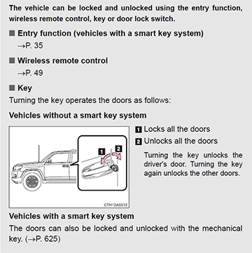

At this point I'm reading the manual, trying to figure out what's what. My 1st roadblock to that end is the keys. The vehicle didn't come with a "Smart Key System". I haven't been able lock or unlock the doors, except the rear door, with the physical keys. When I insert the key into the driver side door it turns to the right but does nothing. It will not turn to the left at all. Is that the way it's supposed to work? The lock and unlock buttons on the keys work but I'm kinda thinking the actual key should also work in the driver door.
Is my thinking wrong or is that the way it works??:confused: If so I'll move on with that knowledge.

Turning to the left should lock all the doors, turn to the right to unlock. Turning to the left will also roll up the windows if you hold it. I honestly don’t know if the key will physically unlock the door when the electric door locking mechanism is disabled. Since your key fob works, I would think someone put the door back together incorrectly when replacing the lock mechanism.

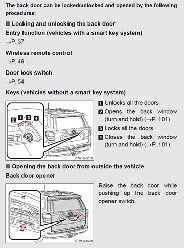

I also have a 2013 Trail Edition. Here are excerpts from the owners manual describing key access:

Note that for the back window, you turn counter-clockwise to unlock, whereas for the driver door, you turn clockwise to unlock.
I believe that both the door and back window locks are electronic; they will not operate without power.
The locks seem to be sensitive to key wear. I have one key that operates as described, but another key that is a little worn will only operate the back window; it will not turn the door lock in either direction.
