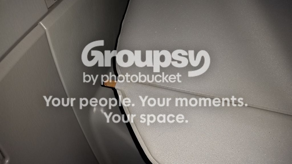

I also bought a cargo cover off of ebay but also need to buy the hooks to latch onto as my 4runner didn't come with them. However upon receiving the cover, it seems like it's missing some rubber coverings over the metal to catch onto the tonneau cover hooks. Anyone know how I can find parts to use or some easy modification as I'm not exactly sure what it's supposed to look like? See picture below:

Exact same thing is wrong with mine. I need something over the metal end. Have you found a solution for this? I was thinking of 3d printing something but i dont know the dimensions. Can you buy that piece?

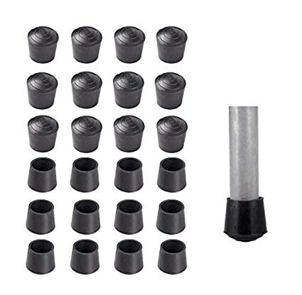

I bet you could find some rubber table leg caps that would fit.
They're probably pretty cheap, too.
