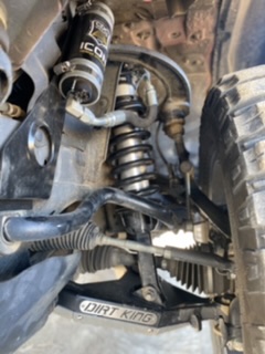

bouncy ride after new LCA install?
tm965
Recently had some DK lower control arms installed and as soon as i drove away from the shop (which had just closed) i realized something was probably wrong as the ride was very stiff and bouncy over small bumps in the road at lower speeds. at first i just chalked this up to have new delrin bushings as opposed to rubber, but i soon realized that there didnt seem to be much articulation over small bumps that wouldve been soaked up prior to the install.
As soon as i got home i inspected the lcas and everything looked fine so then i looked at my UCAs which i had also asked the shop to loosen the bolts on and grease them while the LCAs were being installed. Much to my surprise they did not loosen the bolts and greased the shit out of them, bulging the poly bushings out around the ucas... i called them the next morning to ask if they had loosened the bolts when greasing and the response was "oh no we never loosen the bolts when greasing" WTF. I was also told the owner woudl give me a call back about replacing the bushings and of course no call back as expected.
Later that day I removed the zerks on the UCAs to let the pressure of the excess grease out and thankfully the bushings moved back to where they were originally. Unfortunately, the bouncy ride persists. Now if i push down on the front bumper with all of my weight the suspension barely has any give. I then removed the LCA zerks to see if any excess grease would come out and none did.
At this point, i cant decide if my UCA bushings are still binding or my LCAs were installed and torqued down while the vehicle was still off the ground, causing the delrin LCA bushings to bind.
I dont have access to a flat spot to work on the vehicle and the only shop in the area that i trust at this point is only open during the week and an hour away, which i dont have time for.
Any recommendations on how to proceed here? Can i loosen the lca bolts while the vehicle is on the ground or will i not be able to get enough leverage? Also anyone know off of the top of their heads what bolt size is?
Any thoughts are appreciated.

Problem solved--the UCA bushings were still binding from the overgreasing. I loosened them up completely, bounced the vehicle some, regreased, then backed in and out of my steep driveway a few times before re-torquing which has solved the issue. Thanks for your thoughts here guys

I can't keep it from feeling bouncy, started soon as the lower arms went on, with my 2.0 vated coilovers, and now after I upgraded to Icons, same thing. When I called Dirt King they said "2.0" isn't enough, get some 2.5's"
If I adjust the valve to be tighter or more resistance added it bounces less, but still real stiff... If I run fully soft it bounces like a cut spring civic.
We ran the preload down from 2.13" we put it at to start. I didn't measure it after we dropped it but it did improve, still rides super stiff and bouncy.

In case anyone comes across this, the upper control arm bolt was WAY too tight.

Installed my DK LCA on my 2015 summer of 2020. SUPER bouncy. I took a LOT of measurements, definitely seemed like the inner metal sleeve within the derlin bushing was recessed more than it should be...given how derlin bushings work.
Lets get something straight, derlin bushings are meant to pivot around inner metal sleeve, so those who make the "loosen it, then tighten it under load" comment...I'll say that this really should not matter given the way this bushing works. Stock bushings are rubber, and do not act in a hinge like manner as derlin bushings do. The rubber in stock bushings actually is fixed and flexes to create a bit of resistance, but also absorb the loads on the suspension...we'll come back to the load absorbing aspect in a sec...
So, I called DK...emailed them measurements (pulled my LCA's off more than a few times). I ended up ordering Fox 2.5's w dsc's thinking it would make them better. Nope.
Here's what we (DK and I) came up with at the time. The powder coat was applied beyond the 'target' thickness casing the black part of the bushings to essentially stick out more than the inner metal sleeve.
So the culprit (in theory) at the time was that the Bushing was not actually working as designed. The inner metal sleeve becomes fixed when tightening the LCA bolts, and the black outer busing is to rotate around the sleeve *freely* with moderate resistance.

If you're struggling still, try this first: Lower your LCA bolt torque to around 60-ft LBS. Mark your cam tabs first, just in case they shift a bit...don't go 'baja 1000'...just a quick circle around the block. Did this feel softer? If so, then you're likely experiencing the bushing bind issue.
Shave a little off the black bushing, A LITTLE AT A TIME...LIKE BASEBALL CARD THICKNESSNESS...and try it.
