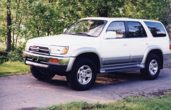

BTW, I tried the big C clamp method when removing the UBJ. No way were they coming out, so had to remove the knuckle and use a shop press. Pic is a few days after purchase (early June 1998).
