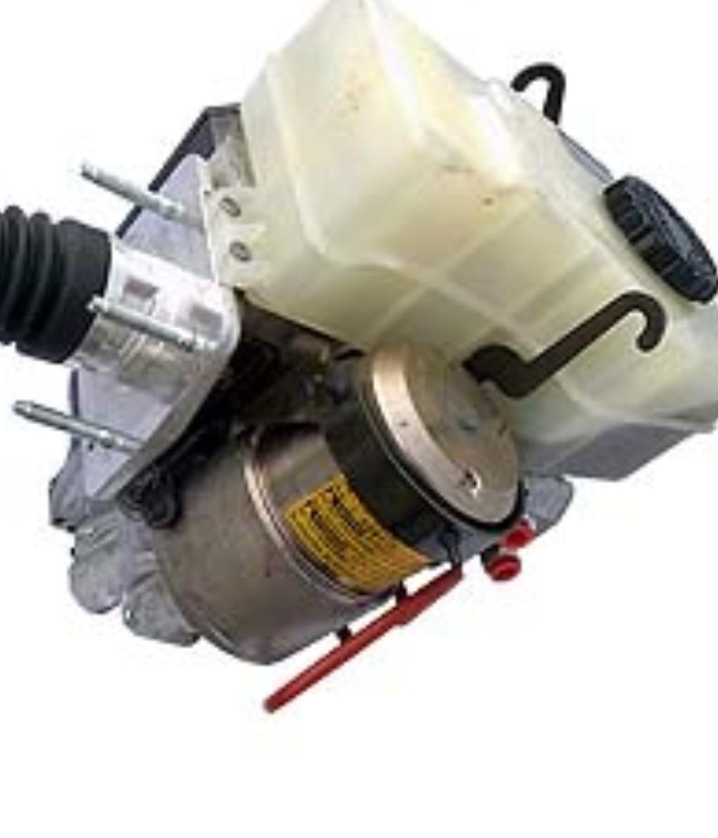

Just recently noticed after the 4R has been off for awhile, like overnight, the ABS brake master cylinder assembly makes a buzzzzz about 5 to 15 seconds (depending upon how long the 4R has been off), then a click and it stops. I verified it's coming from the master cylinder assembly by turning the ignition to the on position and quickly inspecting/listening.
It seems to be coming from the cylindrical accumulator pump motor seen in the pic below. Wondering why the accumulator needs to pressurize when 4R is has been off?
Is this normal operation?
Stats: 2004 SR5 V8 RWD, 33k odometer miles.

Note to self: When in doubt check the owners manual. (blush)
Brake System, Page 277:
"You may hear a small sound in the engine compartment after the engine is started or brake pedal is depressed repeatedly. This is a pump pulsating sound of the brake system, and it is not a malfunction."
Also Page 277:
"The brake system has 2 independent hydraulic circuits. If either circuit should fail the other will still work. However, your pedal will be harder to press and your stopping distance will increase. Also the brake system warning light may come on."
The owners manual is the T4R guide, but it confirms other posts I just found today indicating the pump sound upon startup is normal operation.
For my concern, I will call this case normal. The pump is an electric motor and like anything it could fail someday. It would be prudent to keep an eye on it and have the system checked out if the pump stays on constantly or the brakes feel abnormal.
Hope it helps others who are concerned.
