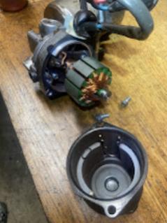

I opened the motor (just 2 allen screws) and to my surprise it looked almost new, there is no reason the motor was failing.
If the motor is good then the problem must be a failing pump or a failing accumulator.

I was looking at the removed and obviously failing motor/pump accumulator unit on my bench.
I could easily run the el motor and fluid was squirting out at the pump outlet.
The pump could be a 3 cylinder piston pump but not 100% sure.
My theory so far: the pump was failing and could not deliver the required pressue. This lead to the dashlight not clearing.
Well I still have no proof but I might take the pump apart at some point.
Here is a picture of the motor inside... it looked pristine, like new, see picture.
Martin

yeah, the motor is in great shape, you can sell it for a couple of bucks on ebay. wish i could get my hands on the motor, my 2nd replacement unit is failing again and its either the motor or piston assy
