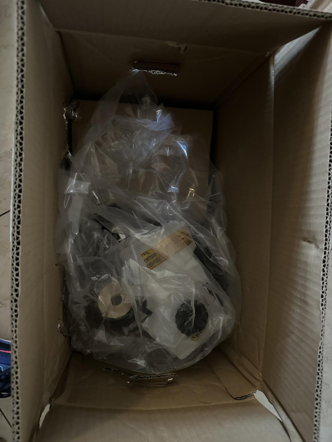

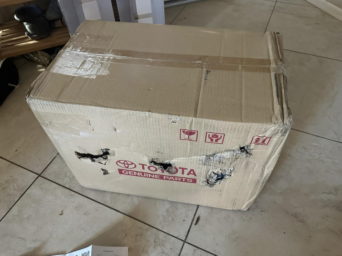

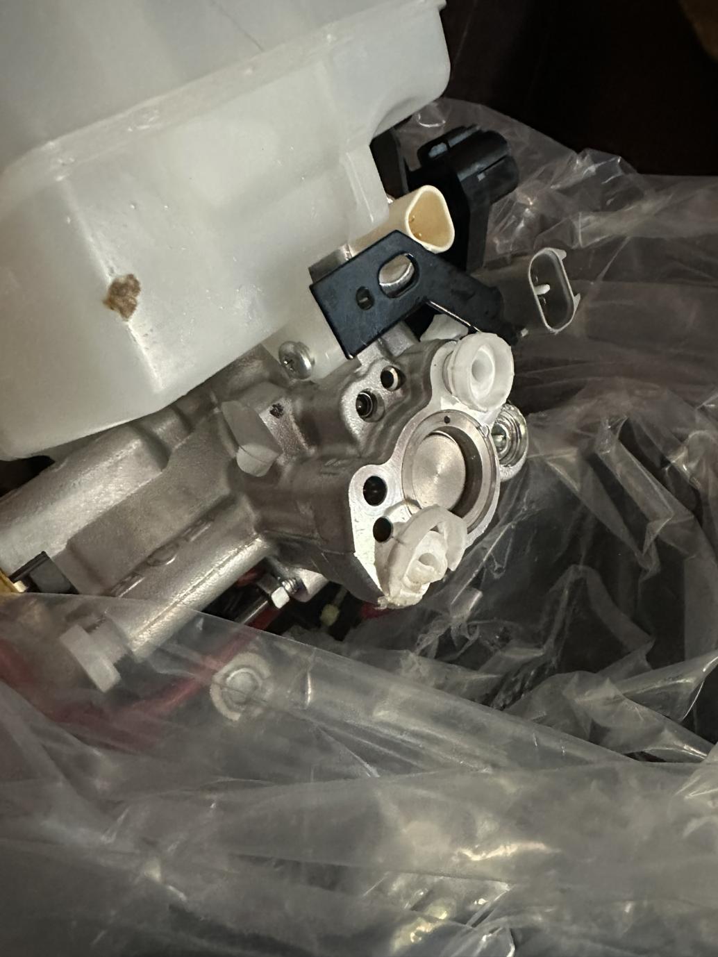

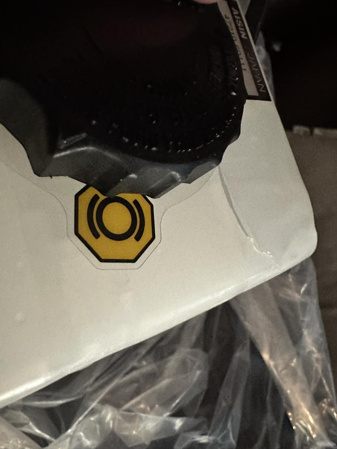

Well the new assembly finally arrived and it sadly got damaged :( Looks like they just threw it in a box with no materials at all. The wait continues while I fight with them on a replacement I guess.
When I got mine the box looked exactly like that, nothing other than the master cylinder in the box, nothing to keep it from moving around in the box and it isn't light, luckily mine didn't sustain any major damage.
I'm guessing that's the way the dealers get them from Toyota but probably doesn't get handled as roughly as they do on the "final" leg to a buyer.
Mine was shipped from California and delivered to South Carolina, so crossed the entire USA, where did yours shipped from and where too?
