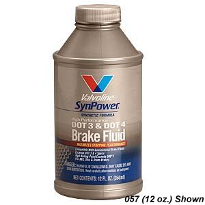

By the way...I use this type, because the boiling point is WAY higher. Well worth it & the fluid color is lighter, so you can see it when it's clean fluid compare to old fluid left in the lines.

Icantsee, how many bottles of that stuff is required for a system flush?
kimboy,
Sorry...I don't know for the 4R. I just got it since Halloween & I wouldn't be touching the brakes for another 2yrs. Or at least the brake fluid. I read or watched it on SpikeTv that the fluid needs to be flushed every 2yrs. I have friends that don't even flush it for 5+ yrs.
Uneek's MPV is still running on the original brake fluid since '94. And no problem, but I wouldn't recommend it.
Because the dirty & old fluid can deteriorate the brake lines. A few bucks for the fluid & 30mins of doing it is less cost than brake lines.
And back to how many bottles, I have no idea, but let me give you a run down on cars that I've done in the past.
'93 Honda Prelude - (1) bottle
'94 Acura Integra - (1) bottle
'95 Lexus SC300 - (1.5) bottle
'95 Honda Accord LX - (1) bottle
'97 Honda Civic EX - (1) bottle
'99 Toyota Corolla CE - (1) bottle
'99 BMW 328 - (1.5) bottle
'01 Honda Accord LX 4cyl - (1) bottle
'03 Honda Civic EX - (1) bottle
'03 Toyota Camry V6 LE - (1.5) bottle
'04 Subaru WRX - (1) bottle
So far...4cylinders seems to be (1) bottle & V6s are (2)
For the 4R, I don't think it'll be much far from the V6s that I worked on in the past.

I forgot to mention, those numbers are based on 32oz size bottles.
That picture is just what Kragen gave me.
