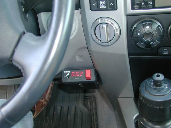

Here is a photo of the Jordan installed in my 4Runner posted here about 2 years.

Huh! I installed my Jordan directly above the brake pedal, as I thought there would be a straighter path for the cable. But it must work OK for you!
Gradual bends with clips installed to guide the cable - has worked flawlessly for the two years installed, plus in an emergency a passenger could hit the manual override red button
I saw where that could be done - the clips, etc. Must have educated yer passenger well! Guess I should do the same with mine. I'll hafta do some drills with her - although mine is further over, and she'd hafta lean way over with her face close to . . .
I initially was going to mount mine in direct alignment with the brake pedal, and with any girl I was going to take camping, I went through the emergency drill (red button, etc.), but some of the better one's with money would leave after the drill ...
I have yet to relocate it :biggrin2:
