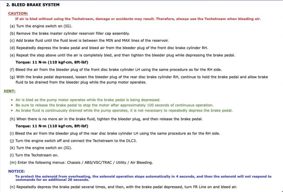

Looking for some help with a walk through or Toyota Service Manual for 5th gen 4runner (2011) Brake Fluid flush. I think mine has original fluid possibly, or at least it's been probably 5-7 years.
I want to flush it with new fluid. I'm familiar with it in the older (2nd gen runners) Pretty straightforward and easy. But figure there's a lot more tech in the 5th gen and might not be as simple.

I also found a link for 2010 FSM which has procedure in detail. My only question is why the sequence starts at front RH then LH then rear RH then LH which is the opposite of how I learned to bleed brakes.

I'd venture that ASE has a lecture dedicated to the subject.
Following the prescribed sequence may not be any more necessary than following the old sequence on your 1965 Malibu.
You could get away with doing it anyway you wanted back then, and you may be able to do it today as well.
The *incontrovertible* logic that air bubbles are hiding in the longest and then the next longest run does not seem to be an absolute factor as long as you bleed the lines thoroughly with a generous amount of fluid.
I know it took me a while to learn about the various new sequences, I DIY bled my own brakes on cars with ABS using the old rountines, and I did not die.
However, knowing that every new car has a prescribed sequence printed somewhere in a manual is enough reason for me to seek out the information and follow the recommendations.
It's not that hard to do it the recommended way, and I never know what I might not know.

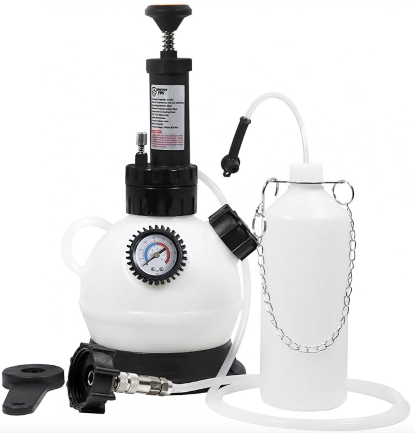

I flush my brake fluid with a pressurized tank. Makes it a one man job and don't have to mess with having someone pump and hold the pedal while you crack the bleeder.
Something like this is what I use. Works perfectly. I had to get a Toyota specific cap separately but that's also on Amazon.
