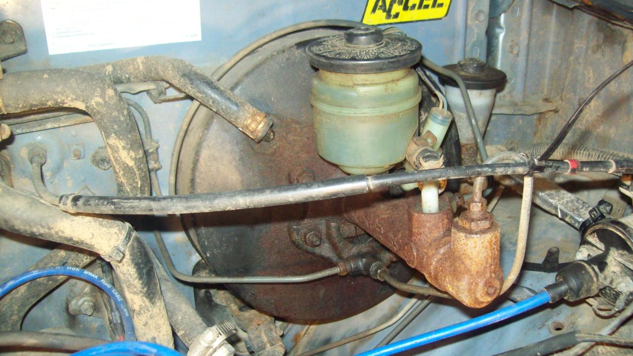

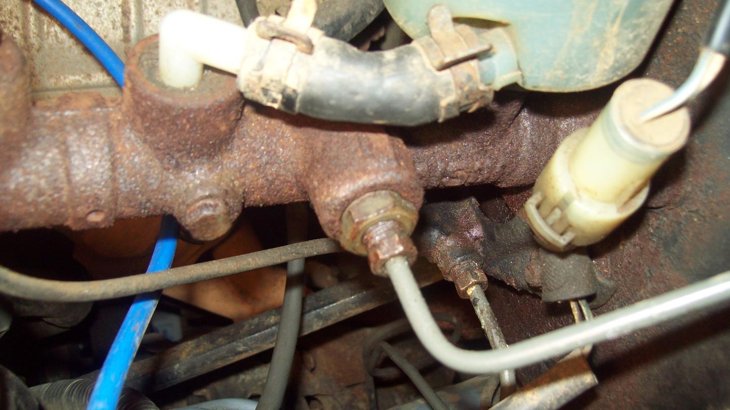

This is my MC. You can see that it has some corrosion. I'm wondering if it could be as simple as the seal between the MC and the powerboost? It seems to be wet in that area. And I can hear noise like air getting in around that area when the brakes are pumped.
Also, there are five attachments there for brake lines, do I need to bleed all five, or just the two on top?
