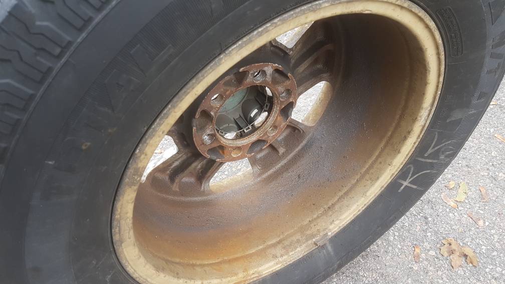

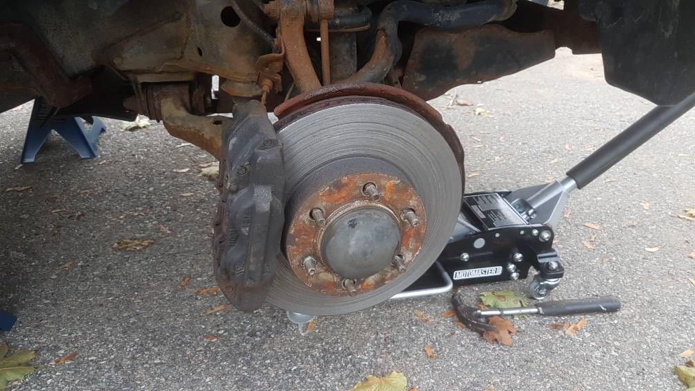

Well then after feeling a constant pulsating and hearing a scraping sound i took a look at the the front brakes and the front right brake is pretty messed up I'm guessing a stuck caliper but what i dont understand is why it would be stuck I just replaced this particular caliper only about 2 years ago what gives? You can see the amount of brake dust on the rim I suppose there is more brake on the rim then the rotor itself also notice how there's one pad that is pretty much non-existent now hmmm.

The tire the bad brake was under

Did you replace with a reman caliper? If so that’s why it stuck again quickly. Also if you noticed that much dust and look from that one side why wouldn’t you check it sooner?
Well look how rusted your caliper is. You live in Canada. Land of salt and snow. You will be replacing these calipers at least every 24 months for the life of the vehicle. Some people have had good luck with 5th gen brake upgrade or aftermarket. But for me I just buy autozone duralast gold which have a lifetime warranty. And just turn them in for new ones every 2 years.

I'm not sure what brand It is a shop called me over the phone saying I needed a caliper so ordered that one and put it on I never noticed the brake dust until yesterday when I went to check what the loud squealing was.

Don buy napa they froze on my after 2 yrs. Lifetime warranty but who want to do swap calipers every 2 yrs? Not me
