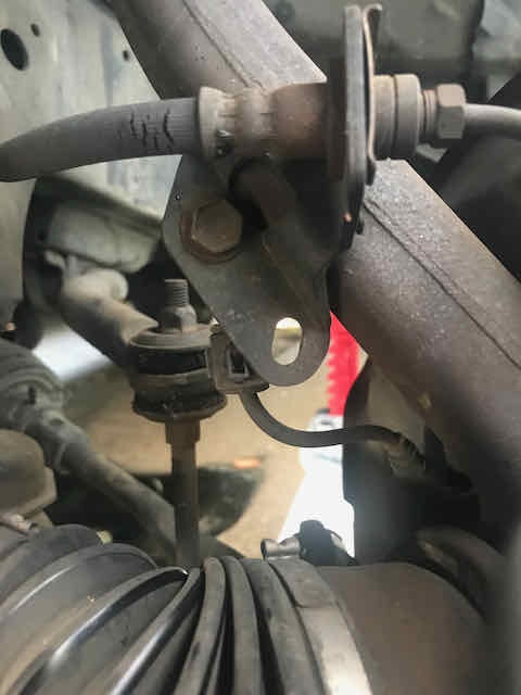

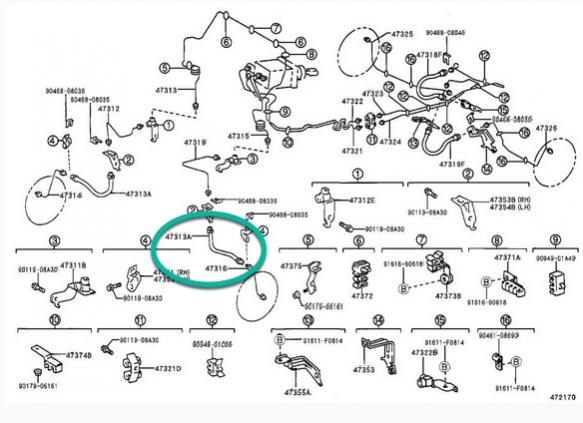

I can't get a grip on which part number this cracked hose is. My best guess from the diagrams at parts.toyota is 9094702862 Brake Hydraulic Hose and it's $76. Am I getting this wrong? I know critical systems really require OEM and brakes are pretty critical, but $76 for a length of hydraulic hose seems nuts.
