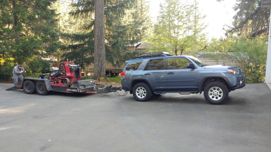

I live on a hill and sometimes after getting home I notice a slight odor that smells like brake or clutch overheating. I don't brake coming up the hill.
Yesterday I rented a small tractor with trailer about 4,000 lbs. Brought it home and the odor was very strong.
Hoping it's the catalytic converters getting hot. My T4 does not usually work that hard.
Any ideas what it may be?

just looking a picture...your over weight or something and burning brakes...be very carefull________________________________________________________[/QUOTE]
Trailer had surge brakes, used T4 brakes very little on flat ground and driveway.
It looked almost level, very little nose high in the equipment yard. Air bags were at 35.
It was parked on an incline part of the driveway and looks bad.
The loader that your hauling is on the trailer incorrectly. The machine needs to be over the trailer axles. That will take the load off of your hitch.

Probably a bit over weight. I use to own a similar trailer and it was around 2,200 pounds empty. I've been looking at renting a Dingo like that one and they are around 2,900 pounds without attachments. I see the bucket on the front of the trailer and it looks like something else attached to it. If I had to guess, the trailer with equipment is sitting at 6k at least.
