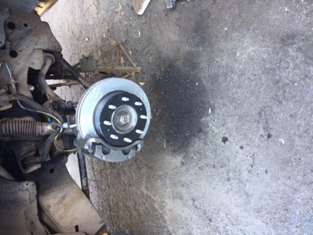

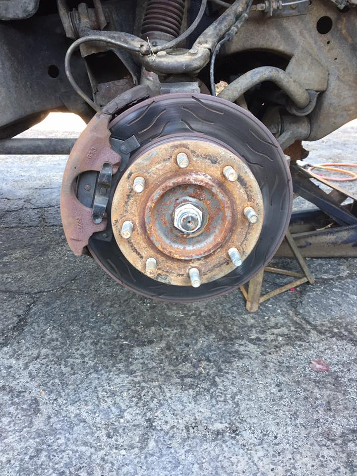

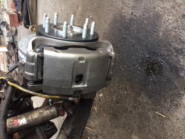

Before and after pics of my GMT 400 to GMT 800 brake conversion on my Suburban.
