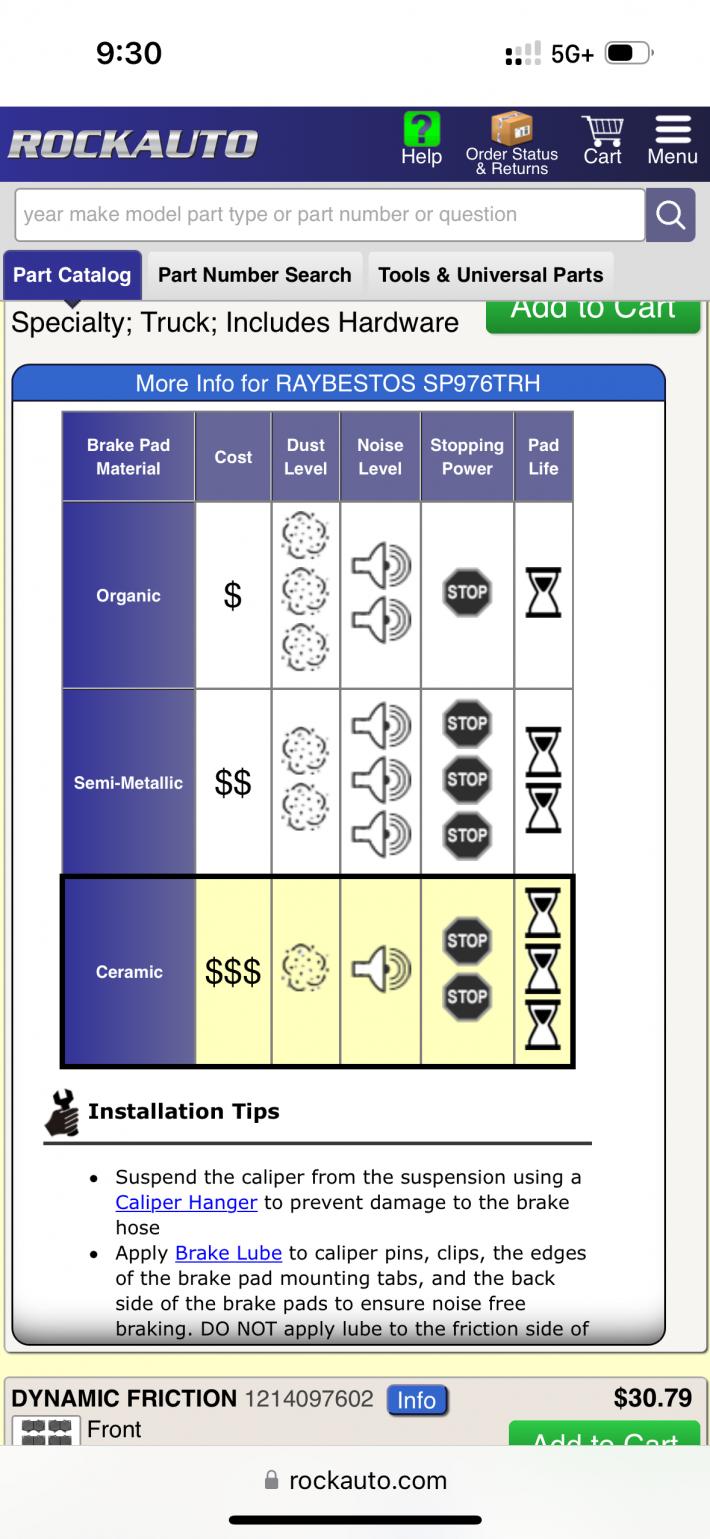

Best stopping power from semi-metallic. Next best from Ceramic, which also have longest life.
