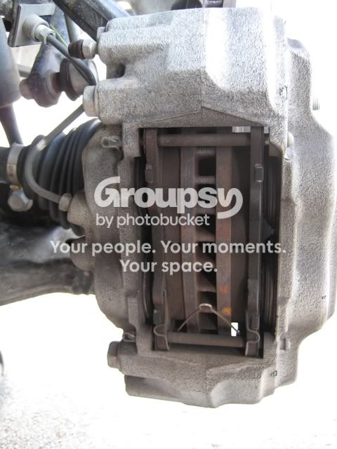

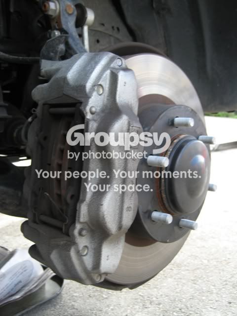

This is me at 6,000 miles.
IMG_0978.jpg~original
IMG_0981.jpg~original

Take one of your front wheels off snap a pic like icantsee and let us take a look.
