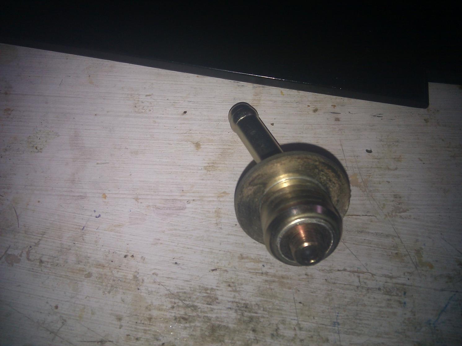

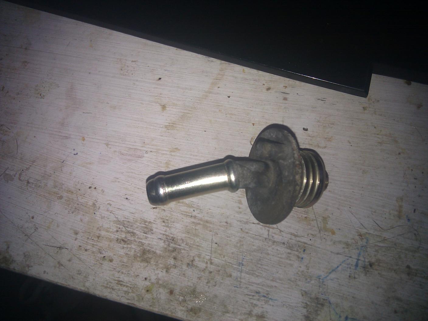

i took the check valve out, my dad says it looks fine. but then again there isnt much to look. i called the dealership and its 80$ for the valve and 1200 for the booster, no parts stores seems to have the check valve only stealership.
can anyone tell if the valve is the issue from the pictures?

Not that I know of, but others may be able to chime in.

If you have done all that to the brakes, then I would say that it is the check valve or the brake booster itself.
The check valve allows a proportional amount of air drawn in from the intake manifold base upon the pressure one applies to the brake pedal to have the booster assist the MC in applying pressure to the pads. When the valve sticks, and it usually sticks in the closed position, no air is drawn in from the manifold to allow the booster to aid in braking, thus the hard as a rock brake pedal. Once the manifold air warms up, the check valve will open up. A mechanic told me this after I forked over $165 to have him replace my failed check valve on a Ford Bronco in 2000 while skiing in West Virginia. Try to drive down a mountain using only the Ebrake was an eye opener.
