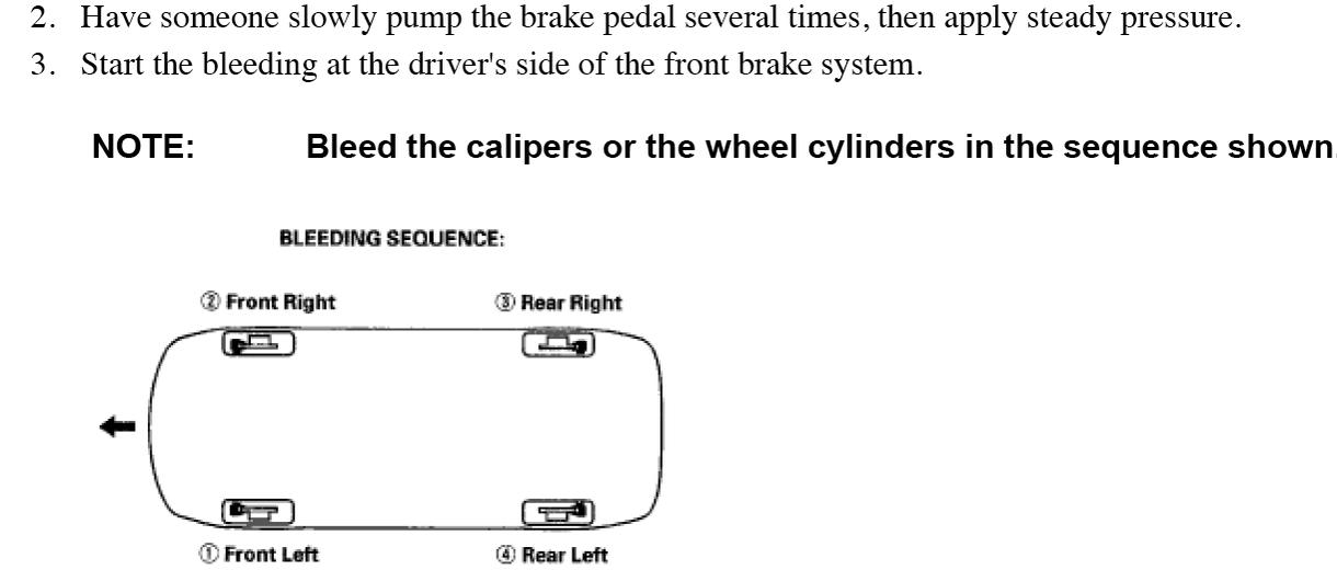

1. Bleed the brake in this order Front Driver-side, Front Passager-side, Right(Rear)-side, Left(Rear)-side.
2. Do the brake in if you replace rotors.
Why do you suggest bleeding that way. From my experience and knowledge, you are suppose to start with the tire furthest from reservior and work your way towards it. That way air gets purged through longest route first.
Everyone has their own way of doing it. There is no right or wrong way.
Watch this clip from this mechanic and we will learn since we are not a certified mechanic just a DIY.
How To Replace Your Brake Fluid - EricTheCarGuy - YouTube
Here is a PDF file brakes bleed sequence.
Well this is the total opposite of how I have always done it and the last time I did it on my 4runner, my brakes work better than ever. So I guess to each their own. If it works, it works. Good luck 994runna! :shrug:
