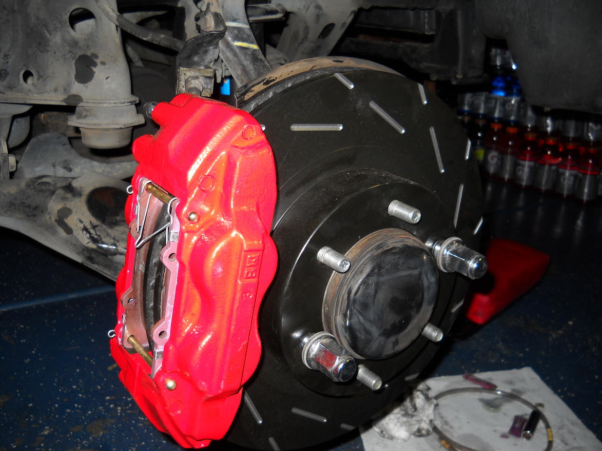

I just put EBC UltraMax rotors on our 03. I went with the larger diameter rotor for a sport model and matching size caliper with OEM pads.

TeamAllen - What calipers are those?? Would love to have some P/N's as well. I hate bleeding brakes, and hadn't thought of doing a brake line change at all, but if changing from hoses to braided flex lines, I may consider it.
BTTT

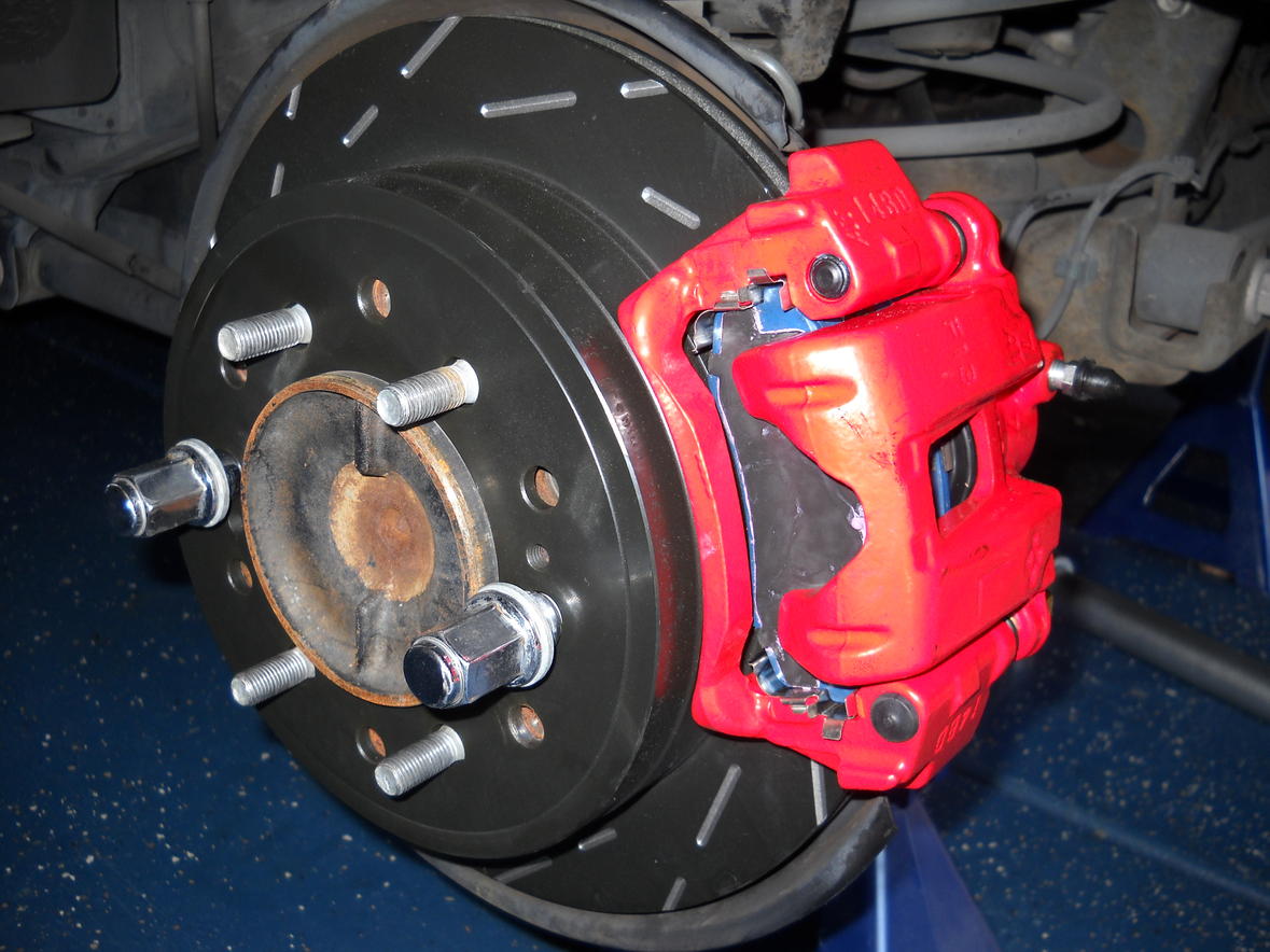

EBC Ultimax USR rotors. EBC yellow stuff pads up front (race pads)- lots of dust and more braking power. Green in the rear (only compound available) which is their more street friendly version.
DSC_1025.jpg~original
DSC_1024.jpg~original
DSC_1028.jpg~original
