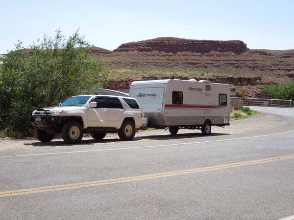

I have an 04 4Runner sport with the V8. I'm going to go through the brakes before we do a 35 day trip in Feb. I'll be pulling our jayco trailer so I want to upgrade the rotors since they probably need replaced anyway.

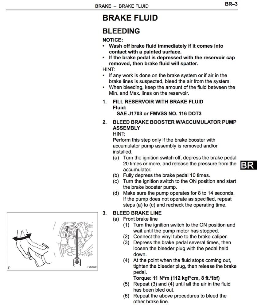

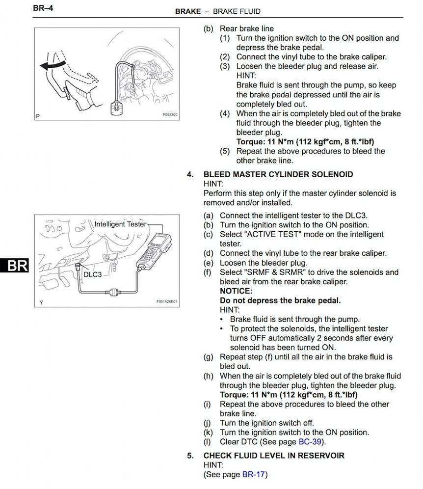

So, not to rain on anyones parade. But this is incorrect for our 4runners /Toyotas with ABS systems.
Heres how i bleed my '10 tundra, 5th gen and 4th gen 4runners. Works perfect with a firm pedal first push. If your soft, you've still got air.
follow this- http://www.toyota-4runner.org/2455860-post76.html
He's correct, here's the procedure from the toyota manual:
