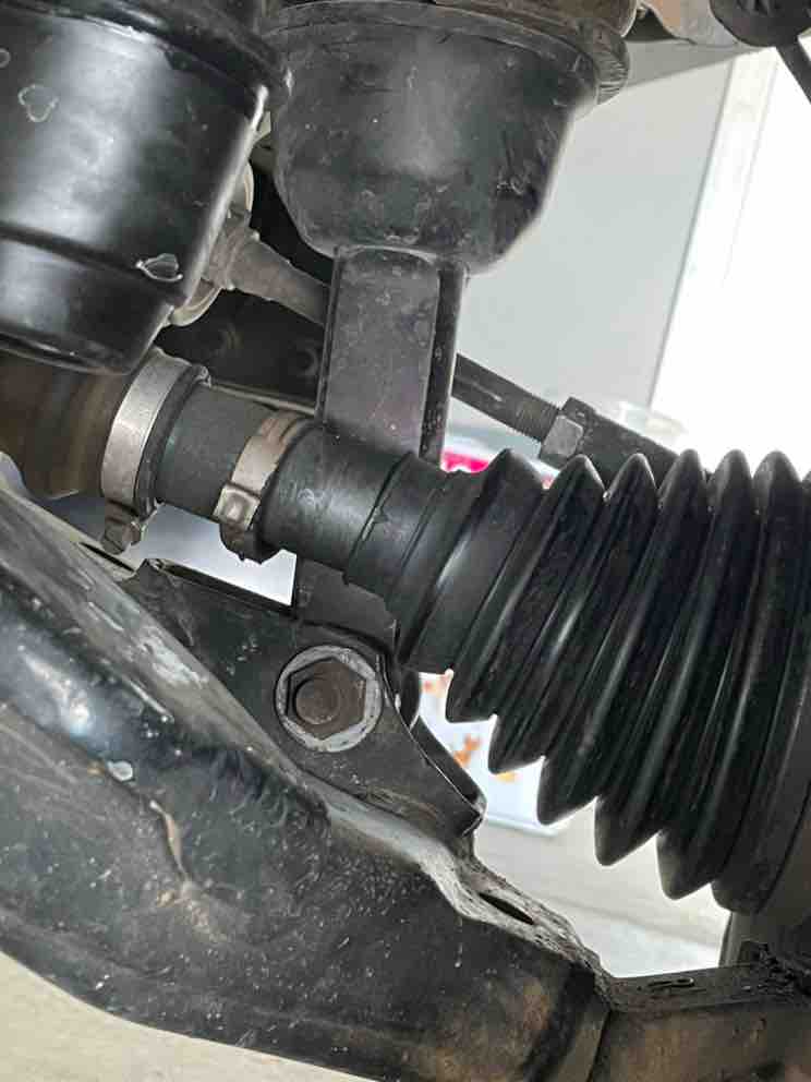

Holy crap dudes and dudettes!!!!!
I finally had time to do a diagnosis, scared shitless now lol. Only weird thing before tear down was a missing cv axle clamp. No biggie.

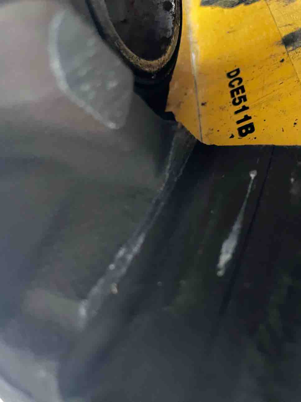

Next I noticed on the passenger side rotor there was wear marks. More concerning and maybe why the brakes have been weird.
Pads have same wear marks. Ok that adds up. Caliper seems to have made contact with the rotor in two spots, hard to get pictures but you see where I mean. I’m thinking stuck piston, only a matter of time (161k miles).

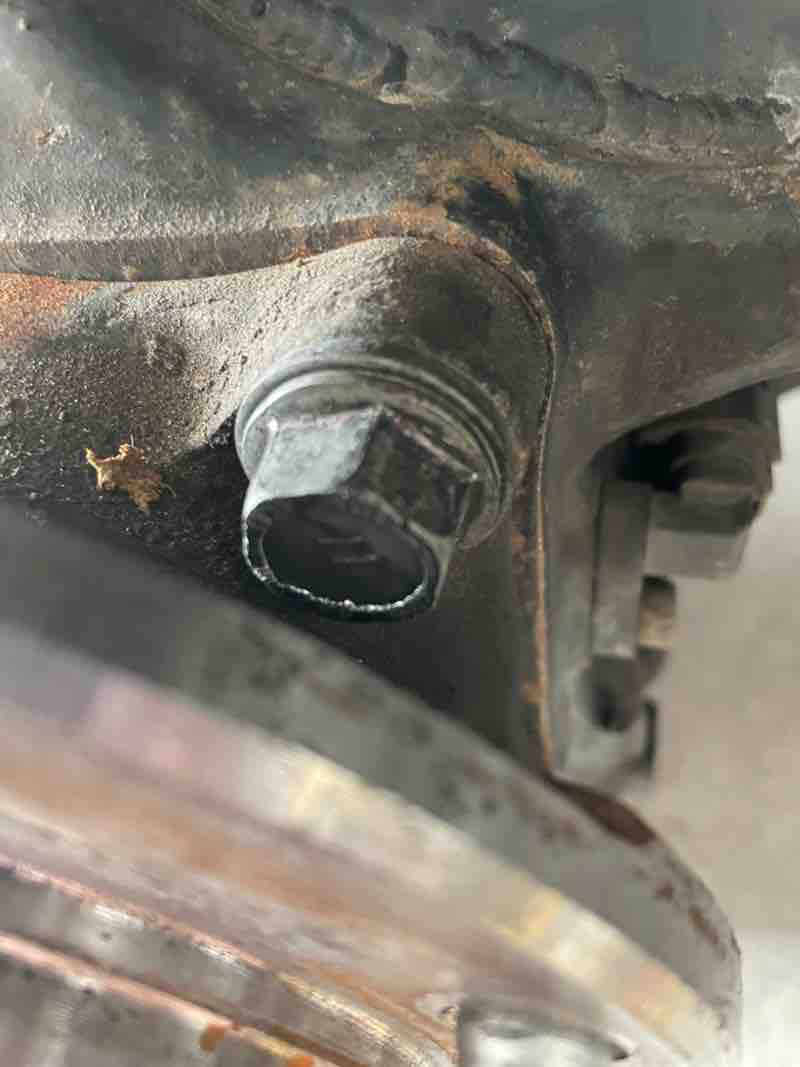

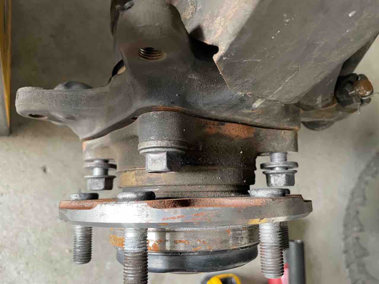

Then I look down and two of four wheel bearing assemble bolts, the ones that hold it to the spindle, are completely backed out!!!
Only thing holding them in was that they CANT fall out, no room. The clunking was the lug studs wacking the backed out bolt heads. Must not have tightened them enough when I gusseted the spindles, holy moly! Thankfully no harm to any other components that I can see.

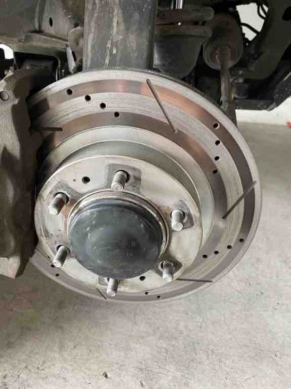

Tightened down the bearing to spindle bolts. Gave it the beans this time. 24mm huge wrench on the 17mm wrench (double wrench method). I’ll check it again in a hundred miles or so to make sure it’s staying tight. Replaced the brakes and pads, sad since the ruined ones were less than a year old. Glad I went OEM this time though, slotted/drilled rotors didn’t have me convinced for off-road activities.
Brakes are back to awesome after bedding the new pads/rotors! Apparently when the bearing would shift, the caliper was only catching the rotor on the inside and pushing it in to the opposite (outside) side of the caliper. So the caliper ruined the rotor and the rotor ruined the pad. This explains why the pedal was only soft sometimes. Sometimes it would align and work fine and sometimes it would not. Glad it was an easy and relatively inexpensive fix. IMG_1564.jpg

Was the Axle nut tight on that bearing assembly? I would be a little concerned about the bearing's integrity after being wobbly like that (though it might be okay if the axle nut was tight, might have shortened the life of the bearing; hard to say without being there honestly.)
I would also caution against over tightening the bearing bolts, they're only supposed to be torqued to something like 59~60ft.lbs. Though probably 70-80ftlbs wouldn't hurt them (at least that's how tight they seem when I usually end up replacing them after someone's done one before lol.)
Keep an eye on the assembly, the bolts may have have been damaged/worn with it being that loose like that, again, it's hard to say without being there. But sounds like you have everything under control.

It was tight, still has the slotted castle nut thing and a cotter pin. I think I may have just not tightened them down all the way because I was in a rush. I’ll always triple check from now on. I’ll keep an eye on the bearing and replace them both of that one starts humming. Thanks!
