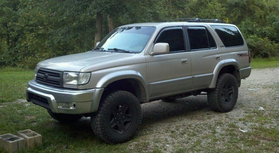

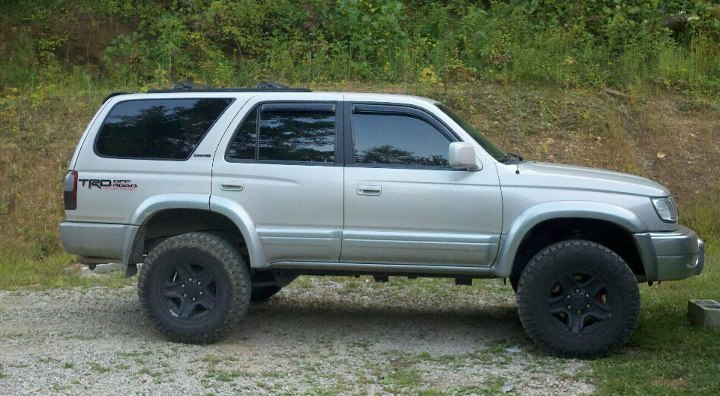

yeah i was pretty pissed off because these calipers are brand new...so that is what i was able to do warranty it out...i will be picking up new caliper in morning and also grabbing a Master Cylinder since i think that is what my problem is....but since my Runner has been giving me such a hard time over the past few days, I gave her some love and threw some TRD Offroad Decals on today!! had them sitting in my cup holder for a few days now...since it gives ya "15 extra horses under the hood" i figured why not? LoL!
I really dont know if i am diggin them that much though :shrug:!!! hopefully i get come around....
