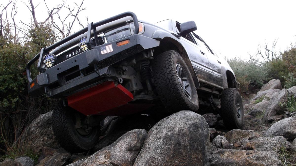

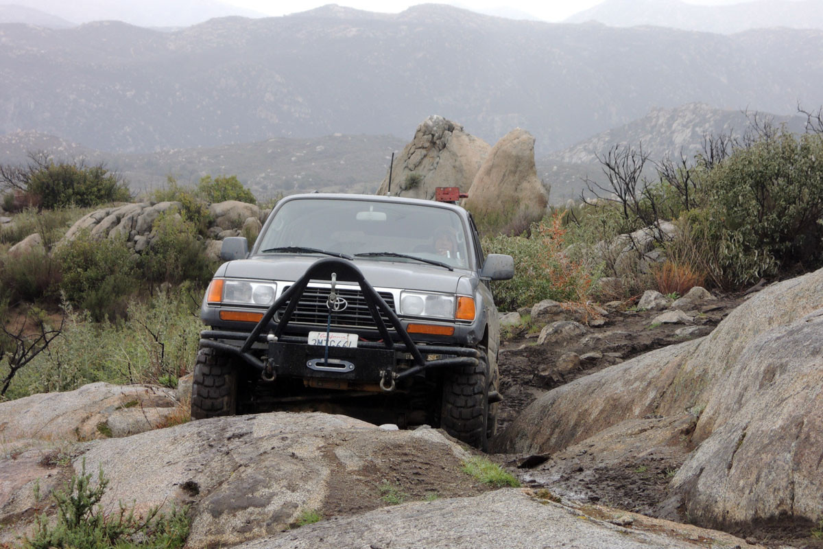

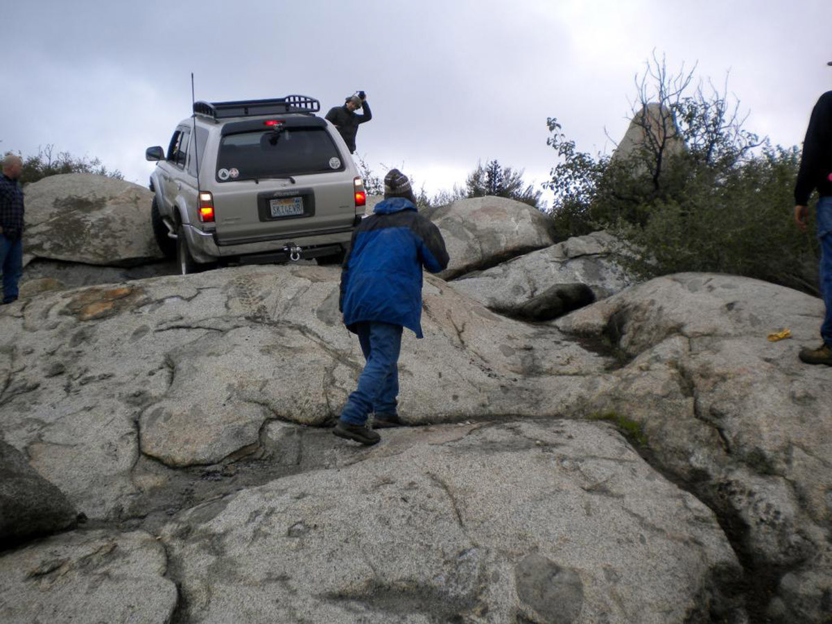

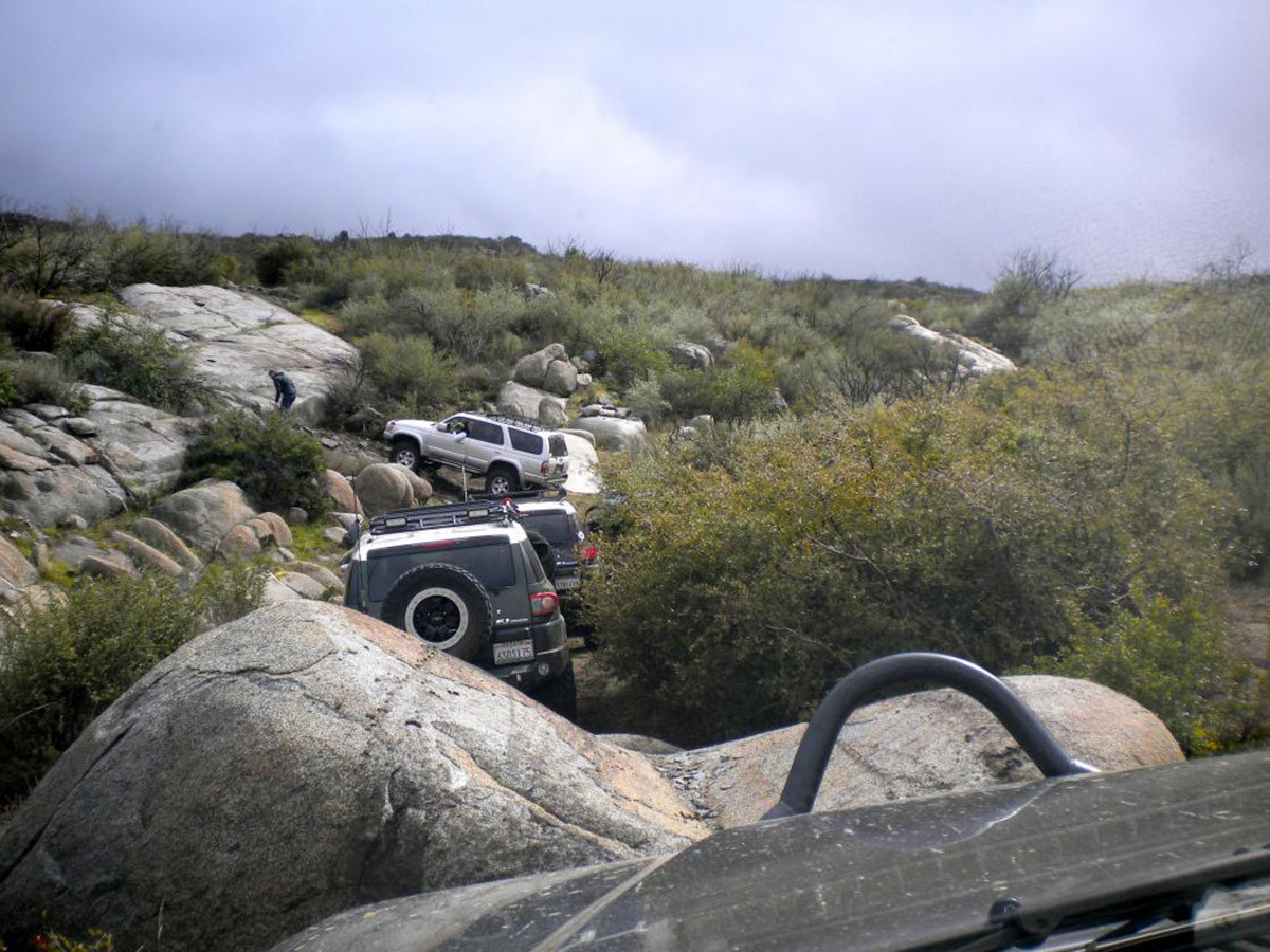

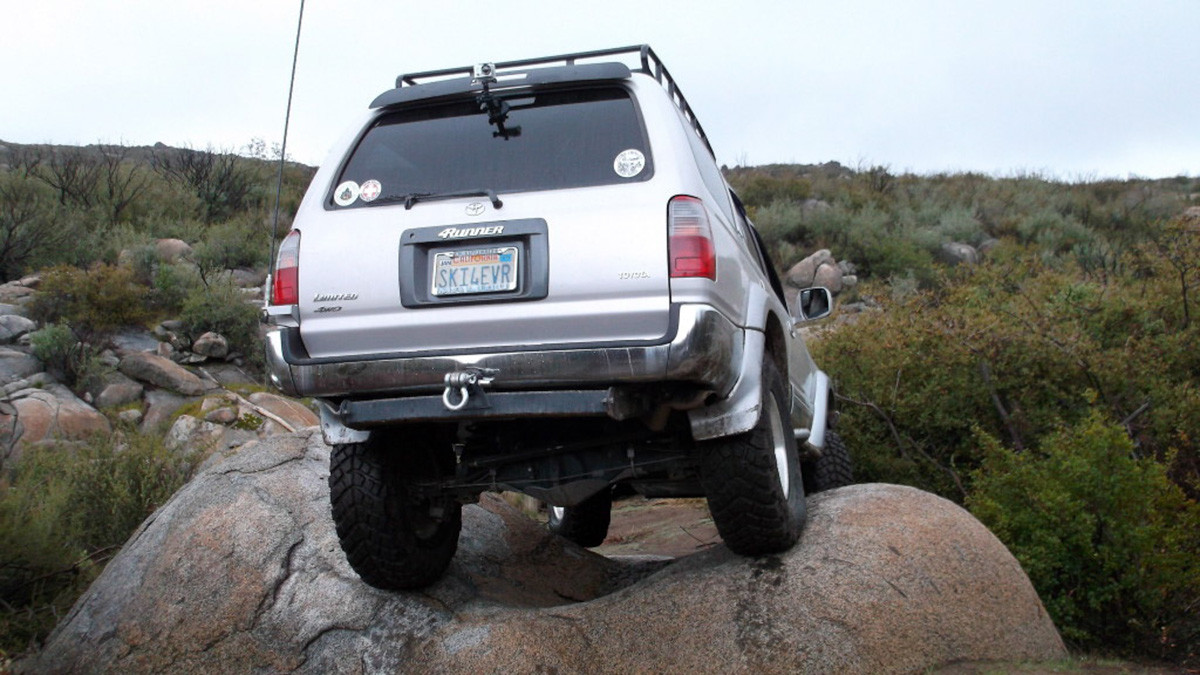

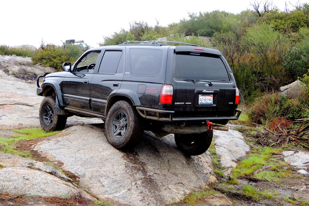

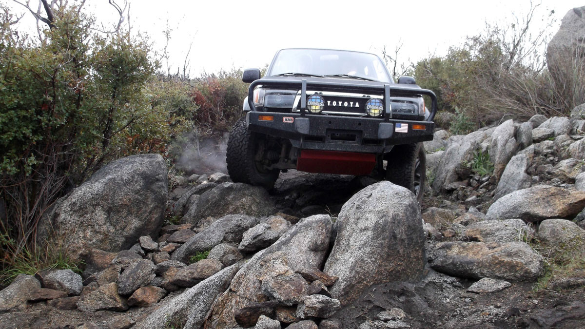

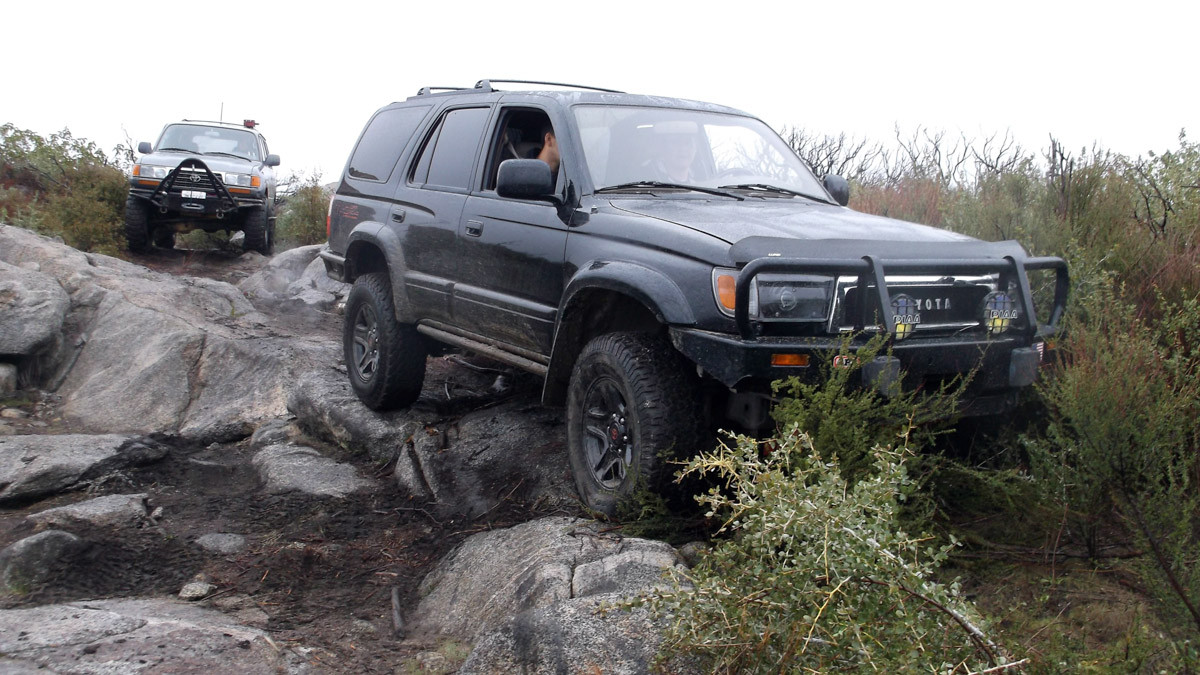

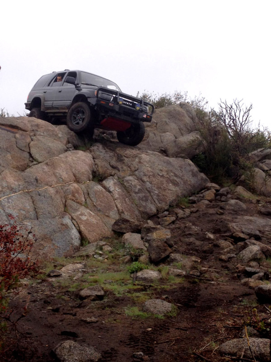

1) I went out to Coral Canyon just east of San Diego.
Great bunch of guys. Pretty strong trails though. We had 1 rig down due to blown transfer & locker, another out due to lack of ability (my buddy's 88 Tacoma) and plenty of paint and wheel damage to go around.
A couple of things:
* 33s would have been better than 31.5s LoL.
* Great news .. my eLocker works perfectly. It turns out it is only the sensor which normally makes the light switch from flashing to solid that is bad.
* Put a couple of good dents in my aluminum skid plate but it held up pretty well. If I do more of this rock crawling I will need to switch back to steel.
* WOW armor is a must for these trails. At least a front bumper and sliders.
Here is an awesome video created by one of the guys from Como Chingas Off Road group @ fjcforums.com
See my truck (with tiny 31.5" tires lol) at 2:25 & more in the Video.

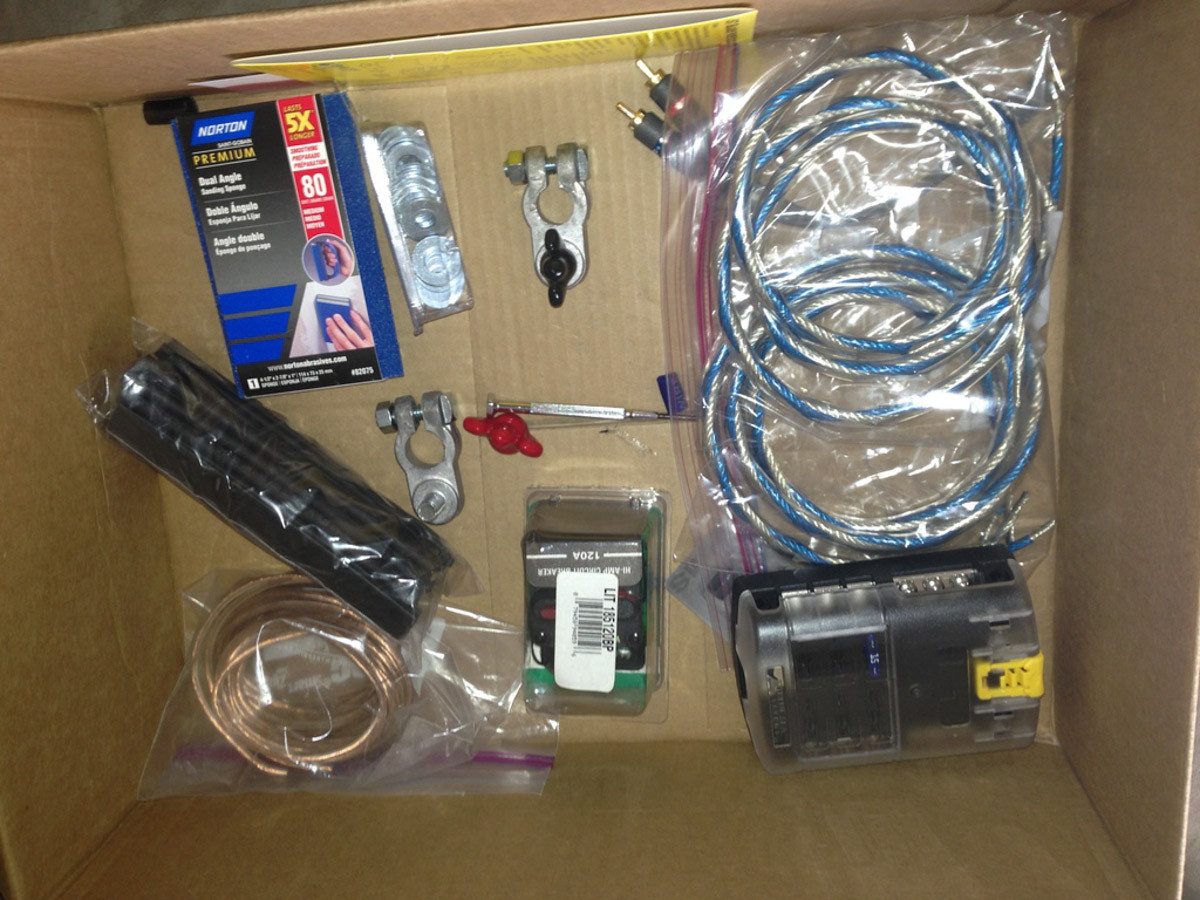

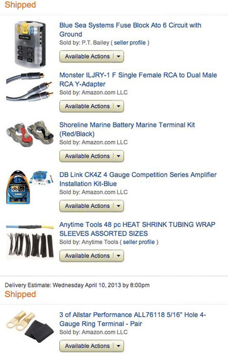

I'm finally going to be doing the Big-3 Upgrade. I bought the parts on Amazon and should have a chance to do it this Saturday. While I'm at it I will add a fuse box to the engine bay to handle all my electronics.
Install Pics coming Soon:
* Blue Sea Systems Fuse Block Ato 6 Circuit with Ground
* Monster ILJRY-1 F Single Female RCA to Dual Male RCA Y-Adapter
* Shoreline Marine Battery Marine Terminal Kit (Red/Black)
* DB Link CK4Z 4 Gauge Competition Series Amplifier Installation Kit-Blue
* Anytime Tools 48 pc HEAT SHRINK TUBING WRAP SLEEVES ASSORTED SIZES
* 3 of Allstar Performance ALL76118 5/16" Hole 4-Gauge Ring Terminal - Pair

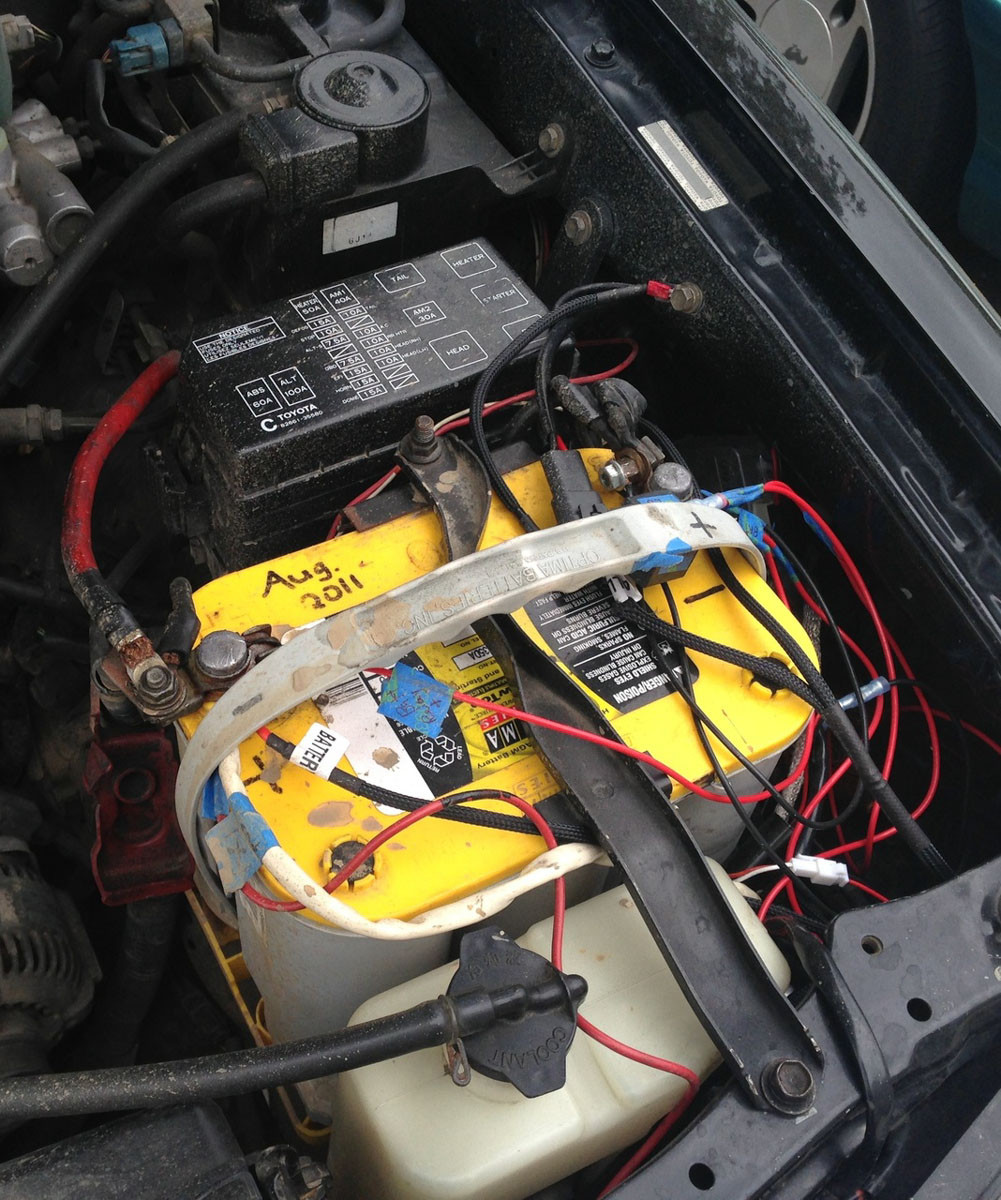

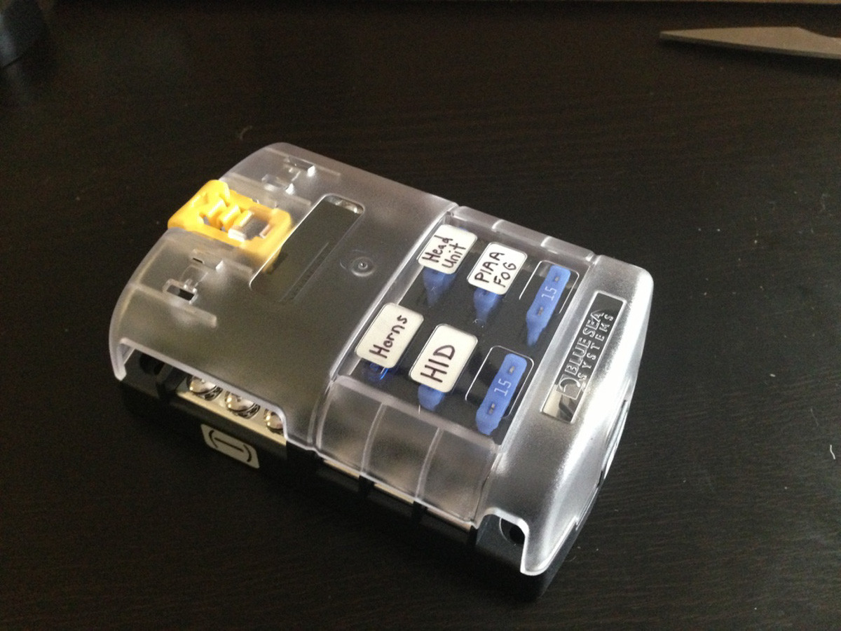

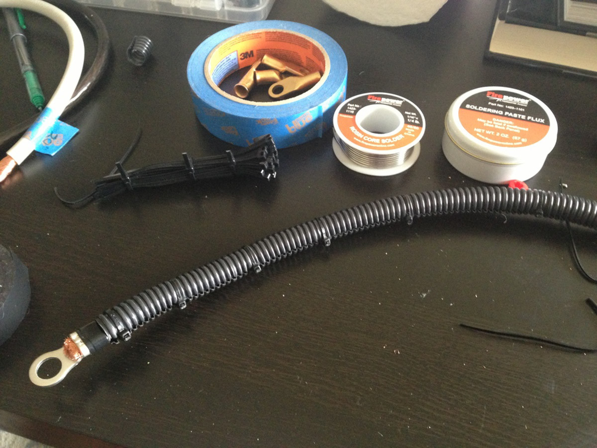

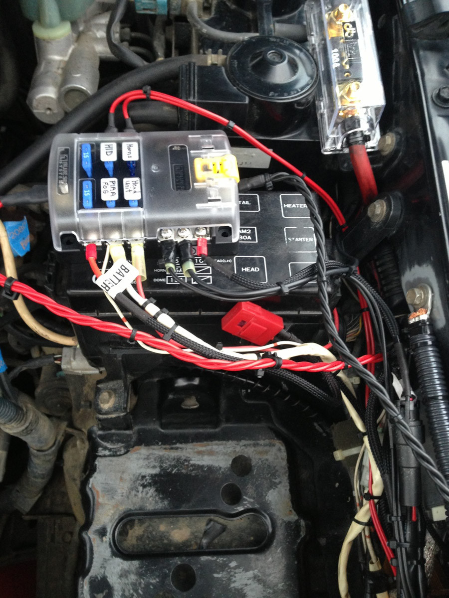

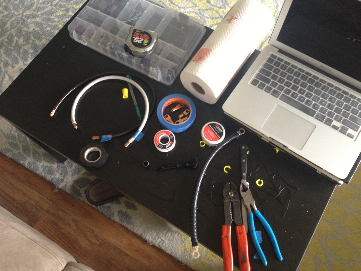

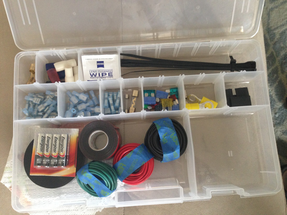

This past Saturday I started working on the Big Three upgrade as well installing a new fuse box for all the electronics I've accumulated over the years.
Installing the fuse box made a huge difference in cable management plus safety.
As you can see from the first picture, the area around my battery was a total mess of wires. I still cringe just looking at the pictures.
Pictures - Setup & Tools
// So ends part 1. I will install the final 2 cables tomorrow and post pics. //

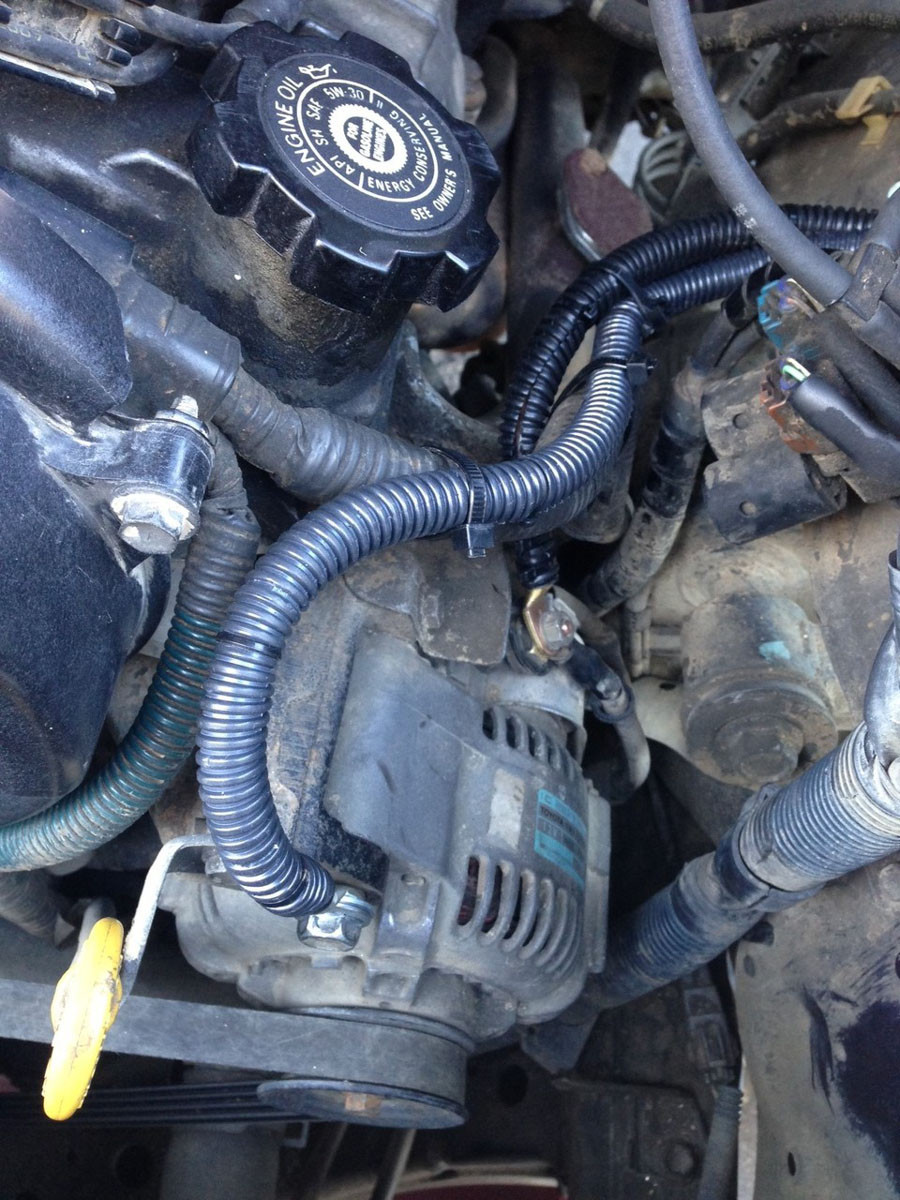

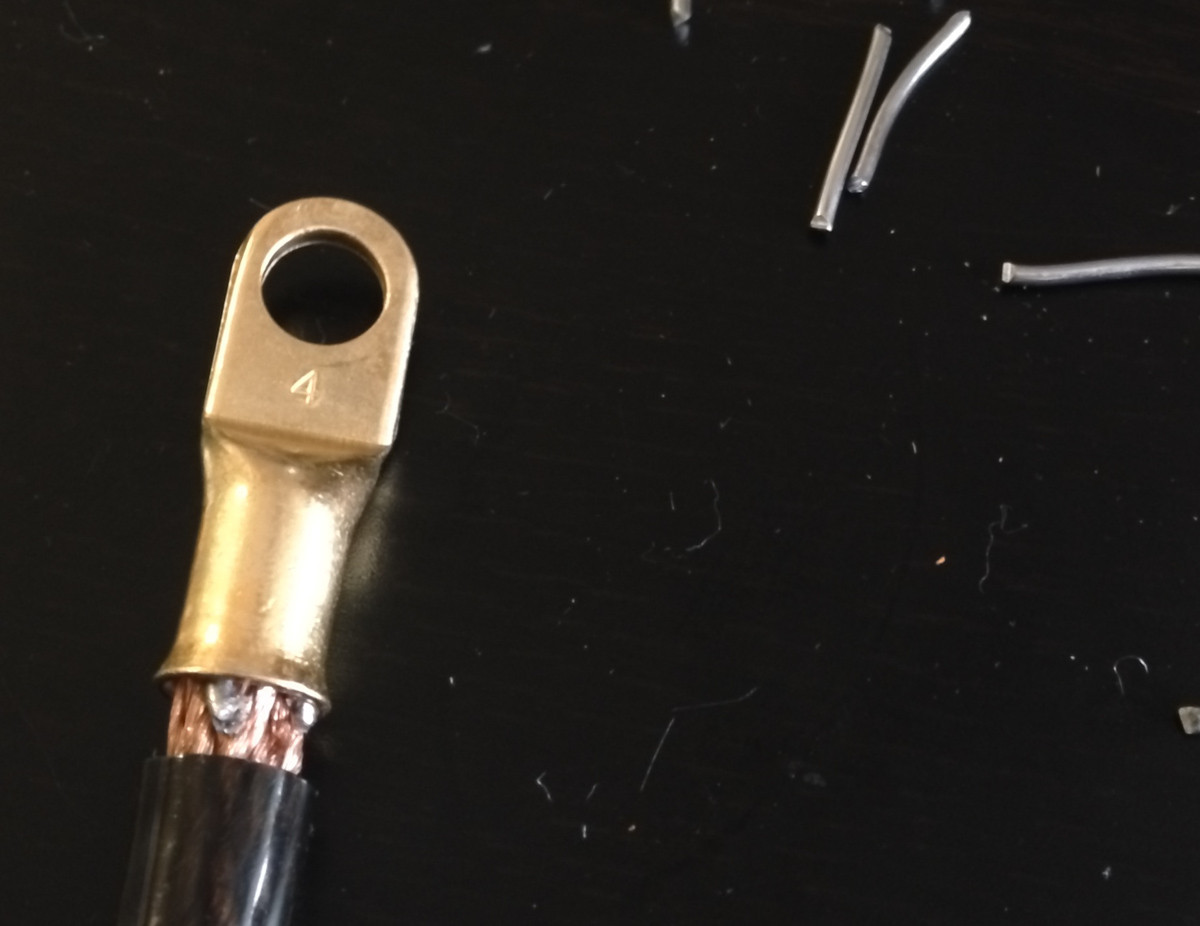

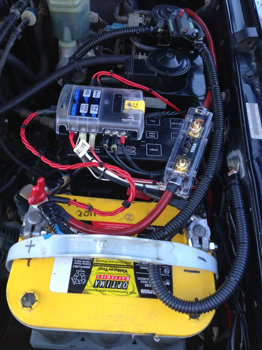

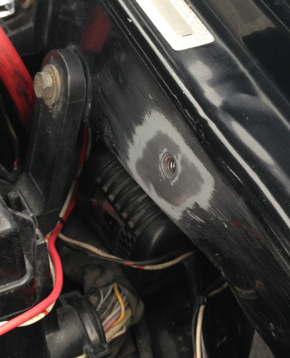

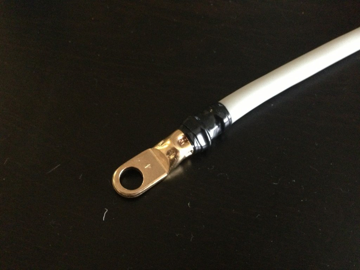

Finished up the Big Three Upgrade today.
All I had left was connecting the 4g wires however I needed to change out a few of my end terminals. I had originally bought 5/16 and needed 3/8. A quick trip to West Marine and I had everything I needed.
* New connections on the alternator
* Overview of the engine bay featuring my new fuse block, new audio fuse, and new wires
The voltage results are in ... at idle it now ranges from 13.8v to 14.2v (tested using a $9 tool I bought on Amazon).
Before this upgrade I would barely get 13.0v when at idle.
:bump2:
Nice job Brian. Looks great. That "clean up" of the bird's nest at the battery was direly needed.
