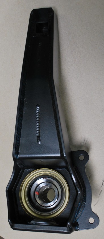

My drivers side Knuckle / Hub broke where it meets the upper ball joint. The Toyota part failed. I’m not sure what happened. It could have been stress fractures, metal fatigue, hitting a rock that was too large etc. It just happened.

That sucks. I did the same thing last summer. I had the Total Chaos gussets welded on mine to prevent it from happening again.

Hey man thanks for the offer. That's great. The shop already found a used one for $100 that they are getting for me. James said he though he had one in the back for $40 but it turned out to be passenger side so they had to go get one from a scraper.
