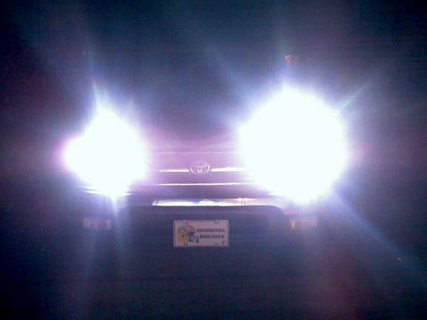

Okay what the heck are squirrel finders???
squirrels......were outside the window as the lady realtor showed me up the stairs to the master bedroom where she began to.....oops. wrong mag..
I have no idea what squirrel finders are:hello:
Squirrel finders are the square block of light above the cut off line on projectors. HID projectors do not have this as it creates glare, also HID projectors have an extremely sharp cut off line. Halogen projectors have the squirrel finders to allow light to escape the cut off line to better illuminate overhead road signs. Because Halogens are not anywhere close to the brightness and intensity of HIDs squirrel finders are acceptable, with HIDs it's mad glare.

I know for sure that 4gen Runner headlights are weak as hell, therefore it has to be alignment problem in your case.
Damn dude! I'd be flashing you too. Those are way too bright where they shouldn't be. They can easily lead to an accident.
hell yea, too much glare! never put HID into reflector housing, and that seems like 6000k or 8000k, another "no-no"
