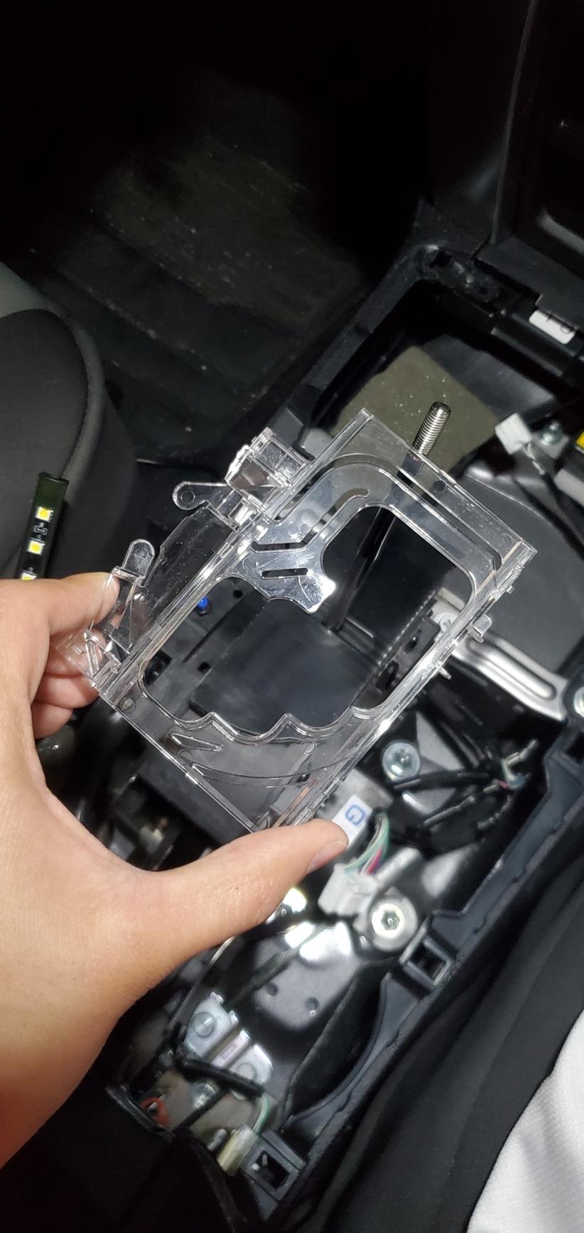

Here is a quick tip/mod I just thought of when thinking of another mod and had all the pieces removed. All the details have not been finalized but this should give you a good idea on what to do. Here are some pics that will give you a good idea of the process
You can keep or remove the plastic depending the type of lights you use.

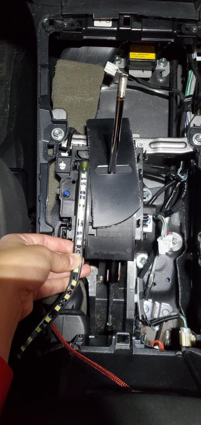

Idea of where to place lights. In my case I will be using strip lights (without the plastic covering)

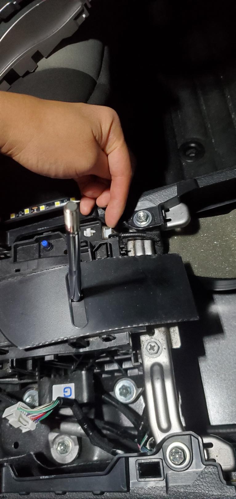

Where to get power from. Only 2 wires. Green was power and white was ground. The way I will wire this is the factory bulb will no longer be in use.

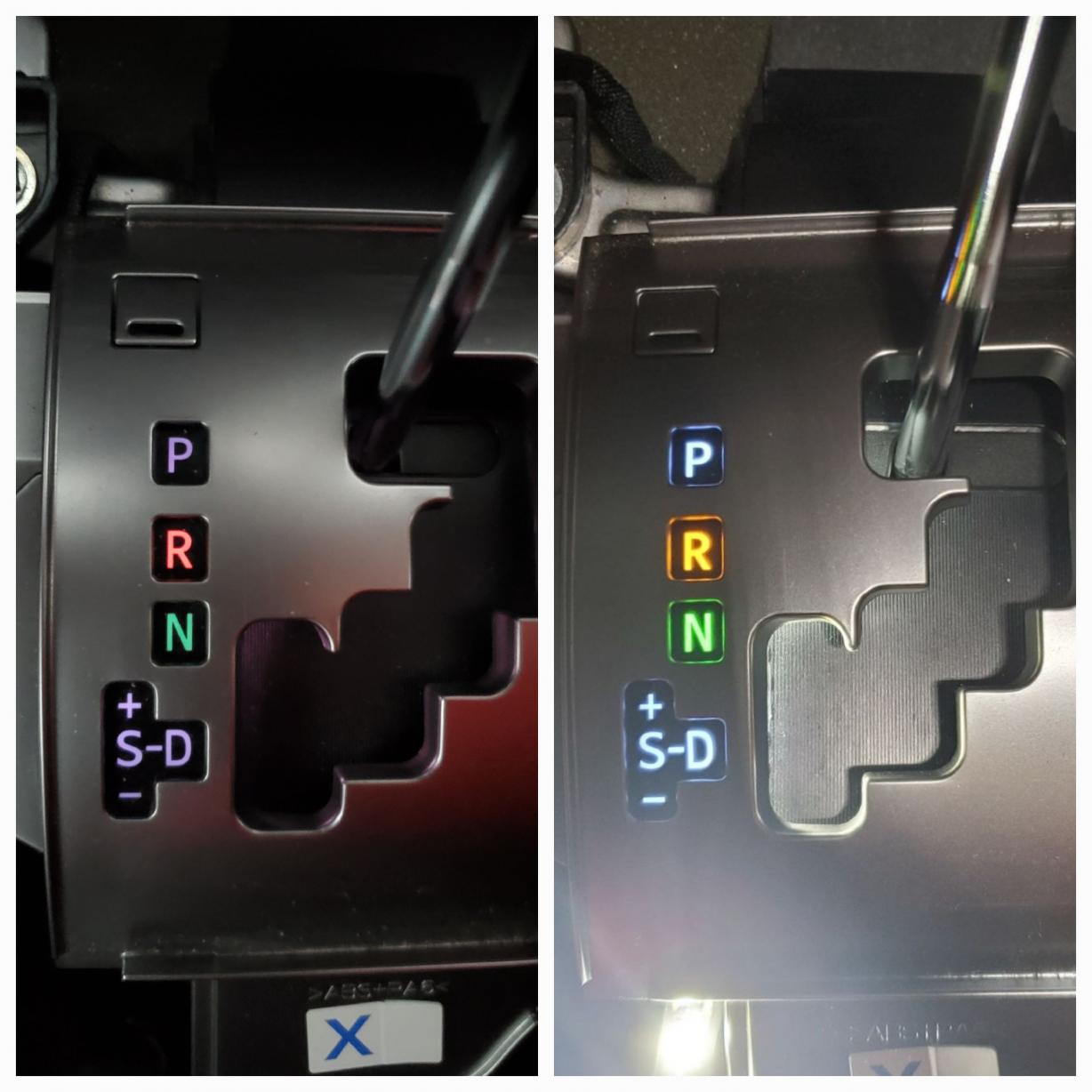

Here is the end result with a before and after. A lot more crisp and bright. I did this during the day so the difference would be a lot more noticeable at night.
Enjoy!
