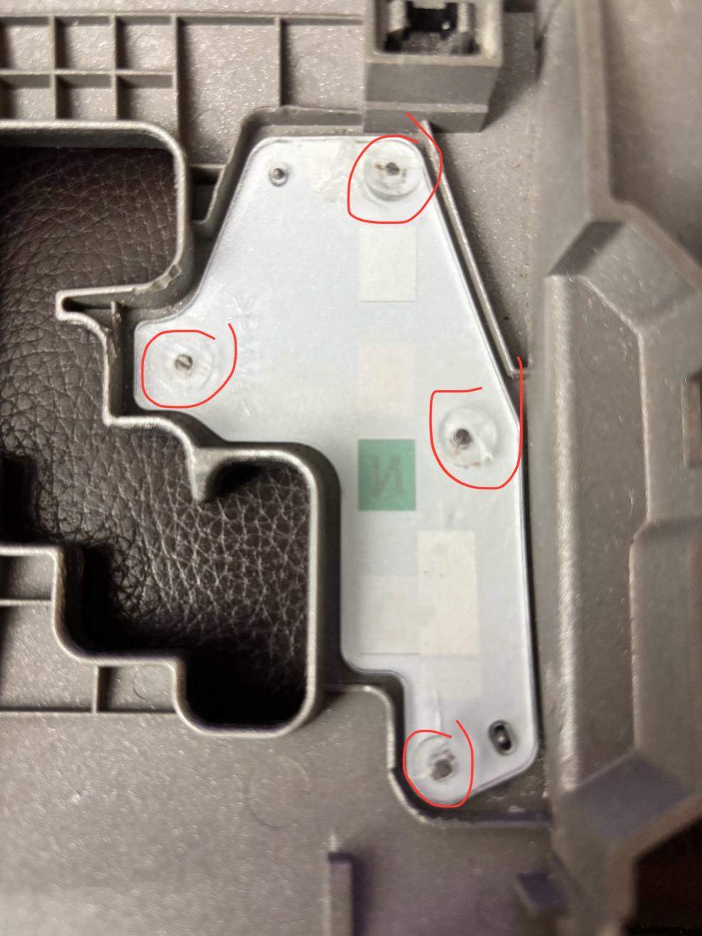

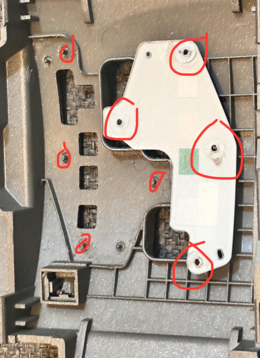

I tried to find the areas you had to dremel but couldn’t identify in the pictures. Can you add some arrows or something?
Looks great!
Sure thing @ Bmnorm2
The 4 posts I circles on the left poke through the gear indicator piece in each of the places I circled on the right, which holds the piece on the right solidly in place. The other 2 posts on the left that I didn’t circle go through the holes on the right and act as guides for placement during the assembly process. Imagine a dollop of glue (which was actually the same grey plastic) being placed into the 4 holes, each slightly larger than their corresponding holes, and they looked like a tiny little button on top of each hole.
Once those little button tops were dremeled off the piece can pop right out. The second pic shows the piece back in place
Does that help clarify it?
