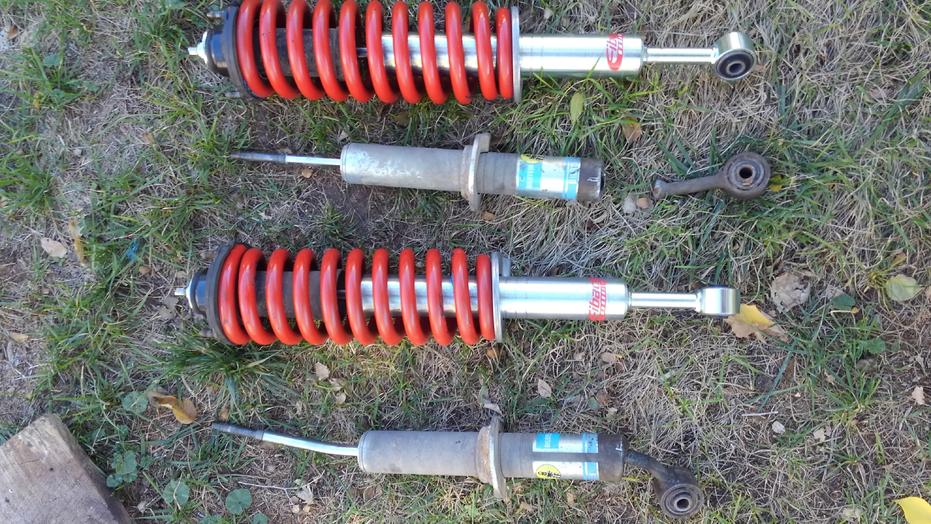

I'm sure you'd be fine with highway driving on them. Might as well just go with DayStar if you're not planning on wheeling it. I won't buy Bilstein's again for my application because I use it off-road and it broke once. I don't think all of their products are bad, but I'm not big on repeating a failed approach. I picked up a pair of the height-adjustable Eibach shocks from snowrunner. Even if they're not better, they are different!

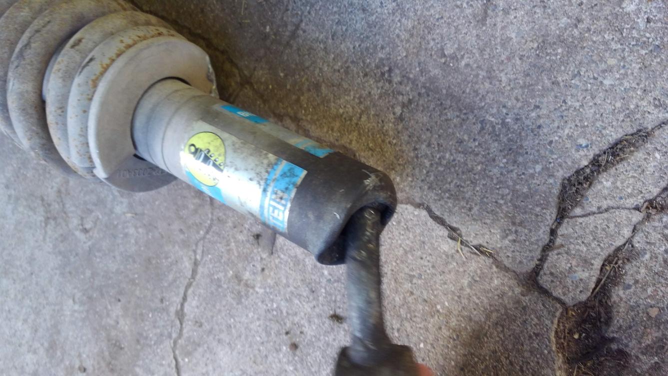

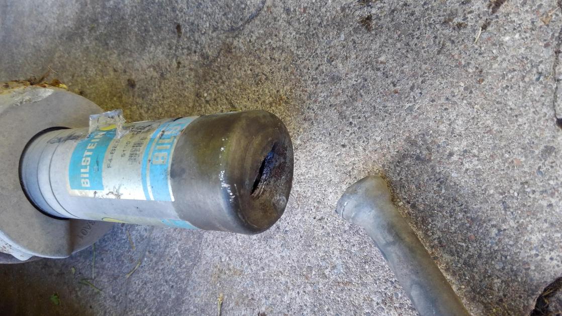

Okay - here's what they look like disassembled. Pretty ugly. Thank you [MENTION=21950]sn0wrunner[/MENTION] for bringing up the sparkly new Eibach's. Installing this weekend to be done with the stock car/drag racer look.

Glad to see you can get it back on the road. I'd definitely look into the Wheeler's Superbumps. The factory bumpstops are too small and don't do enough to slow down a hard hit so the coilover bottoms out, which can cause what you experienced.
I have 5100's with Tacoma springs at 1.75 which yields around 3.25" of lift so way more stress than your set up. No issues after 20K plus miles and trips to Death Valley, Moab, Sierras. Something doesn't seem right about this failure.
Like the spring perches were over-sized.

Wow!!! Those are pretty much the most F'd struts I've ever seen... I'm saving those photos as examples.
