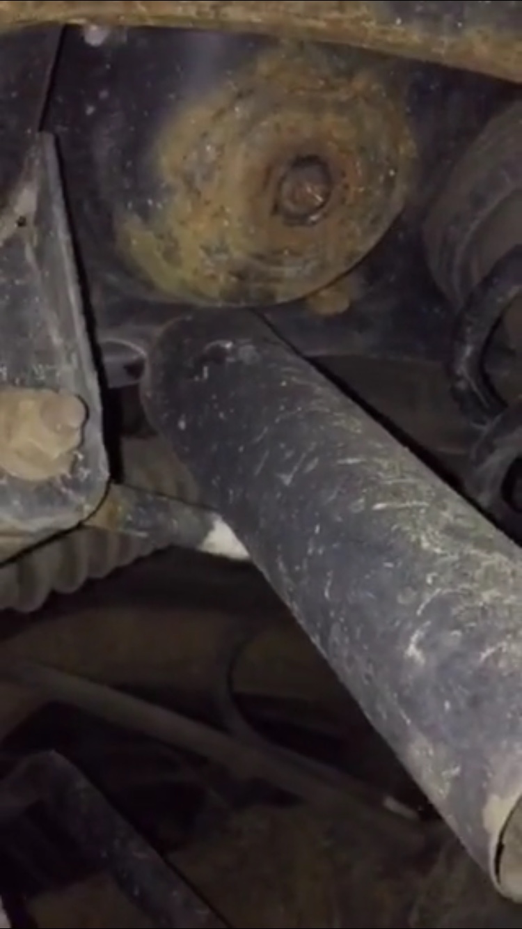

Hey guys... I was hearing a loud clunking noise and found out I have a broken strut and the thing is completely out of the top hole and hitting the frame everutime I hit a bump... I just want to know how hard it is to remove and replace struts!? I am going to lift the truck very soon and was wondering if I can do it myself. I looked at the top of the strut and was confused as to how it is held on..? I have no clue how to get to the top mount so any advice would would be appreciated! I have a 2000 sr5 btw
Thats a rear shock and it loojs lime it rusted away. I hope the rest of the under side is not as bad. Pretty easy to reaplace the rears.
The under side is just mostly surface rust. Until I saw this I couldn't find anything that was rusted off or damaged... Thanks for your input and I was just wondering what the top of the strut looked like and how you would install??

Its NOT a STRUT! is a shock absorber. A strut is on the front of the 3rd gen, it has the coil wrapped around it.
and its just a stud with a nut on the other side, most of the time the nut is impossible to get off the stud so you have to use this....

I cant imagine that the nut will be hard to remove at all since it's not attached to anything, try with a screwdriver and hitting it from the bottom.
