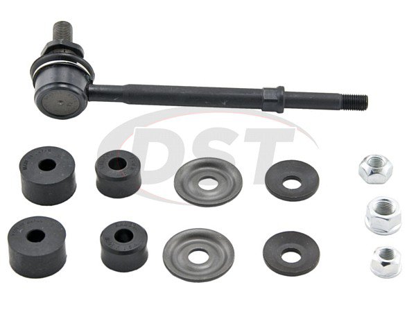

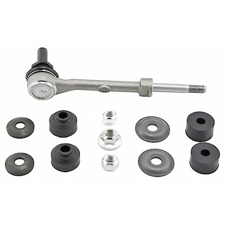

If anyone is looking for a stronger stock replacement thats not priced to crazy you can get the 1999-2006 Tundra links from Moog. Not sure on part number just try to find the cast version at part store. Member pointed out the part # I posted was not cast. Parts store want around $50 each but you can get them from rock auto for around $27 each if you find correct part #. They are a cast design instead of the spot welded design. They are 1/4" shorter but still work with lift. Disconnected they wont hold up travel. I have also found that stock rubber bushings will give more play and less chance of breakage from binding up like Poly bushings can.
Here are some pictures comparing the design difference.

If anyone is looking for a stronger stock replacement thats not priced to crazy you can get the 1999-2006 Tundra links from Moog. Part # K90680. Parts store want around $50 each but you can get them from rock auto for around $27 each. They are a cast design instead of the spot welded design. I have also found that stock rubber bushings will give more play and less chance of breakage from binding up like Poly bushings can.

Thanks for the alternate part! Are you sure it's a direct fitment? The Tundra joint looks shorter.
Just did some quick Googling and it seems the K90680 (Tundra) is actually 1/4" shorter than the K90681 (4Runner), which is not preferable if you are lifted. Also, from this user's pictures it looks like the K90680 is a welded design and not cast as per some of the stock photos.
https://www.tundras.com/threads/broken-sway-bar-links-moog-k90680-vs-k90681-replacement.4455/
That difference in length won't be much of an issue up front. They picture you posted is the economy. At the parts store it was a cast design. Maybe I got the wrong part #. Thought that was the right one.
