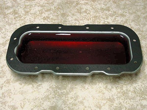

Check the condition of your transmission fluid.
If it doesn't look like this, you have a problem
It was checked a ~ 4 of months ago, I'll check again tomorrow. What am I looking for?
You are looking for coolant in your trans fluid. The trans fluid is cooled in the radiator and sometimes the tube with trans fluid in it (surrounded by coolant) corrodes through allowing the trans fluid and coolant to mix. It looks like a strawberry milkshake kind of. You mentioned the coolant had a new smell. Is it anything like trans fluid smell?
I checked the trans fluid and it looks fine... I don't think the coolant smells like trans fluid, I'm not how to explain it; kind of burnt - fishy.
